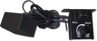

I wonder if it's possible to install this using the standard rheostat location and knob? It looks like their controller has an on/off switch. Why would you need that?
Mike, it looks to me to be a switch to change color from blue to green. And the brightness rheostat.

Right on Chris, the switch changes the oscilation frequency, changing the color and the rheostat adjusts the brightness
