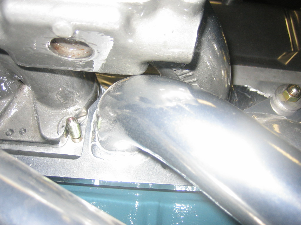

anyone else had this issue with their MSA header? No# 2 exhaust pipe is hitting the bottom of the intake. To match up the gasket ,I need another 1/4 inch too. I sent them pics to see what they say.

I figured I should put a conclusion to this header story. As you can tell from the date this has dragged on a bit. At first I complained about the fitment issue to a rep. at MSA and I sent along the pictures. Although I recieved friendly service it was not good service for the fact that I had to continually follow up with different reps to get any resolve to my complaint.No one seem to have a good handle on what was going on and things seemed disorganized at MSA.
I was told that I was the only one that had this issue:surprised . Well the header got sent back to MSA after some more confusion. It was concluded that yes, the header hit the manifold like I said:rolleyes: I was sent a new header that was made differently with a new flange design. The new header flange actually has drilled holes for the studs instead of slots. It looks better and lines up better with the ports but still hits the intake in the same spot. It isn't as bad as the previous header but I still had to grind off a 1/4" or better to get clearance .
At this point I have been dealing with Sal directly on this issue since I have sent some e-mails expressing my disappointment on the way this whole matter has been handled. I have told him that the new header still hits but he says that he tried it on a block with su intakes and it does not hit. So I guess i have a unique set up or something-though it is stock as far as I know.

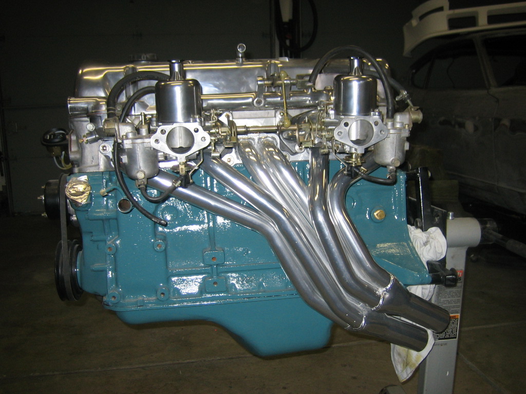

Thanks for the follow up on the MSA headers. I am going to purchase a different brand due to your info. By the way that is an awesome looking engine! Did you polish the valve cover and carbs yourself?
Matt.
Thanks,Yes I did then had parts clear powder coated.
I only started this thread in order educate we members to what the vendors are offering us. I am not picking on MSA , and i waited to post anything till I had exhausted all my customer options with the company. The header is nice and the new flange works well, and if you can deal with grinding on the intake or the fact it isn't a bolt on as advertised then buy it. If you have the early intakes that don't have the coolant bowls on the bottom then you might not have to grind at all.
