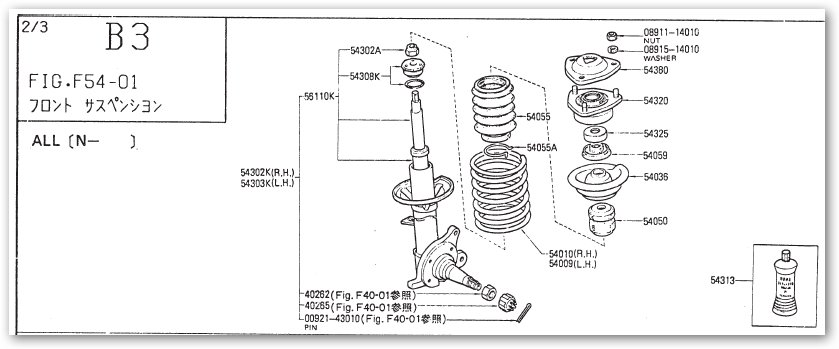

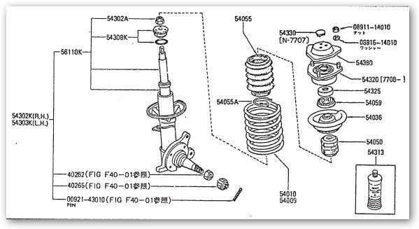

i am assuming that parts 54325,54059 and more importantly 54036 in the following diagram doesn't fit. I checked the part numbers or C210 vs C110 and you are right, the top spring seat is the same part number (54040-21000)
1st diagram is C110, 2nd is C210
