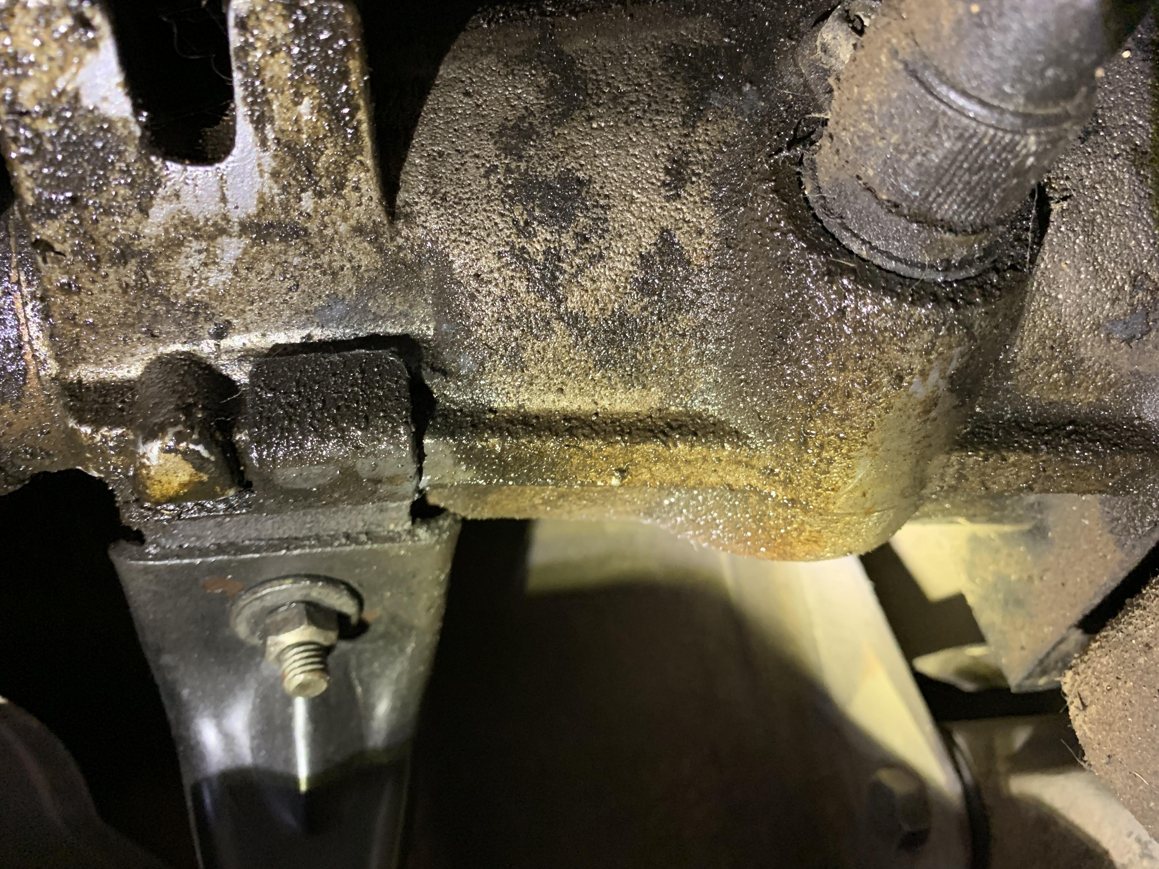

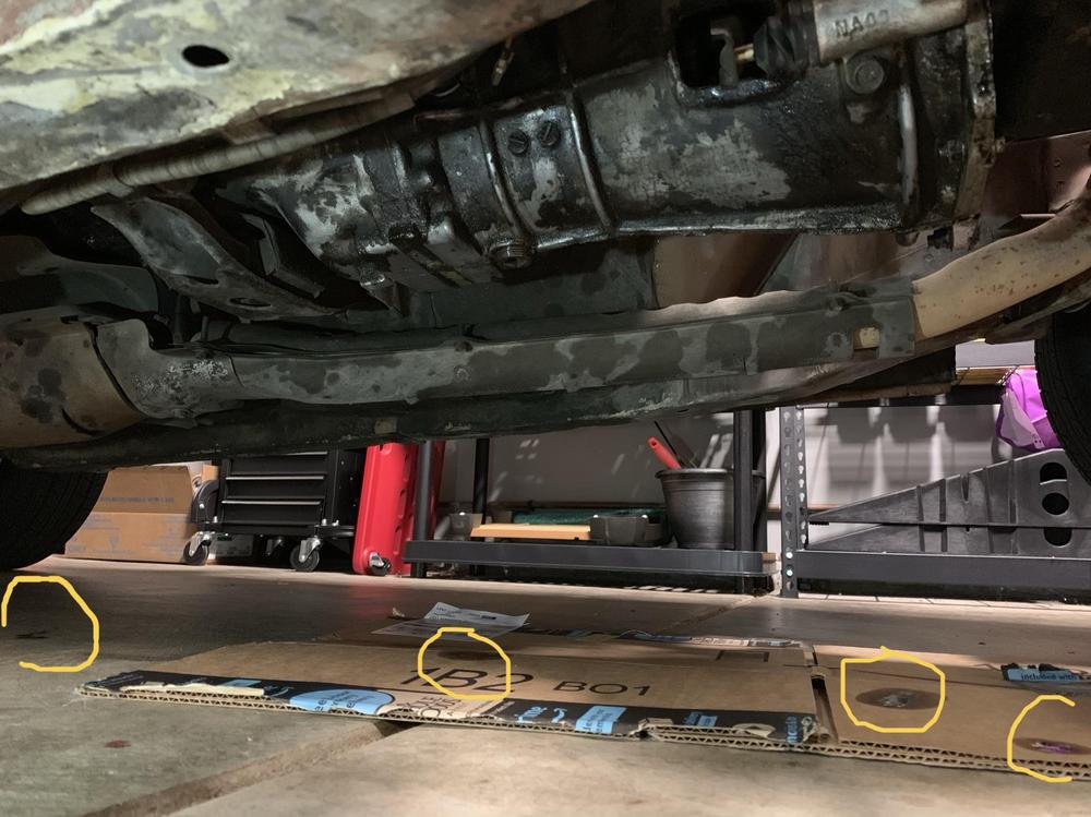

May 15, 20196 yr Author comment_575494 Good morning everyone, I noticed a leak coming from right under where the shift boot is. What is the usual suspect for this leak? Link to comment https://www.classiczcars.com/forums/topic/61849-picking-up-a-1977-280z-6-hours-away-tips/?&page=10#findComment-575494 Share on other sites More sharing options...
May 15, 20196 yr comment_575495 leaks tend to start one place and then seek the lowest point. It could be a transmission leak or and oil leak from the engine working back. Transmissions often leak around the speedo drive. Could also be coming from the top of the trans where the shift lever stabs in. O rings and seals fix both. the speedo is easy to get at, the top transmission leak not so much. IF its engine oil just getting blown back and then leaking its prob from a rear main seal. Is there ANY oil dripping right at the front of the trans bell housing/rear of engine area? Link to comment https://www.classiczcars.com/forums/topic/61849-picking-up-a-1977-280z-6-hours-away-tips/?&page=10#findComment-575495 Share on other sites More sharing options...
May 15, 20196 yr comment_575496 If leaks bother you, the correct fix would be to pull the trans get all the seals replaced (front/back/speed/shift striker rod), while there replace the throw out bearing/clutch/rear main/and rear main bearing cap seal and pan gasket. Bottom line is its going to leak unless those seals have been replaced since new. if that sounds like too much, then clean the area real well with brake cleaner, get it dry, then drive a little and get up real close to narrow down the problem. could be one of the above or several. Edited May 15, 20196 yr by Dave WM Link to comment https://www.classiczcars.com/forums/topic/61849-picking-up-a-1977-280z-6-hours-away-tips/?&page=10#findComment-575496 Share on other sites More sharing options...
May 15, 20196 yr comment_575522 3 hours ago, BayAreaZ650 said: Good morning everyone, I noticed a leak coming from right under where the shift boot is. What is the usual suspect for this leak?  There was just a few posts about this on the forum somewhere. The striker rod seal hardens up/wears out, and leaks, apparently. One possibility. Hard to fix.  Link to comment https://www.classiczcars.com/forums/topic/61849-picking-up-a-1977-280z-6-hours-away-tips/?&page=10#findComment-575522 Share on other sites More sharing options...
May 16, 20196 yr Author comment_575530 4 hours ago, Dave WM said: leaks tend to start one place and then seek the lowest point. It could be a transmission leak or and oil leak from the engine working back. Transmissions often leak around the speedo drive. Could also be coming from the top of the trans where the shift lever stabs in. O rings and seals fix both. the speedo is easy to get at, the top transmission leak not so much. IF its engine oil just getting blown back and then leaking its prob from a rear main seal. Is there ANY oil dripping right at the front of the trans bell housing/rear of engine area? Good call, it's leaking at where the shift lever goes in. Where would be a good place to source the O ring for it? There are a few drops coming from the area where the engine and transmission meets as well. Link to comment https://www.classiczcars.com/forums/topic/61849-picking-up-a-1977-280z-6-hours-away-tips/?&page=10#findComment-575530 Share on other sites More sharing options...

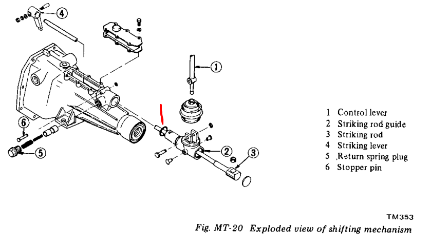

May 16, 20196 yr comment_575541 Looks like the o-ring is still around. Not sure what transmission you have but they're probably all the same one. http://www.carpartsmanual.com/datsun/Z-1969-1978/power-train/transmission-control Here's a spendy one. https://www.amazon.com/Nissan-32857-14600-Cap-O-Ring/dp/B01LY9R00E Link to comment https://www.classiczcars.com/forums/topic/61849-picking-up-a-1977-280z-6-hours-away-tips/?&page=10#findComment-575541 Share on other sites More sharing options...
May 16, 20196 yr comment_575542 1 hour ago, BayAreaZ650 said: There are a few drops coming from the area where the engine and transmission meets as well. Could be engine oil or transmission fluid. Smell it. Both require transmission removal though. Might as well do them both. Might as well replace your throwout bearing while it's out. And the clutch is probably worn. You'll be down by the slave cylinder too. And its hose. The transmission mount is probably worn out. Pilot bushing. Probably have to remove the exhaust system, check the gasket surface. Might break a stud removing the pipe so that could be an issue. If you have to remove the exhaust manifold you'll have the intake manifold off. Might as well replace the injector seals. Don't forget...... Link to comment https://www.classiczcars.com/forums/topic/61849-picking-up-a-1977-280z-6-hours-away-tips/?&page=10#findComment-575542 Share on other sites More sharing options...
