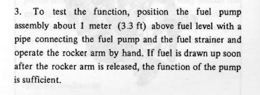

Somewhere out there you might actually be able to get a rebuild kit.  But who rebuilds their fuel pump?  Then you test it.  You can test it first to see how strong it is.
Shoot a little starter fluid in the carbs and get the engine to turn over. It will pump faster and might prime it. It is very hard to prime the mechanical pump off the starter.
