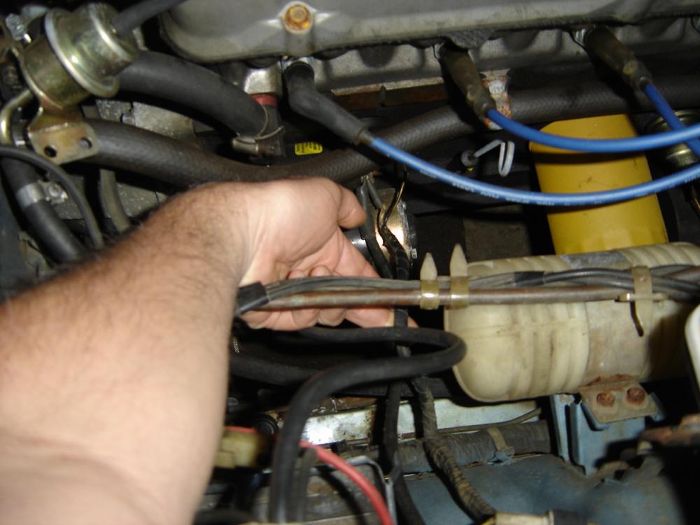

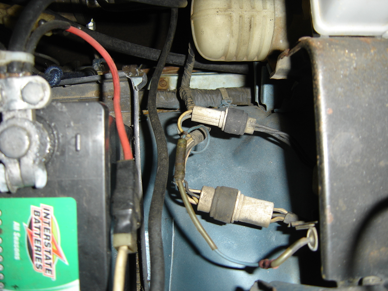

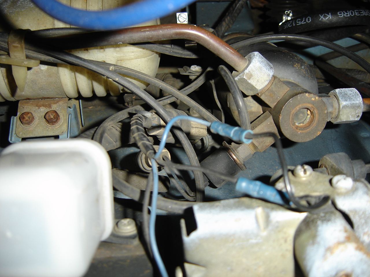

Here are photos of the battery and connections, the back of the alternator and the starter, I can see that I do not have the black small wire with a usable link connected to the starter.
I also have two wires with plugs that I don't know where they connect.  You can see them in the pic of the starter. I don't have any wires I can find to attach to those two?

The black is connected with the red battery lead on the starter.  Then it splits into four wires going to the fusible links on the strut tower.
Okay, so the black wire with the link is attached to the same post as the red from the battery then it's connected to the cluster of wires next to the shock tower...
anyone have pics of which one its connected to?
thanks
On my 280, '77, there's no white plastic plug to the starter wire.  That pictures is a 240Z.
The small wire that goes to the starter's S terminal should be taped together with the black that goes to the fusible links on the strut tower.  There's 4 plugs on mine coming out from under where the voltage regulator is.  two go to the wiring harness and two go to the vacuum solenoids.
