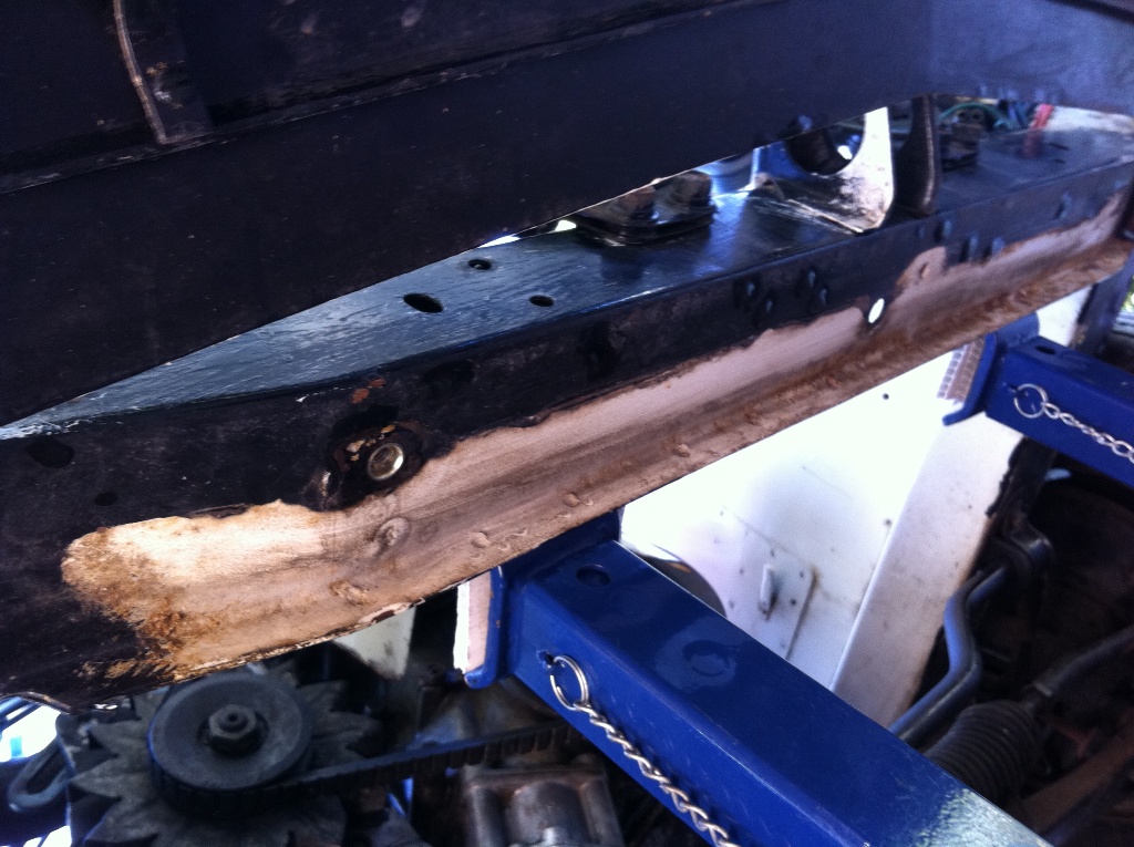

Actually it seems the splash pan was painted by the factory after it was installed. There is black paint from behind the front grille, down the rails, on the sway bar, one engine mount etc. Looks like a real rush job. The pic shows the chassis rail after the pan was removed.

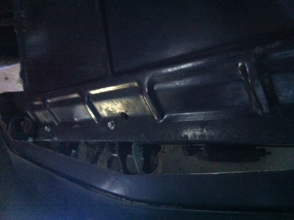

I just get a used splash pan here in Germany. I try to install the pan but it doesn´t fit. It fits on the side rails and on the axle but on the front rail there is gap of about 8cm. Is there anything beetween the pan and the rail on the front side ? Does anyone have a picture of an installed pan?

Does your splash pan have a drain hole in the front right corner? If so, it is for cars produced after 09/74, and wouldn't fit an early 240Z. It was made to accomodate
a radiator that extends lower below radiator support.

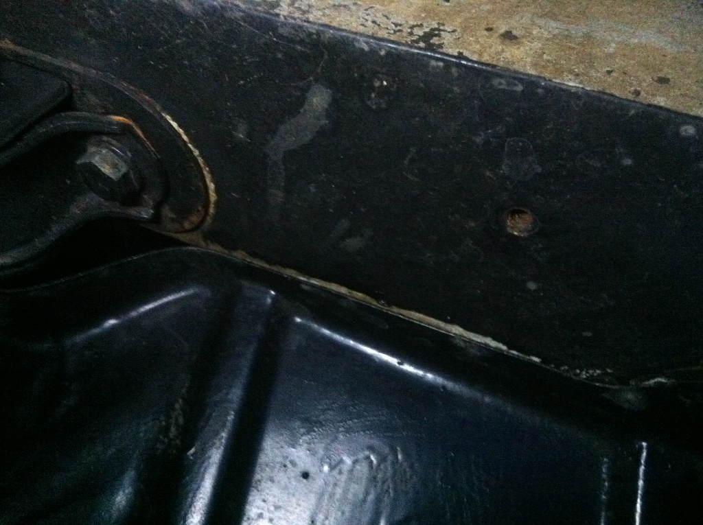

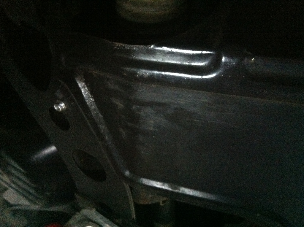

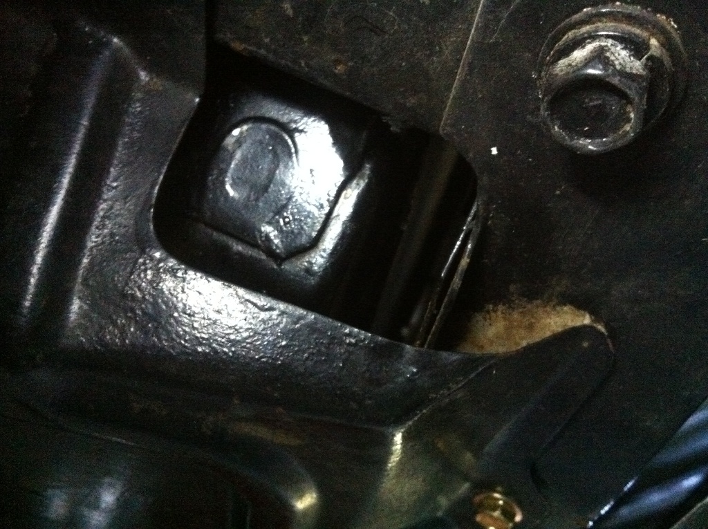

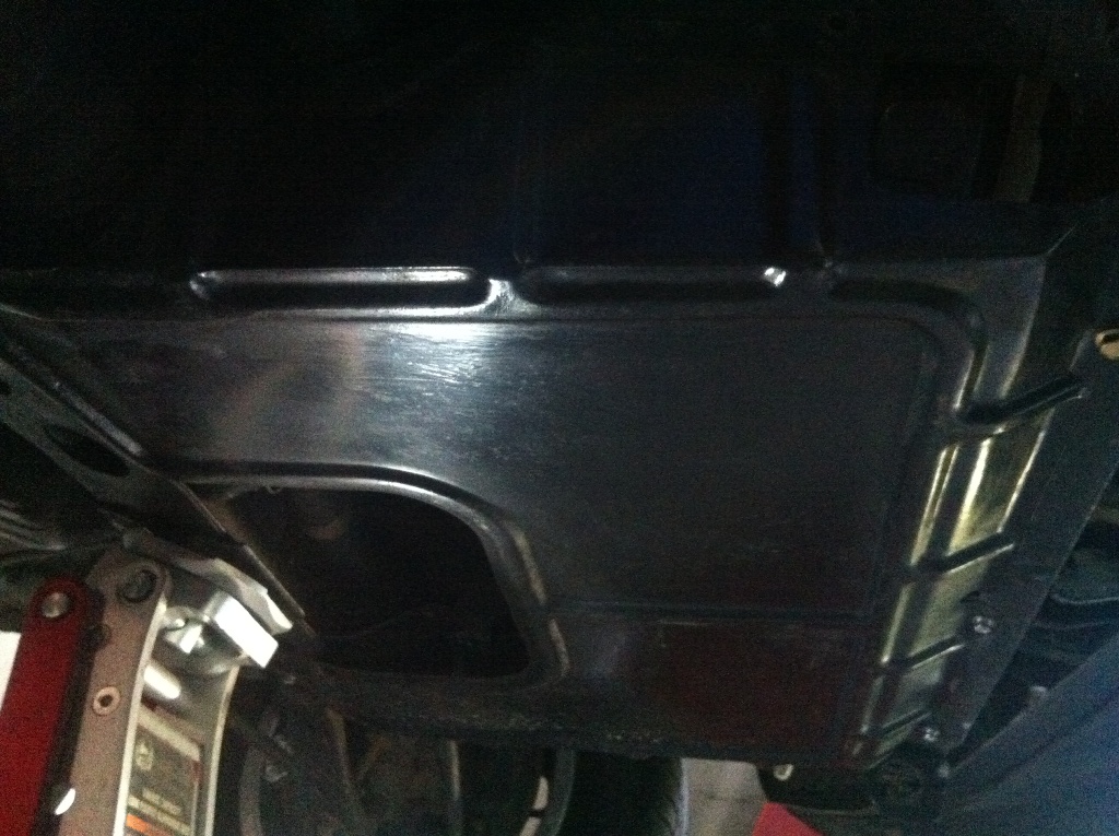

Attached are some pictures of my installed 1970 (no holes) splashpan with the original factory finish as it was bought from the dealer in Australia. I sits hardup to radiator support.
I have recently replaced the splashpan fixings but these were painted over black as well for those who care.
