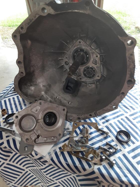

I'm only replacing the front and rear seals as the tranny is otherwise in fine shape. But this also requires replacing the front cover gasket as it was destroyed during disassembly.
A couple of questions:
  1. The front seal was easy as there's a hole in the cover where I could insert a drift pin to drive out the old seal. But there's nothing similar for the rear seal. What's the best way to remove it and not damage the shaft? I don't have any internal hub pullers.
  2. Do I put the gasket on dry or use some kind of sealant on both sides? A PO apparently used some gray RTV silicone as it was all up on the outer races of the main and secondary shaft bearing cages and covered the main bearing snap ring.
Anybody have experience or a reasoned opinion?
Don't lose your countershaft bearing shim. It's very thin, it presses on the countershaft bearing. I think it preloads the bearing so things are right after the aluminum case expands during use. Looks like yours might still be stuck to the cover.
I used non-hardening Hylomar Blue on the front cover gasket. There are other brands available.

Thanks, @Zed Head , I do know the shim is in the front cover. I'll get some Hylomar Blue.
Any advice on pulling that rear seal? Modified slide hammer?
Edited by Seppi72
I removed a couple of them old school style. No issues. There are a number of other seals that are still available from Nissan. Mainly the shifter shaft seal. Also the detent shift ball bearings and speedometer cog seal. All available through Nissan.
If, @Yarb, by "old school," you mean brute force, then that's the way I ended up going too.
I initially cobbled up three hook arms from coat hanger wire and attached them to my 5-pound slide hammer. They didn't have the tensile strength to overcome the press fit friction between the tranny tail housing and the rear seal.
So, I cut away as much inside rubber from the old seal as I could and then used small cold chisel and hammer to gradually cut a groove down through the metal ring of the seal. Once that was done, I hammered one edge of the cut at an inward angle until the metal bent inwards, relieving the press fit at which point the old seal was removable. There are a few nicks on the aluminum tranny housing edge from doing it this way, but nothing that will affect performance.
Some 3-in-1 oil and a 36 mm socket and hammer then made it easy to install the new seal.
Now, @Zed Head, I have another question. I was easily able to use 800 grit paper to remove residual gasket material and pitting on the front cover. But doing the same on the mating surface inside the bell housing is another matter as I can't get a sanding block down in there. I don't want to use a scraper as I won't have angles to prevent gouging the aluminum. Any recommendations?
All you need is anaerobic gasket maker. Permatex 51813. Coat both sides of the gasket and you’re good to go. Remember that seal goes in from the back side of the plate.
To remove the rear seal, just gently tap a medium-sized flat-blade screwdriver between the shaft and the seal, then pry it out. It’s good to be cautious, but I think you may be overthinking it a little.
