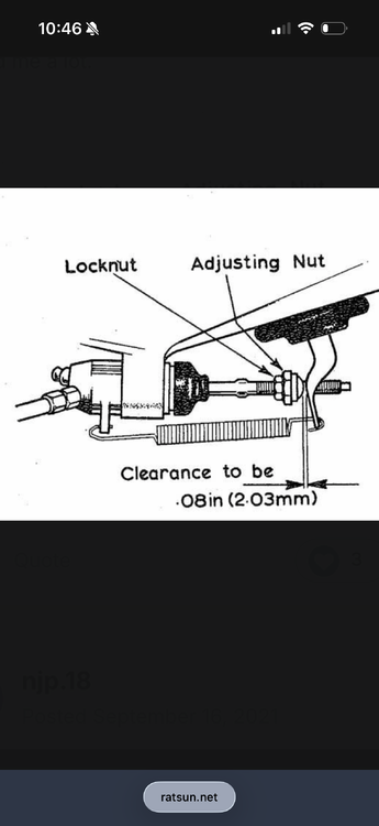

I do still have one more question. When looking at the photo attached it says to leave a 2mm gap between the rod adjusting nut and the fork. I’m a bit confused as wouldn’t the spring take up that gap. Also when I remove the slave cylinder the fork can move a couple inches more towards the front of the car so where is the starting point of the fork for this gap? Sorry that may be confusing.
I know the one that was in there had no gap at all and was pressing on the fork a fair amount. Not any real pressure but was at least taking up all the play.

At the point where you leave the .08 inches the spring is fully relaxed. It will stretch and have tension when the clutch pedal is pressed in.
Ok that makes sense. do I push the fork back (towards the rear of the car) until it has tension and set the rod distance from that point?

This will sound stupid... My clutch issue was the slave had failed like a blown seal so pressing the pedal just pushed brake fluid out of the slave and the pedal just went to the floor. Since the new master and slave (I had the external spring slave to begin with) were the same as what I took out, I just measured the distance on each shaft of the old and then set the new shafts to the same length rather than following your diagram. This did the job and has been good since 2017.
I have always done the adjustment without the spring attached. Remove the slack in the lever by hand, adjust, then reattach the spring
