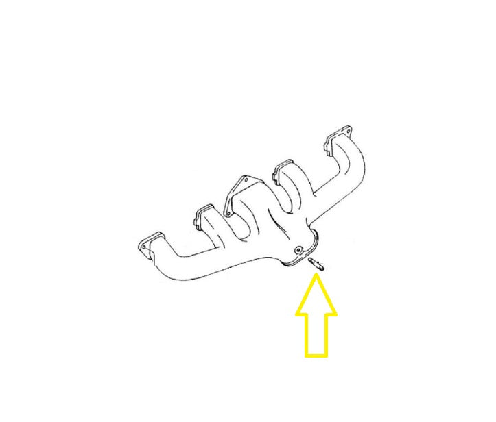

Can someone tell we the dimensions of the 3 studs that connect the exhaust manifold to the exhaust pipe? (1972 Z)

Take the p/n, search for it and dig around. You will find specs.
Actually the part number tells you the length. 08213-82810 The length is 28mm.

I can't imagine thats the total length though. I saw somewhere its an M8x1.25 x 45mm which makes sense, just wanted to pick the brain trust here.
Could be that they changed over the years.
"New OEM genuine Nissan exhaust manifold to exhaust pipe stud. Will fit Datsun 240Z, 1970-73. These are 8mm studs, 38mm overall length.
*Starting around 1974-75 these studs changed to 10mm.  See PT# 800-257."
