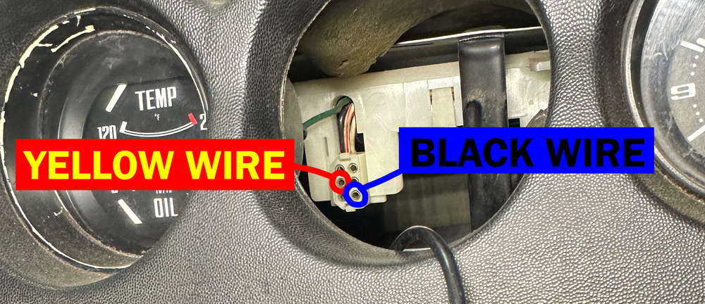

Which brings me to the dash harness. I've attached a picture with the two pins that run the fuel gauge (the mates to the two pins I tested on the gauge harness), yellow wire is the signal from the sender and to my knowledge black is just ground. But when I use the voltmeter things don't seem to behave the way I expect.
These tell me the black wire should be good as a ground:
  • Continuity between black wire and other grounds (cig lighter barrel and HVAC panel frame)
  • +12V between cig lighter positive and black wire
But the yellow wire is where I'm confused
  • Continuity between yellow and black wire. No resistance, multimeter just beeps
  • 75 ohms between yellow wire and other grounds (cig lighter, hvac panel screws)
I'm just spinning in circles. Black wire is just as good a ground as the bare metal frame inside the dash. The yellow wire sends 75 ohm signal to that frame just fine, but when I try to send that signal to the black wire it just beeps with continuity. Any advice where to go from here?

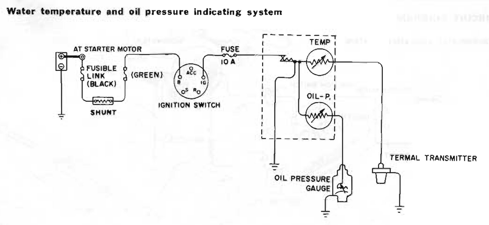

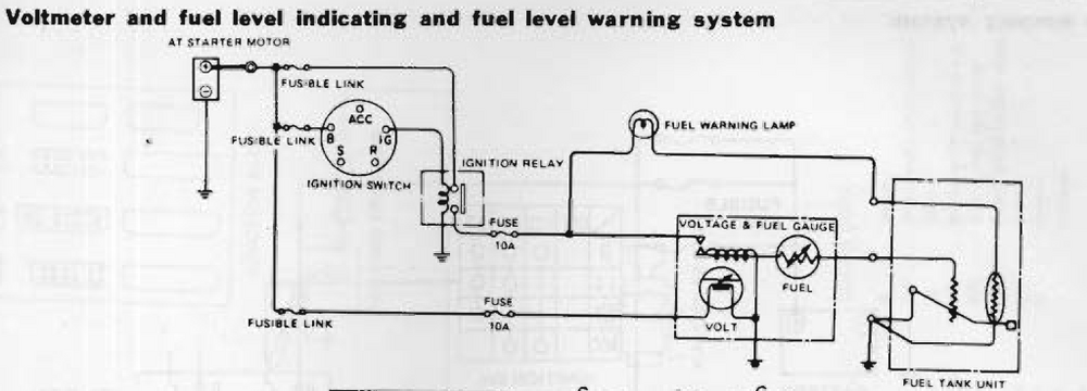

Interesting topic. I've wondered about the "regulator" in the past. I dug around in the FSM, and also read that Ratsun link and think that there might be a problem using that solution with this specific problem. The FSM only shows a regulator being used for the temperature and oil pressure gauge. Not for the fuel and ammeter.
Pulled a few things out to illustrate. Still worth exploring, just not for this problem.
From Ratsun. He's talking about temp/fuel, but that's two different gauges in the Z's.
"You're temp/fuel gauges don't work and you've already checked the output from your fuel/temp sensors to make sure they are not the culprit."
From the 1974 FSM. Looks like three triangles represents the regulator.
The fuel gauge has a heat coil. Seems like that could fail and cause problems. No heat, no needle movement.
Edited by Zed Head
The forum software screwed up my image pasting.

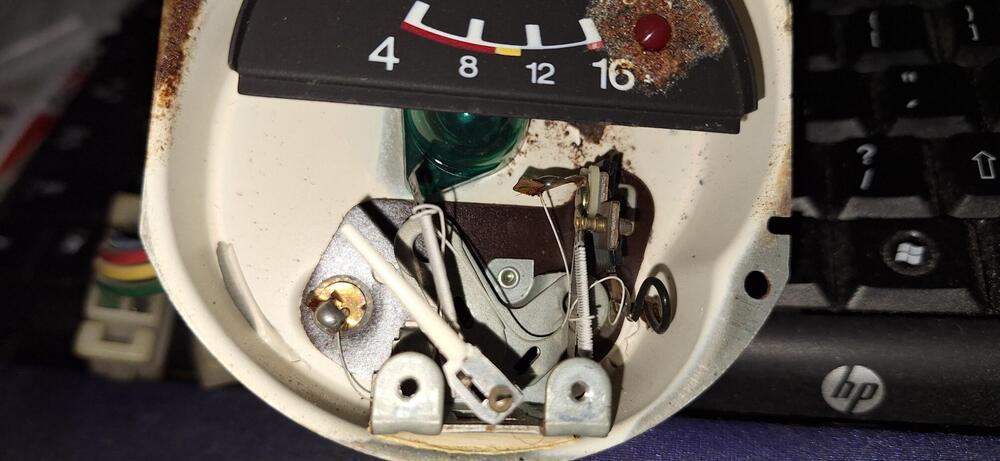

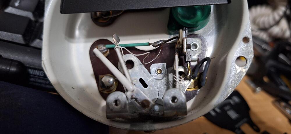

Look again. There is a voltage regulator in the fuel gauge. That's what those videos show.
I didn't watch the videos. I went to the Nissan documents.
You're saying that there is a mistake in the Factory Service Manual? The videos are for the OP's 1974 260Z fuel gauge? Not clear why I should disbelieve the FSM.
I checked 1978 to see if things changed with a voltmeter. The picture is different but the description is the same. It would be odd to edit the FSM and leave an error. But it is possible, of course.
The diagram you posted from the FSM shows a points style voltage regulator aka the bimetal strip. The strip opens the points in a manner similar to the voltage regulator in the charging circuit. Where is the error?
The voltage regulator is on the right side of the fuel gauge.
And it's on the left side of the oil pressure gauge where it is also wired to the temp gauge.
