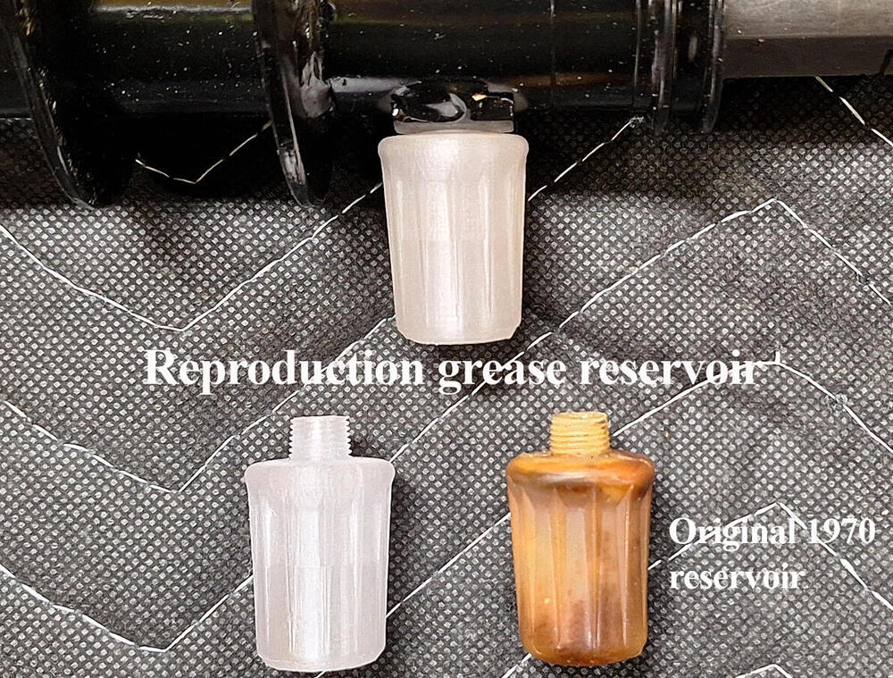

The grease reservoir screws into the steering rack, Part # C4366-0501P (# 25 in the parts diagram). They were used up until July 1973. The originals get brittle and brake off at the thread, none have been available for years.
We modelled up a CAD drawing from an original (brown stained part in the photo) and beefed up the section where the thread connects to the body. They are reproduced in oil/grease/UV resistant plastic and have the original correct JIS pipe thread to screw into the hole in the rack. Have done 50 of them so if anyone needs some let me know by PM.

Just one question; are these reservoirs solid or are they
fabricated to actually hold grease?

The reservoirs are hollow inside like the original, designed to hold grease just like the original. All the bits I have done are fully functional. The metal 3D printed gearknob came out really well, will post a picture next week.

Can the reservoir be changed without effecting the amount of lubrication in the steering rack?

I don't see why not, they just unscrew. The original could be refilled when the grease got low, these do the same.

Has anyone ever studied an original to see if it has a tiny vent hole? I shall certainly go look at the one I have squirreled away.
I have trouble with the concept of a “grease reservoir”. Grease does not circulate around inside the rack, or wheel bearings for that matter. Its high viscosity and immense stickiness makes its job to stay put as a film on metal surfaces. I do not understand how having any grease in this thing is of any help to maintaining grease levels in the rack. Some might get pushed in there initially, but it’s never ever coming back out. Same with putting grease in the wheel bearing dust cap. Other than providing a barrier for dust incursion, it can serve as a reservoir for grease in the bearings. There is no way for it to get there.
Engineering wise, I see some wisdom in providing a vent, and thus maybe a small volume to keep a small vented quantity from getting out to make a mess, but it would have to have a hole to function as a vent. No grease would go in if there was not a way to displace air in the reservoir. And they did abandon these reservoirs on later racks, so they do in fact serve no useful purpose.
Sorry to go off track on the thread. The work of the reproduction is excellent, you should be commended. I love seeing a reservoir on the rack when it’s supposed to be there.
@zKars I had a closer look at my original and can't find a vent hole but I understand what you are saying.
Nissan called this item an 'Oil Reservoir', rather than a "Grease Reservoir".
'Oil' has a little more natural disposition toward moving downhill when subjected to gravity than 'Grease' does.
A clue in the name they chose, perhaps?
Somebody whose opinion I usually take notice of suggested that the originals - when new - were compliant enough to be 'squeezable'.
