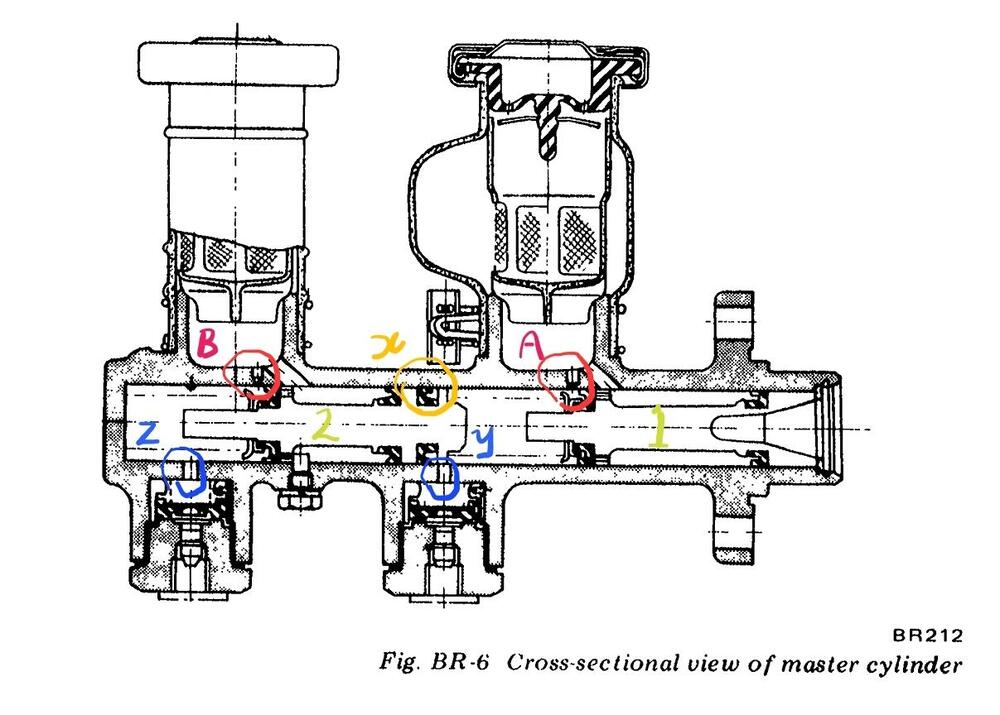

I’m not entirely sure where you’re seeing pressure. Under normal circumstances, there should be no noticeable pressure in the reservoirs. However, there are situations where a small pressure build-up can occur, usually when certain seals begin to fail.
How it works - in a nutshell:
  • When you apply the brakes, piston no. 1 moves forward and passes port A. Once this happens, brake fluid can no longer return to the reservoir, and pressure begins to build. Fluid then flows through port Y to the front calipers, while the pressure also pushes piston no. 2 forward.
Note: Seal X on piston no. 2 prevents fluid from passing from the first (disc brake) chamber into the center section of piston no. 2.
  • As pressure builds in the first chamber, it continues to drive piston no. 2 forward.
  • Piston no. 2 then passes port B, which prevents fluid from escaping back to the reservoir. Fluid now flows through port Z to the rear drum brakes.
At this point, the system is in balance.
Leak scenarios that can cause pressure in the reservoirs
The most likely cause is seal X. If this seal leaks, pressurized fluid from the disc brake chamber can pass into the drum brake reservoir. With each brake application, fluid is transferred from the disc brake reservoir to the drum brake reservoir, causing a gradual pressure build-up. You will also notice the fluid levels in the reservoirs changing.
Another possibility is leakage past the piston no. 1 seal, located directly beneath port A. If this seal leaks, high-pressure fluid from the disc brake chamber can pass back along the piston and enter the reservoir. Because the chamber volume is much larger than the volume around the piston shaft, roughly half of the leaked fluid can end up in the reservoir, creating pressure.
A similar situation can occur with piston no. 2 and seal B.
There’s more going on internally, but this overview should help explain why you’re experiencing what appears to be pressure build-up in the reservoirs.Screenshot_20260117_092639_Adobe Acrobat.jpg

Adding scetch

Wow that’s pretty interesting - one if my seals must have been going but I don’t recall fluid levels changing between the reservoirs. That said, I suppose it’s a good thing I replaced the master even if it was my failed attempt at doing that to fix the leak where the master meets the line at port Y. The brake repairman is making a new metal line for that.

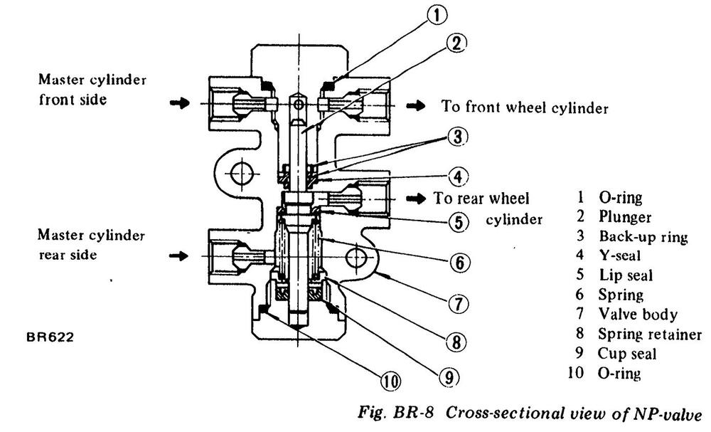

The brake repairman is curious if it could be the proportioning valve,
The leak has to be fixed first. A good shop will know how to do that, and bleed the brakes. Shouldn't really be speculating until those two things happen.
If the rear brake shoes aren't adjusted correctly the piston in the MC can bottom out before the shoes make contact with the drums.
The Datsuns don’t have an excess-flow preventer like the Spitfire, so that won’t be the issue here. If the braking system were hydraulically unbalanced, you should normally get a signal from the brake warning switch. That said, these switches can deteriorate over the years and may no longer operate correctly.
I’d be more inclined to suspect a blockage somewhere in the brake line after the brake switch. This could be in the brake proportioning valve or in the single line running back to the rear axle.

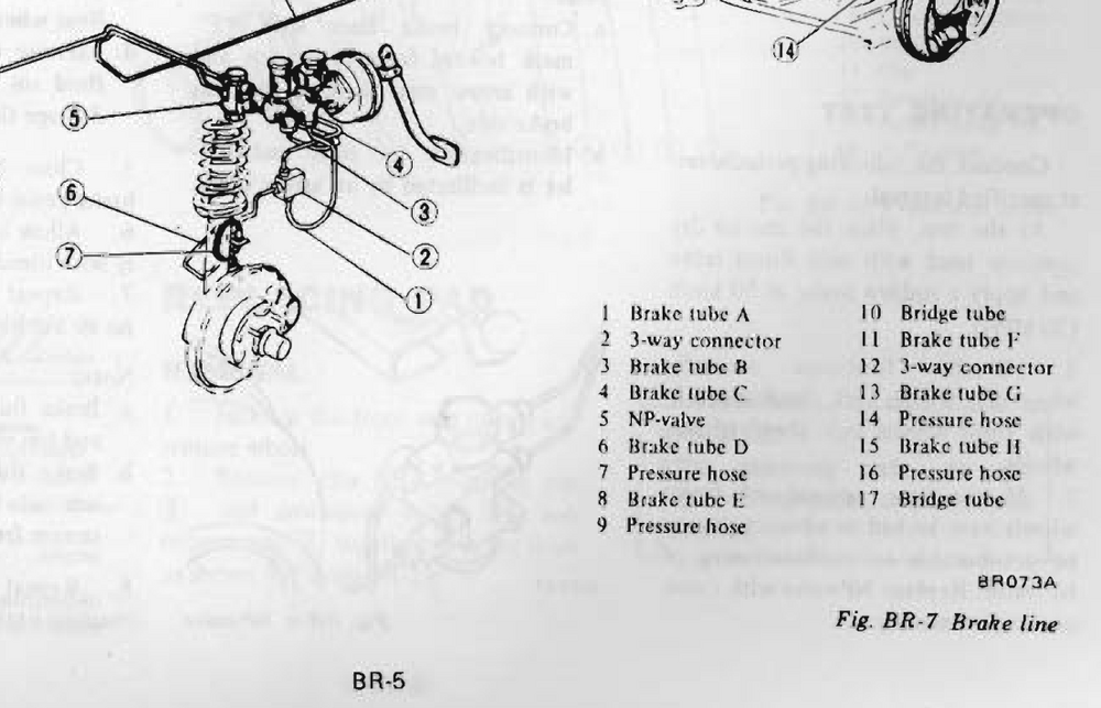

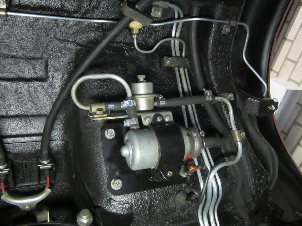

A simple step by step troubleshooting would be to loosen the brake line fittings one by one, starting just after the brake switch and working your way back to the T-piece at the rear axle near the fuel pump.
At some point, when you crack a fitting with the brake pedal applied, no fluid will come out. The blockage will be located between the last fitting where fluid did flow and the fitting where it didn’t.
The photo of the fuel pump is showing the bronze coloured T-piece just above it
