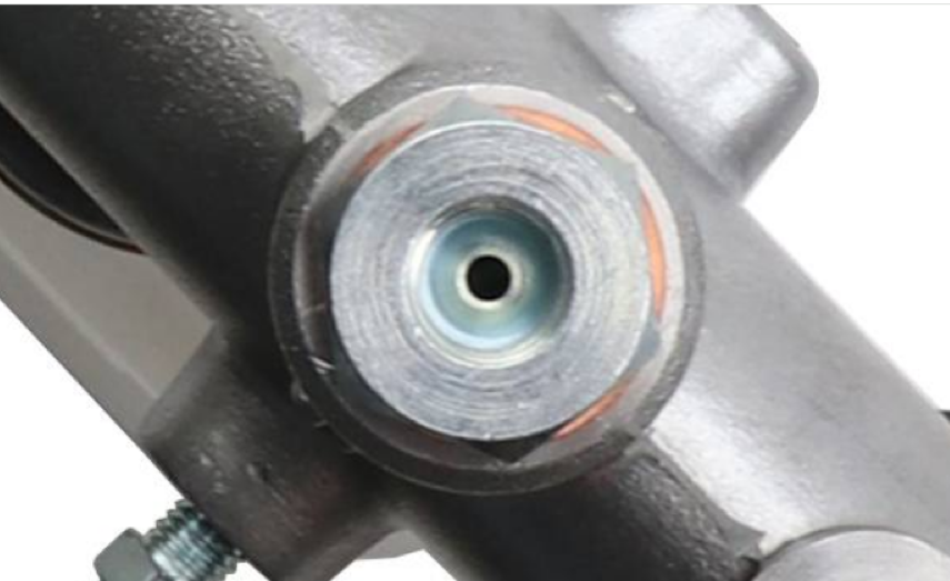

It's also possible that the metal to metal seal of the brake line was damaged when you changed the MC the first time. Pretty common for the tube to twist with the fitting when the fitting is loosened.
The only way to be sure is to examine the parts. A magnifying glass and bright lights help. Take a close look and you'll see where the actual sealing surface is. A spec of foreign matter can screw things up. Something to be aware of if you do change the MC. The threads don't do the sealing, they just do the clamping.
You can see the cone that fits inside the end of the tube in this image from Rockauto. That's the sealing surface.
Interesting. I'll give it a look when I change it out, but it's odd that it started leaking 6 years after being installed if the connection there was originally poor.
