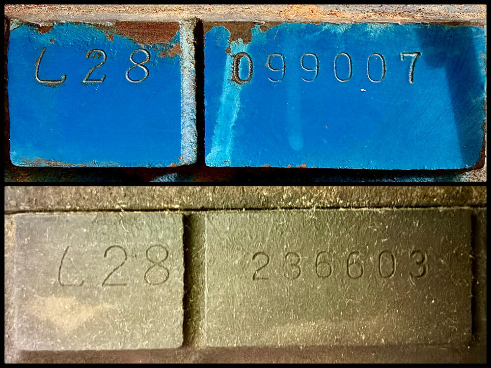

have you looked at the stamp on the side of the block? its looks like this. It can be hard to see, I had to remove something to get my phone in there.

@nowak1981 Here are pics of both the blocks in our possession. The top one (blue) is the one we are pulling; the bottom is the "new" engine we are about to swap in. Both are from later 280Z models.

@Zed Head Yes, I should have been clearer. This 260Z has a later 280Z engine in it already. We are taking that one out and replacing it with another 280Z engine. My main concern is that I plan to bolt the dual-carb intake manifold up to the fuel-injection heads on the "new" engine, and I was basically just hoping a) that will it work with the flange from the intake covering the injector holes which are not present in the carb-intake head; and b) that someone in here could point me to the correct gasket.
