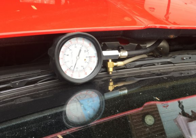

On 1/14/2025 at 5:20 AM, Captain Obvious said:
Are you able to see the fuel pressure gauge WHILE you are driving?
For the time that you're spending on the problem it might be worth the length of hose and the clamps to get that real-time data.

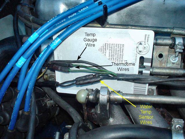

There are many connections on the harness that need addressing. AFM etc. Are you doing the work yourself or having it done. That makes a huge difference in moving forwards as far as cost goes and I truly understand. Looking back and have known what I have learned fighting mine for a very long time I should have done that first. You also have the sub-harness that others were mentioning. Those connections are critical temp wise where the ECU determines the richness. Replaced that harness as well although you can fabricate that yourself as well. All this will give you a peace of mind moving forward. I wish you luck.
Thanks.  All the sensors on the front and their connections are new.  It really doesn't make sense to me that the fuel line blowing can suddenly make a car running great suddenly have an issue with the EFI connectors but stranger things have happened.
Borrowed this from a Corvette forum.
This is a dumb question, but I'm going to ask it anyway.  Wouldn't holding the pedal at 3k in my garage be the same as driving around or does the pump work harder when the car is under load?

These are important. Pull them apart and shine the connections up, maybe some dialectic grease too.
http://www.atlanticz.ca/zclub/techtips/runningrich/bullets.jpg
i snipped those off and soldered on new connectors there a few years back 😞.  it definitely did make a huge difference though.
This is easy to do if you already have a gauge spliced in. I put about 4ft of 5/16 hose between the fitting and the gauge. Unscrewed the gauge from the fitting, put the hose on the fitting with a good clamp, shoved the gauge into the other end of the hose and put on another EFI clamp. Zip tied it to driver's wiper arm and drove around for a day or two. Put the PSI numbers on here.
That's a great idea since that is currently my exact setup.  I'll give that a try this weekend - thanks for that
