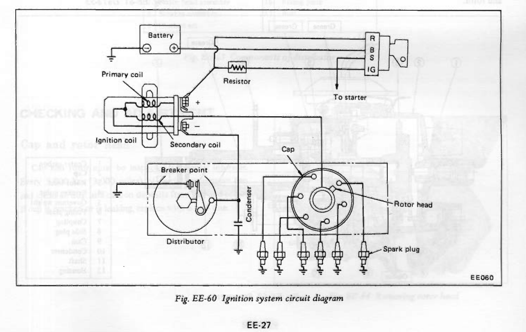

Don't fixate on the condenser. In fact, remove it until you get your spark problem sorted. It's job is to help eliminate radio noise, not make the coil spark... But, you can see from the above schematic that a bad condenser can permanently or randomly GROUND the coil thereby negating the operation of the points. You don't need it (you may want it, but you don't need it...). If you remove it while troubleshooting, it's one less variable.

Actually cgsheen's comment was only partially WRONG!. Disconnecting the condenser is a good idea.  The points won't "burn" immediately.  And the part about grounding (shorting) is RIGHT also.
