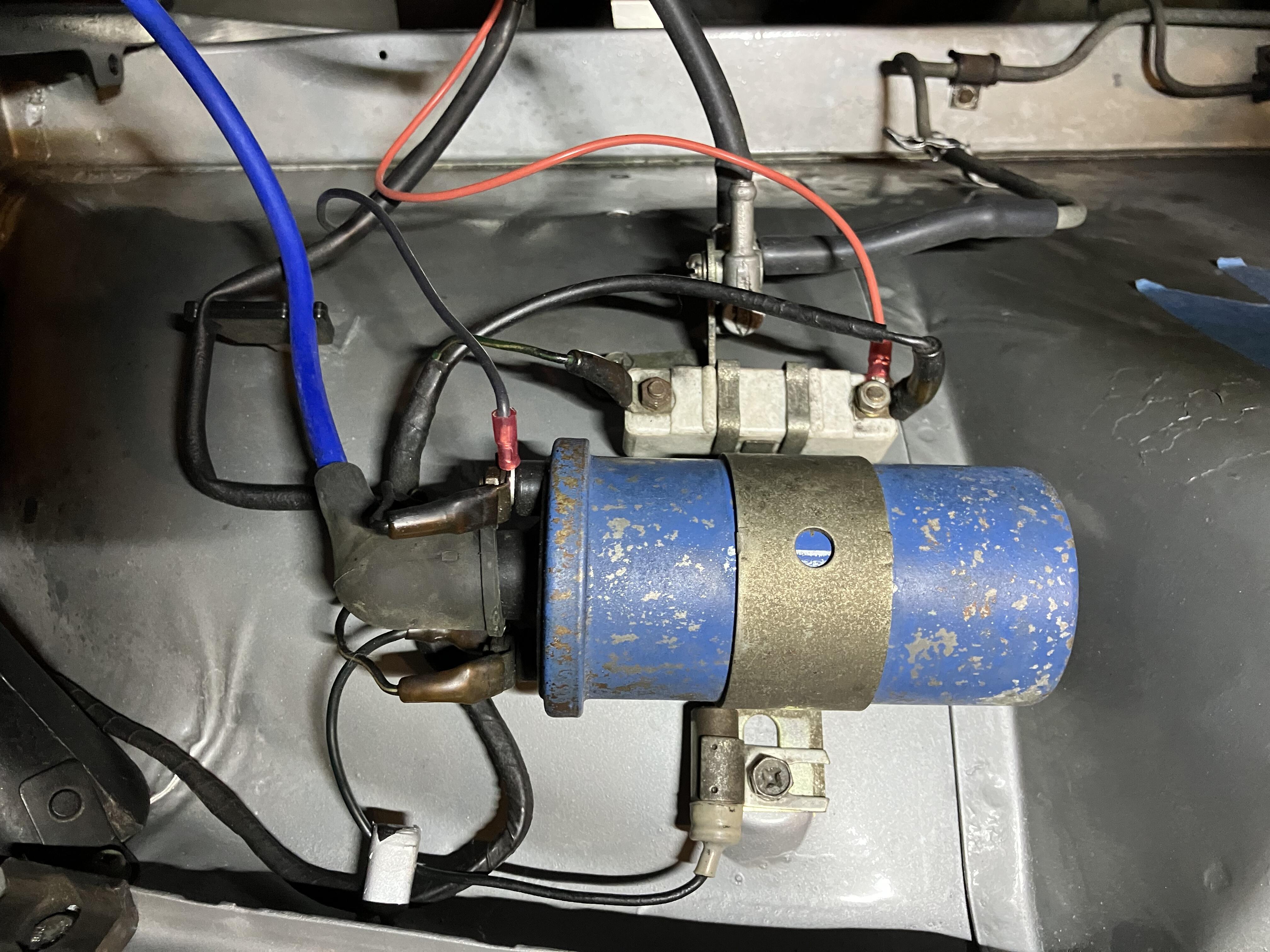

I've been assuming it was a fuel system issue, but now I'm starting to think it may be ignition-related.  It's been a couple of years since I installed the Pertronix kit, and I believe it said I didn't have to use the condenser, so it's not on the side of the distributor.  Is this an issue?  What else could be going wrong ignition-wise?  Here's the wiring to the coil area, can someone check my work?

Ignition modules can fail due to heat then come back to life when they cool down.  You could take some cooling spray, like Dust-Off Duster, and spray the Pertronix module under the cap in those minutes when it's not restarting.  Or take a spare spark plug, pop a plug boot, and check for spark.
Wouldn't be a surprise if it was the Pertronix module.  Apparently quality dropped dramatically many years ago.  There are old posts about it.  The Pertronix I's were also sensitive to leaving the key on.  It can damage them.
Yeah I wasn't super impressed with the fitment of the kit when I got it.  Actually had to get a guy at work to cut a notch in the mounting plate to clear the wires when the timing is advanced.  And the round rubber grommet doesn't fit the rectangular notch in the distributor body.
I don't have a spare plug lying around, but I could use my timing light.  Will give it a shot this evening.
Next time it dies, you could just pull the coil wire out of the distributor cap and lay it close to one of the nuts on the strut tower. Crank the motor and see if you have healthy looking spark.

  1. Pretty sure it's not the ignition, since I have spark the whole time.
