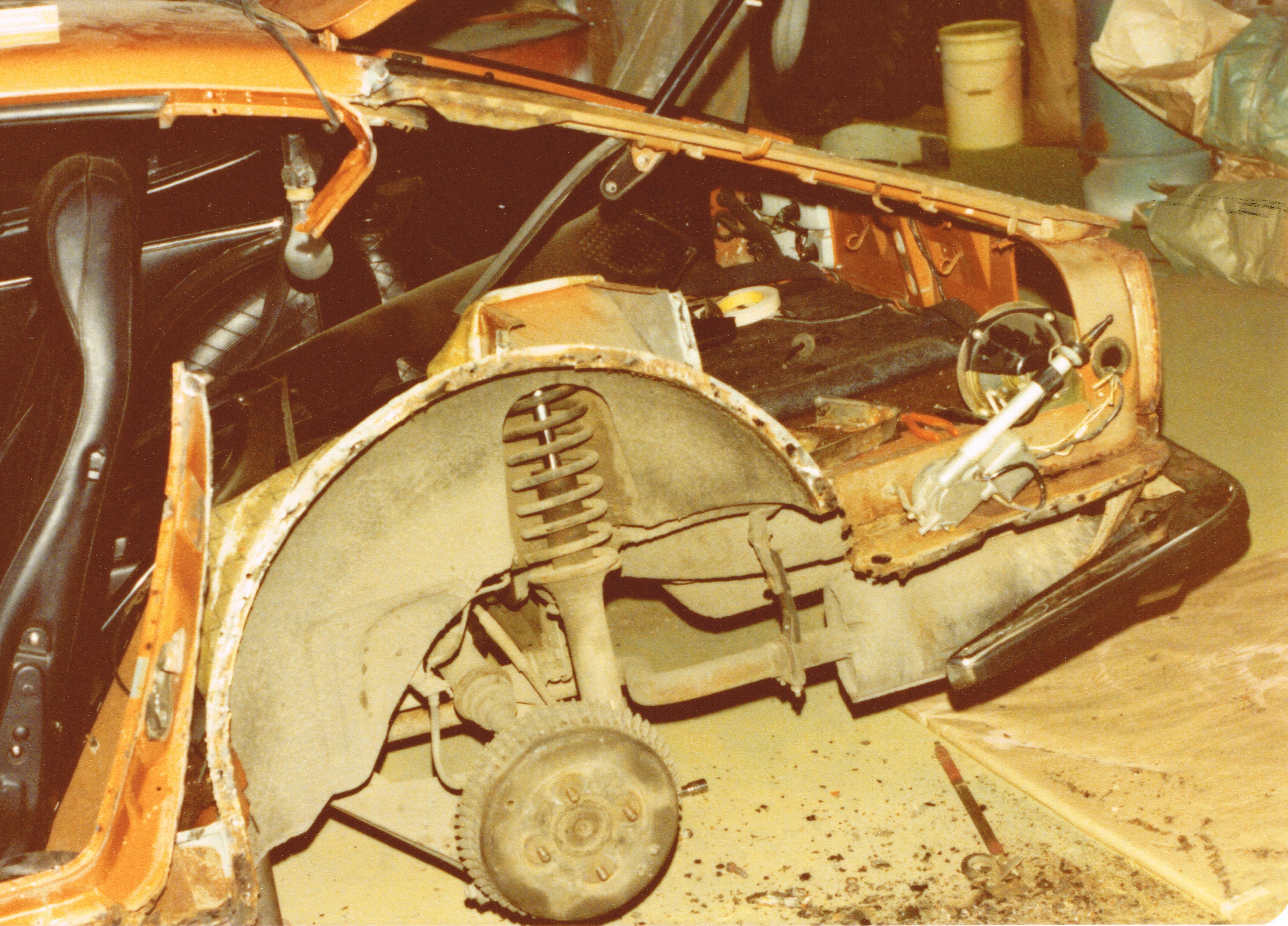

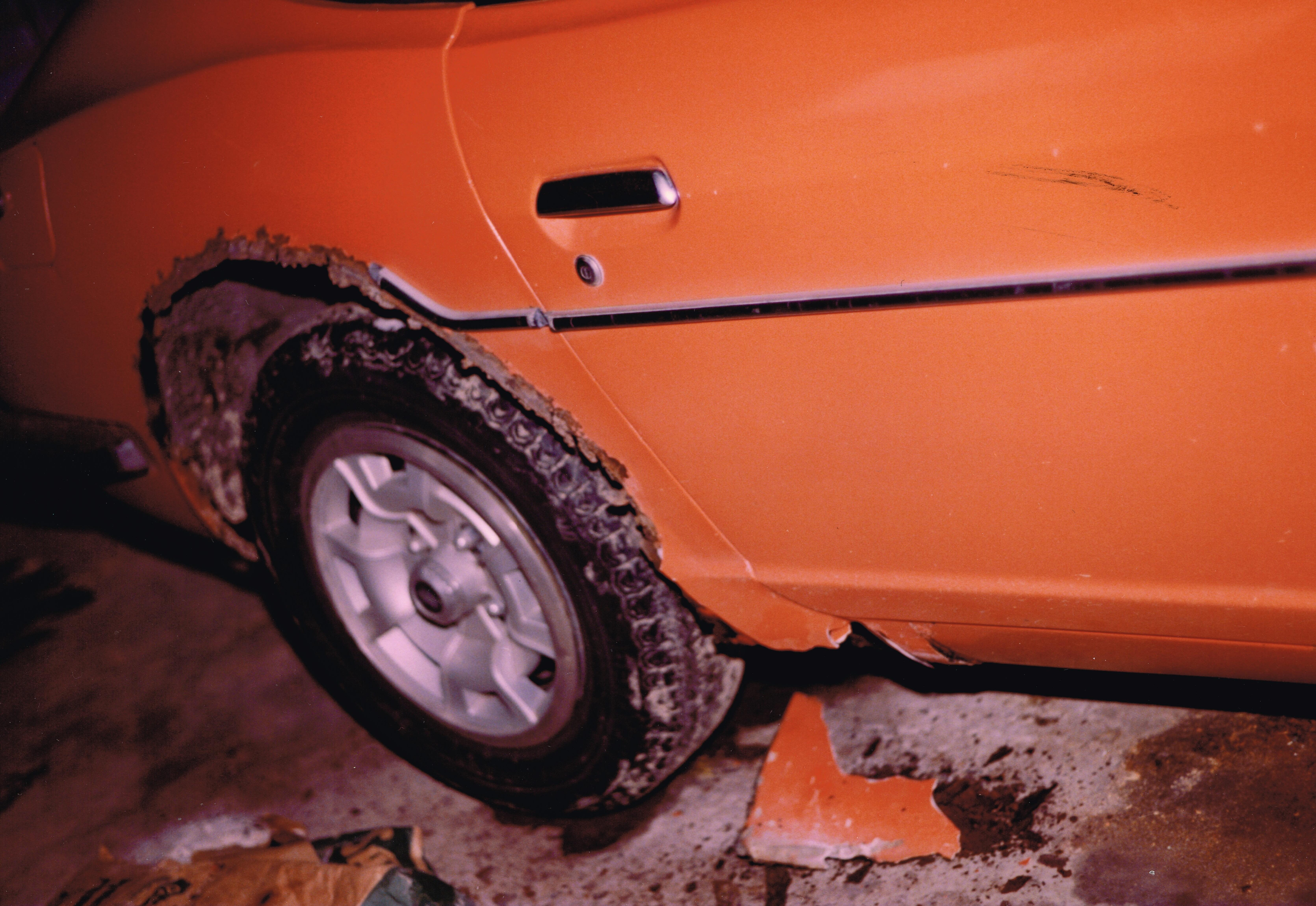

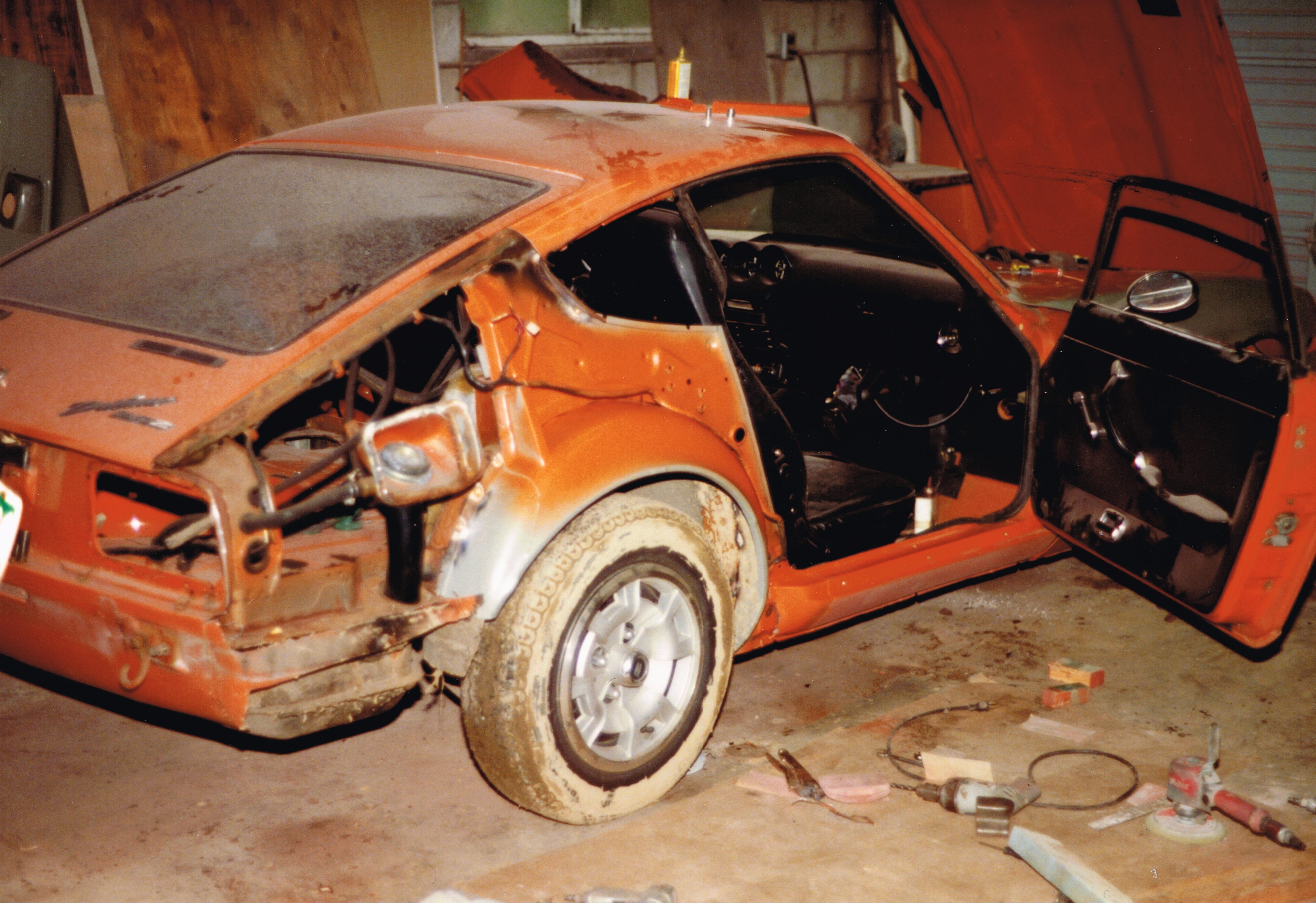

Here are a few pics from the early eighties when I had my rear quarters replaced. Sorry that they don't show more detail. The left side was actually done about a year before the right, as someone lightly backed into me and due to the existing shoddy bondo repair, a pile of rusty bits was left on the ground similar to the second pic, during the more complete resto. At the time of the incident I didn't have the funds to do the full resto.
The left side was cut back to the factory joint but on the right side it is cut further down, I'm not sure why? Or if it was cut more later in the repair process?  Anyways you can see a little of the detail. I wish I had taken more closeup pictures back then.
Edited by CanTechZ

Agghh, it’s like a horror show….

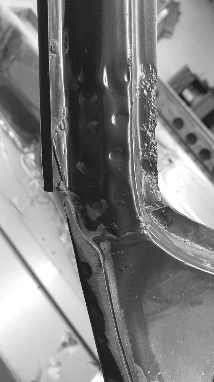

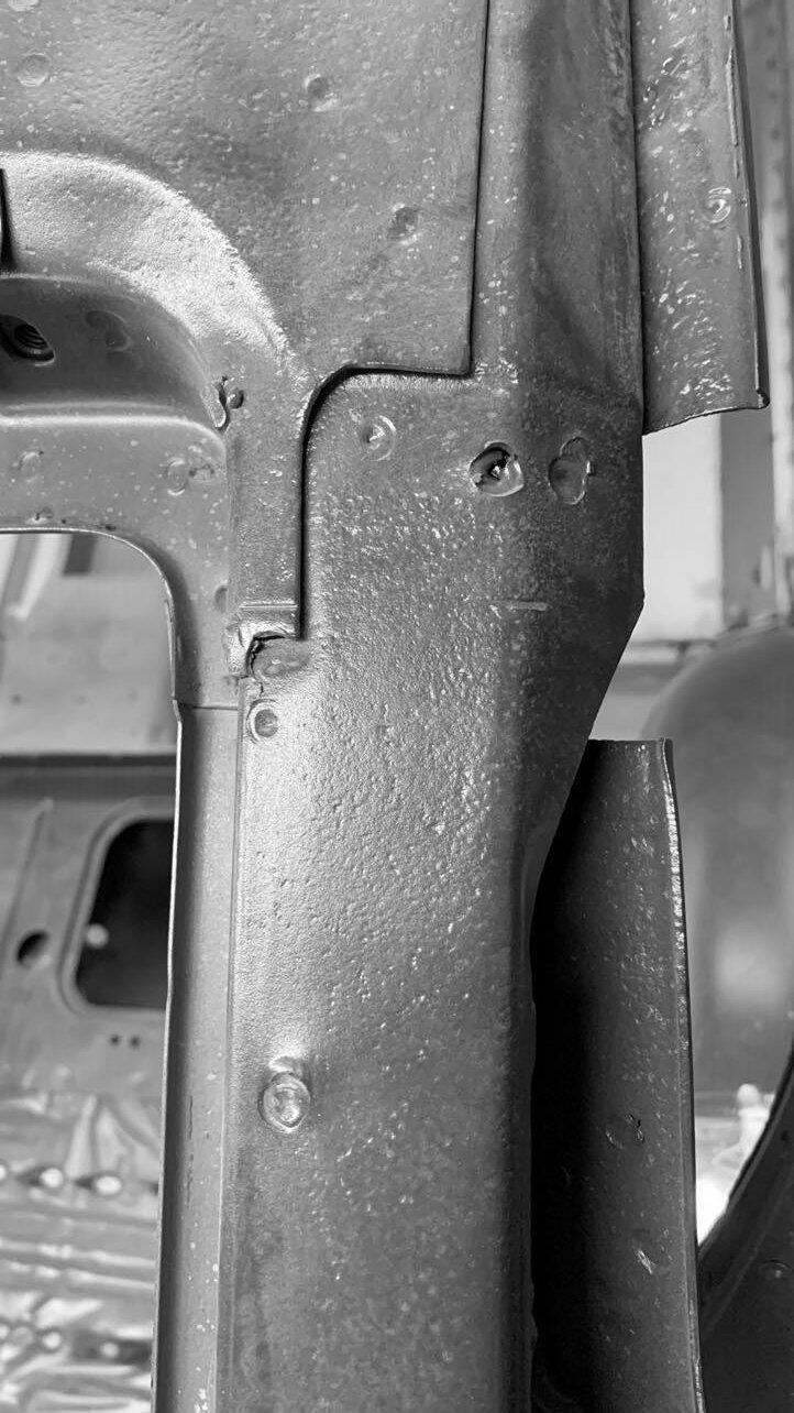

...and here's a right-hand rear quarter roof/quarter joint with rear quarter panel removed (spotwelds drilled out), blasted and etch-primed:
It's a complicated joint - the meeting point of roof outer panel, roof rear crossmember/hatch hinge mount/roof longitudinal rail/rear quarter. Perhaps not surprising that it required lead-loading.

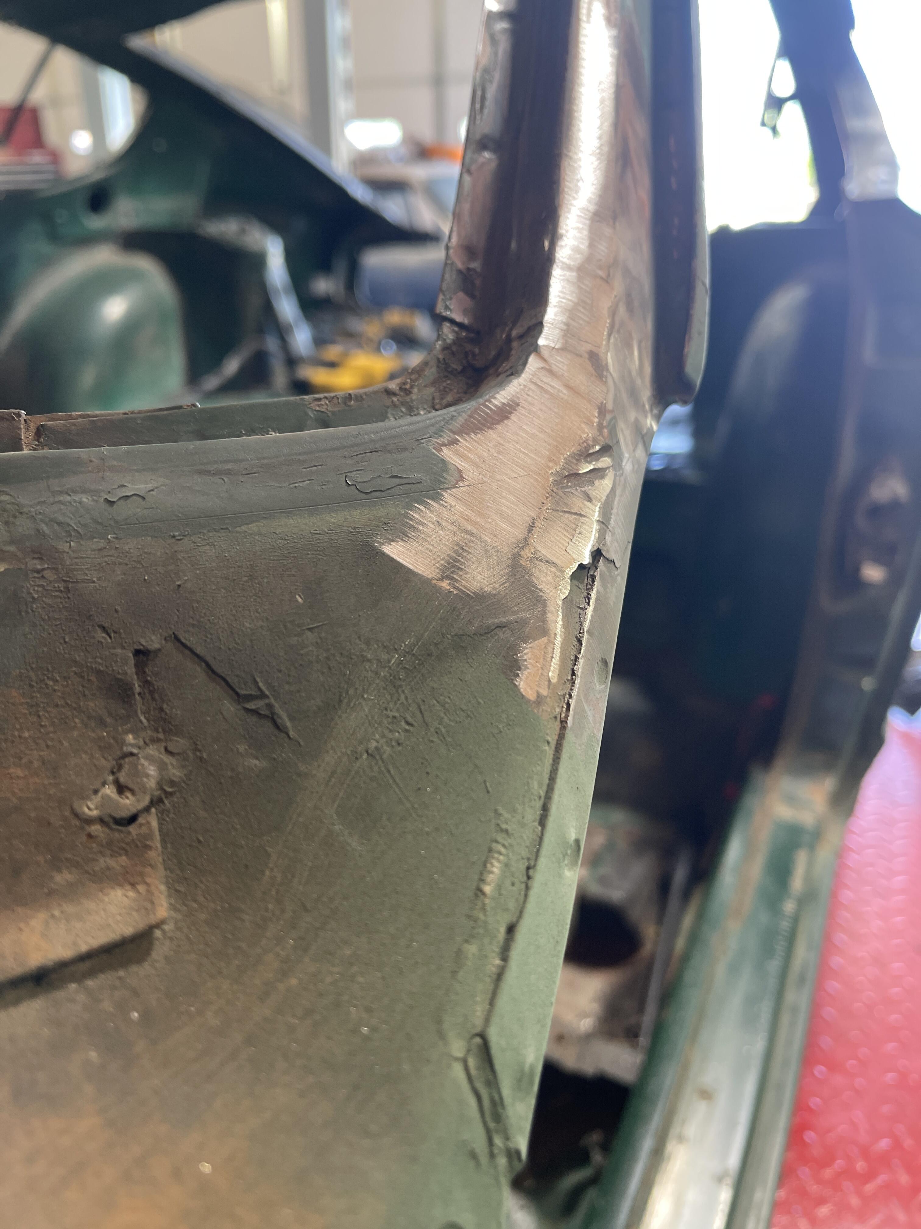

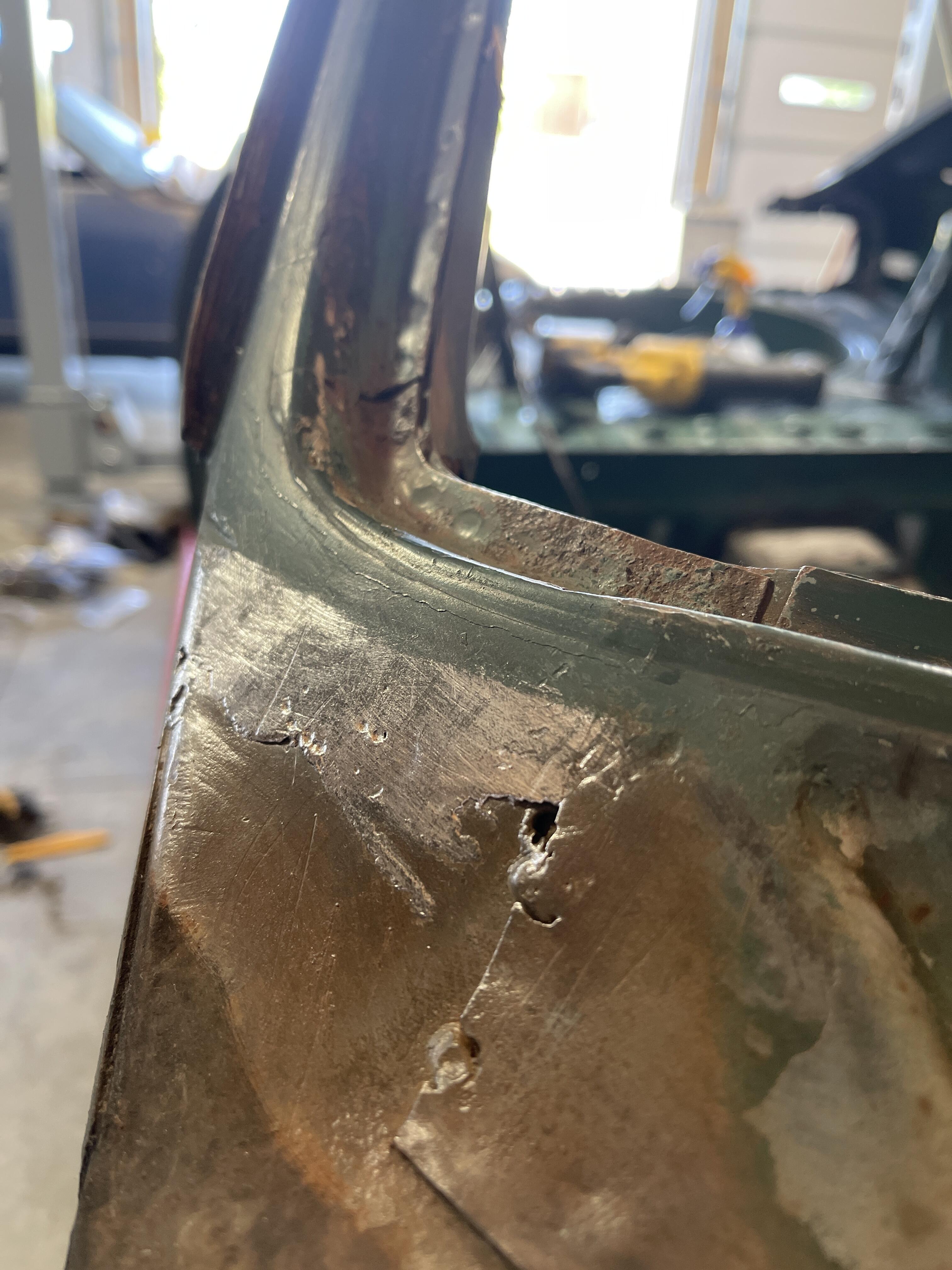

Thank you Allen… windshields pillars are looking good, thankfully…  dip,or blast will tell the tale.image.jpgimage.jpg

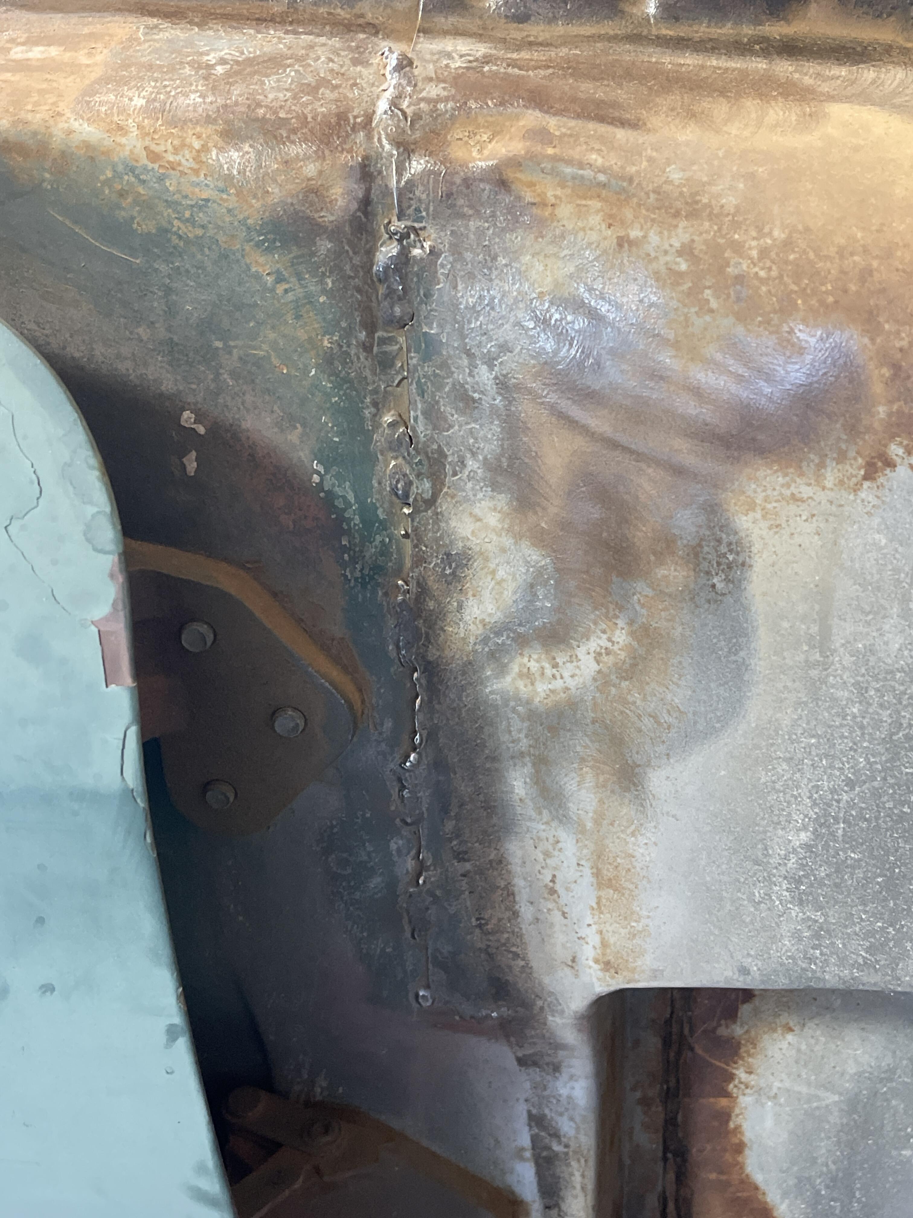

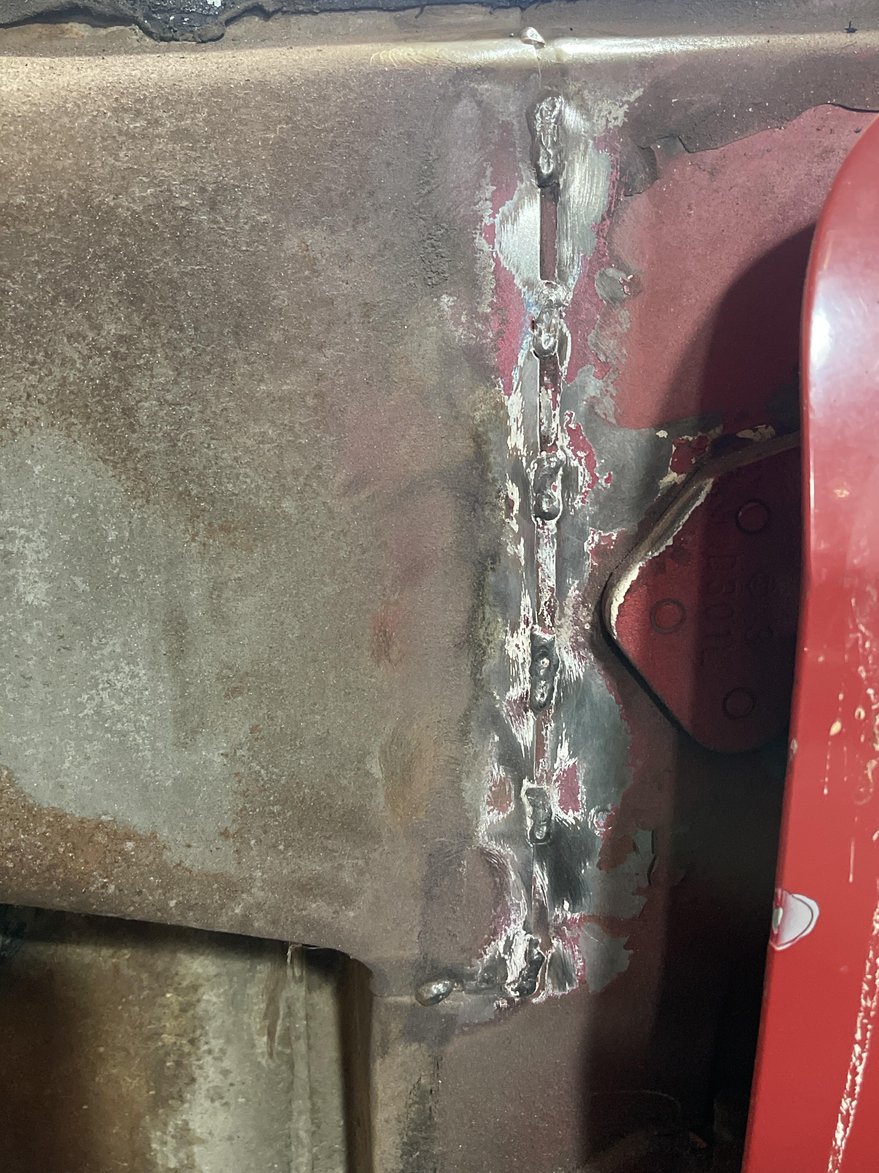

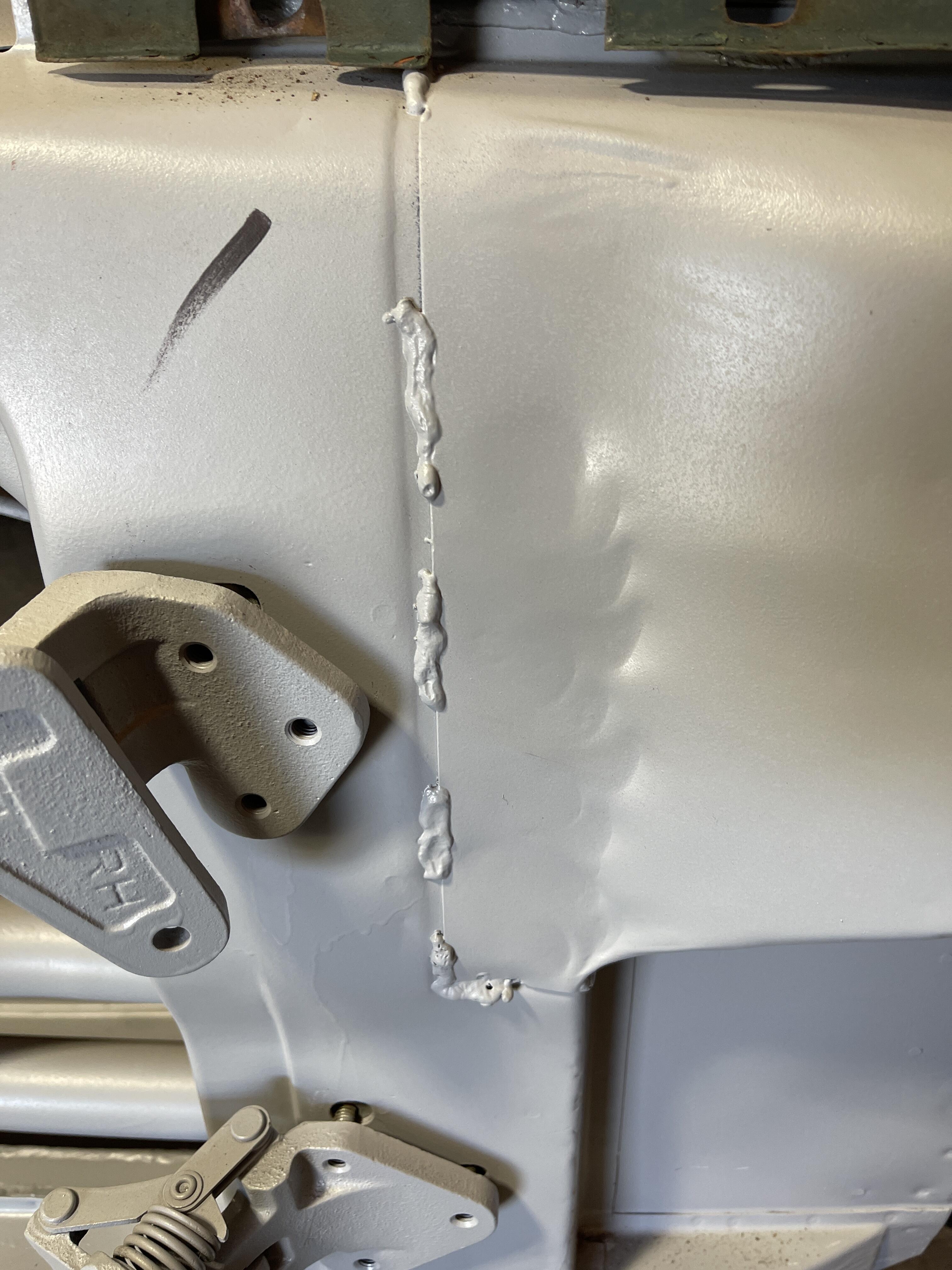

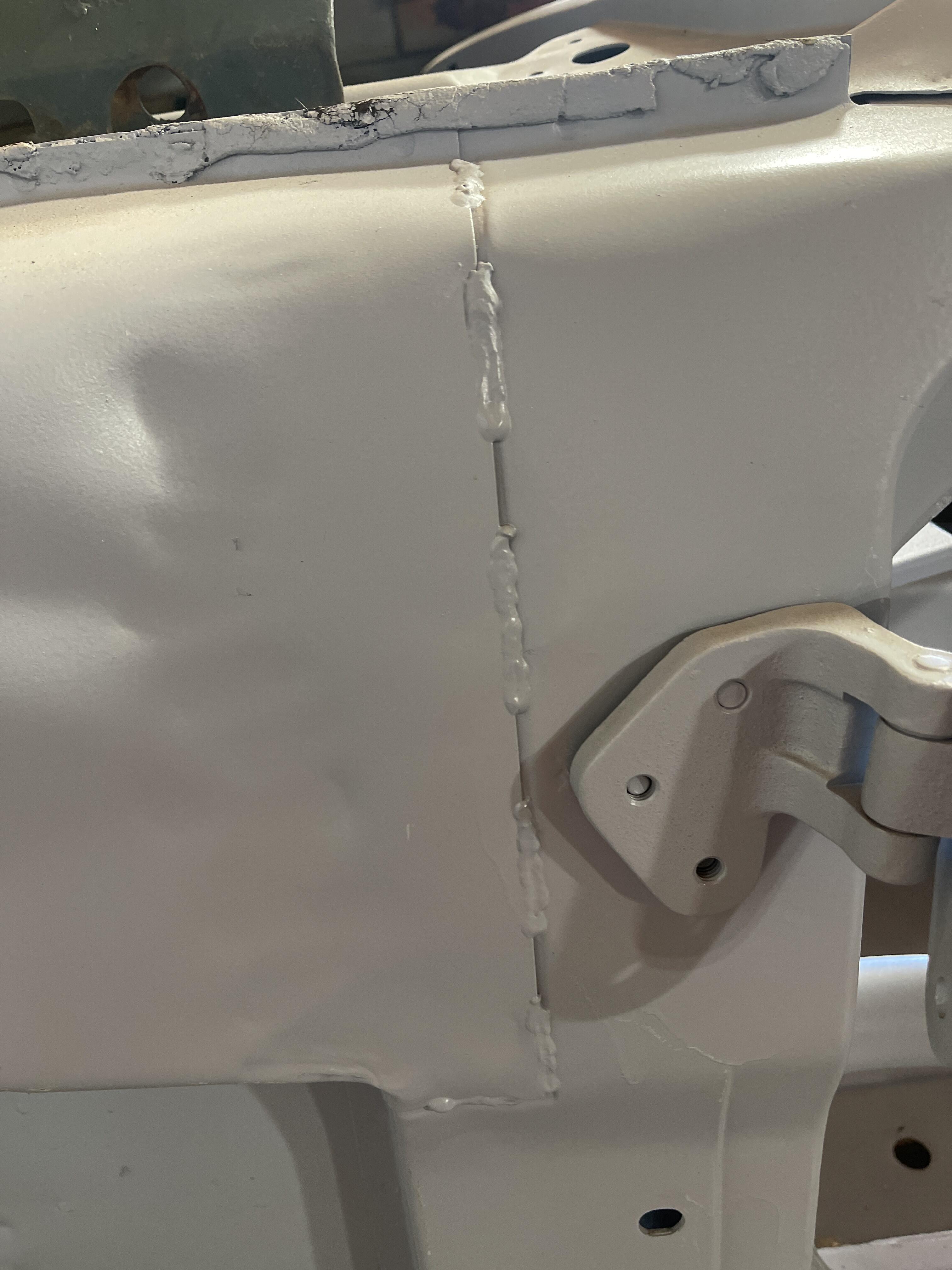

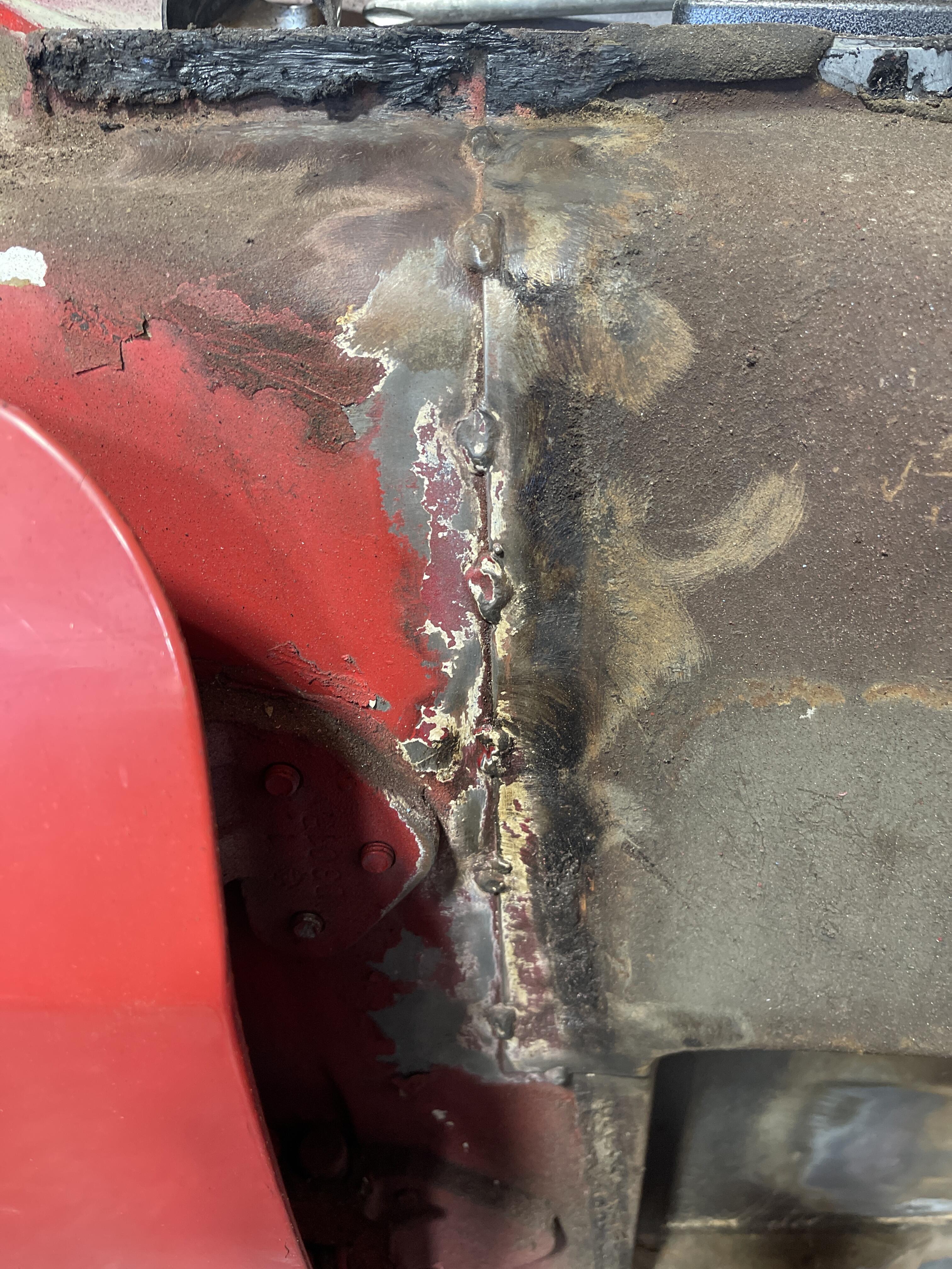

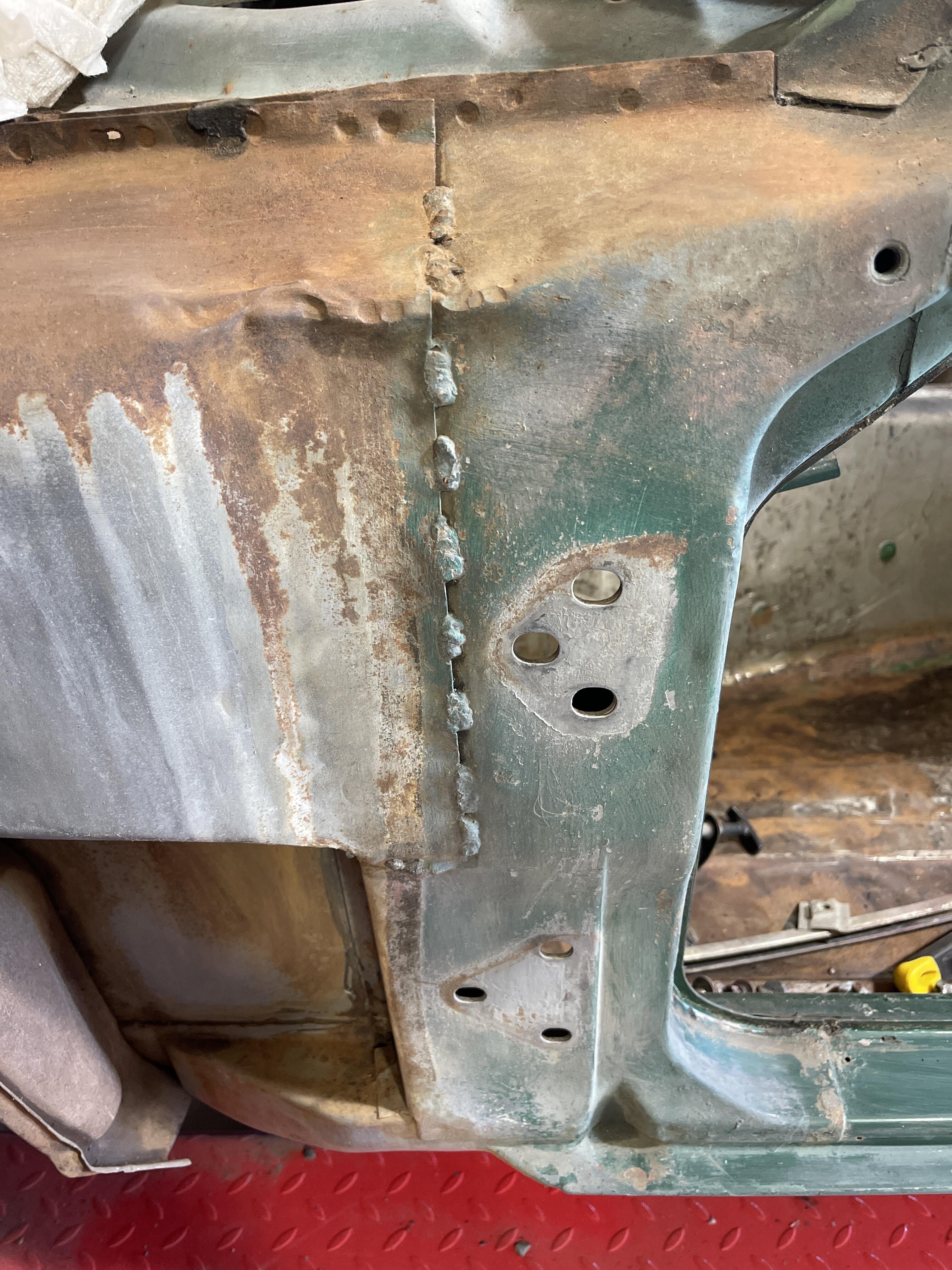

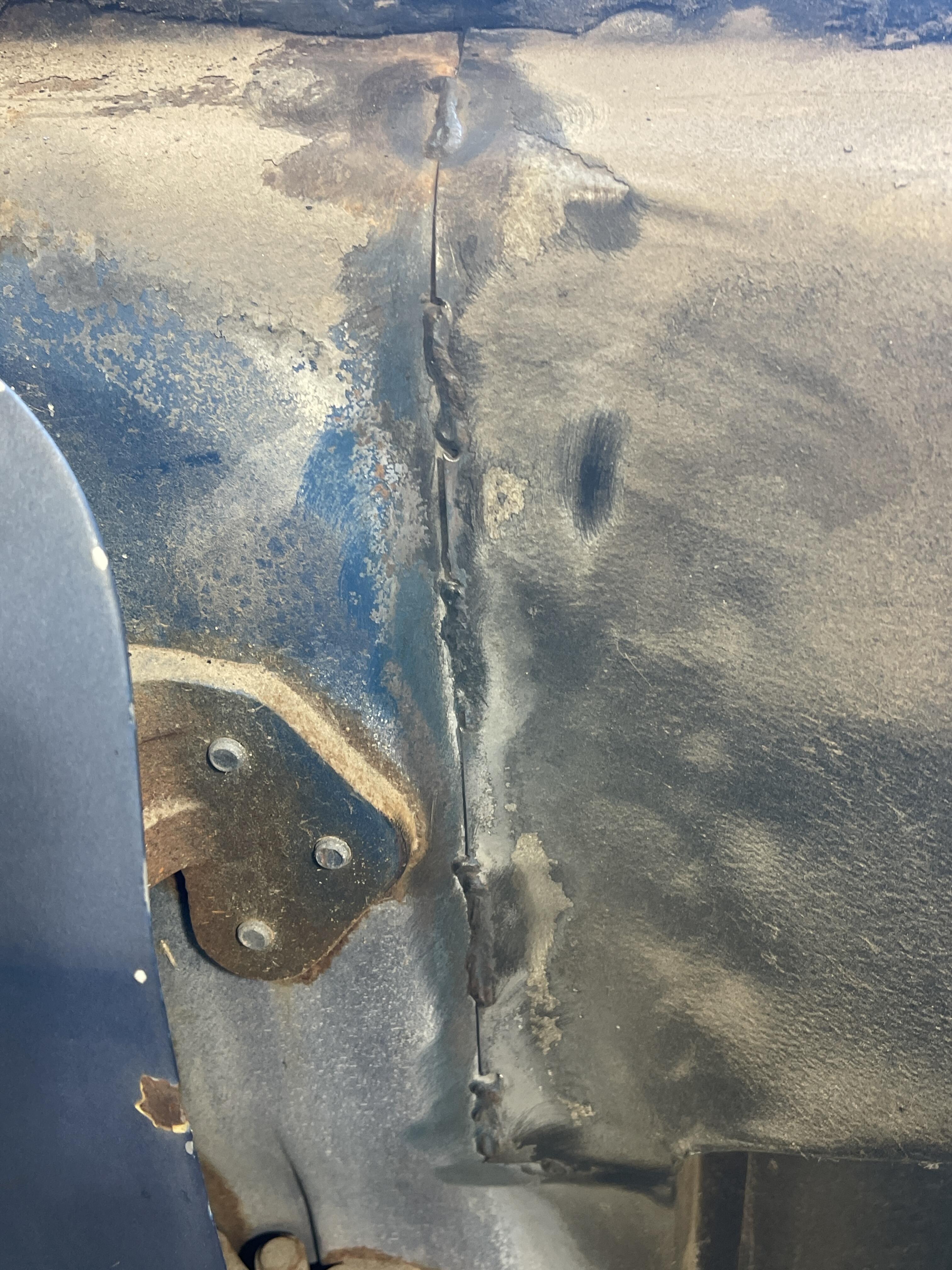

  Having to shout squirrel every 30 minutes or so, when distracted by items not noticed before, or perceived body and fender support changes in production methods like this welded joint between ….some changes through the years….
Hls30-00051  first pair welding exhibits “Green car”
Hls30-00740….”blue car”
Hls30-03496…. “Primer”
Hs30- 10324…..”red”
quite a difference in weld patterns.image.jpgimage.jpgimage.jpgimage.jpgimage.jpgimage.jpgimage.jpg

Since the screen pillars ('A') and rear quarter/roof joint ('C') are both finished with lead-loading, any hypothesis of them being "designed to flex" (I would say more likely 'expected to flex'...) would have to apply to both, no?
I'm struggling to think of any other cosmetically-observable area on the bodyshells of these cars which is similarly 'filled' before paint. Nissan Shatai didn't bother to pretty up the joint between the rear quarter panels and the lower rear apron (spotwelds nicely visible and always a pleasure to see...) and I can't think of any other points on the body where - all opening panels closed - filling/joint disguising before paint was necessary.
If I'm right, those lead-loaded joints are the only cosmetically-enhanced/filled-before-paint joints on the whole car. The 'designed to flex' thing seems like an answer looking for a question.

p.s. 2 - those welds look terrible.  I wonder if they got better along the way to the 280Z bodies.  It would be interesting to see some later welds.

I found a 77 seam.  It doesn't look much better than the 240Z's.  Maybe a little bit smoother.  Still just a fairly crude stitch weld.
