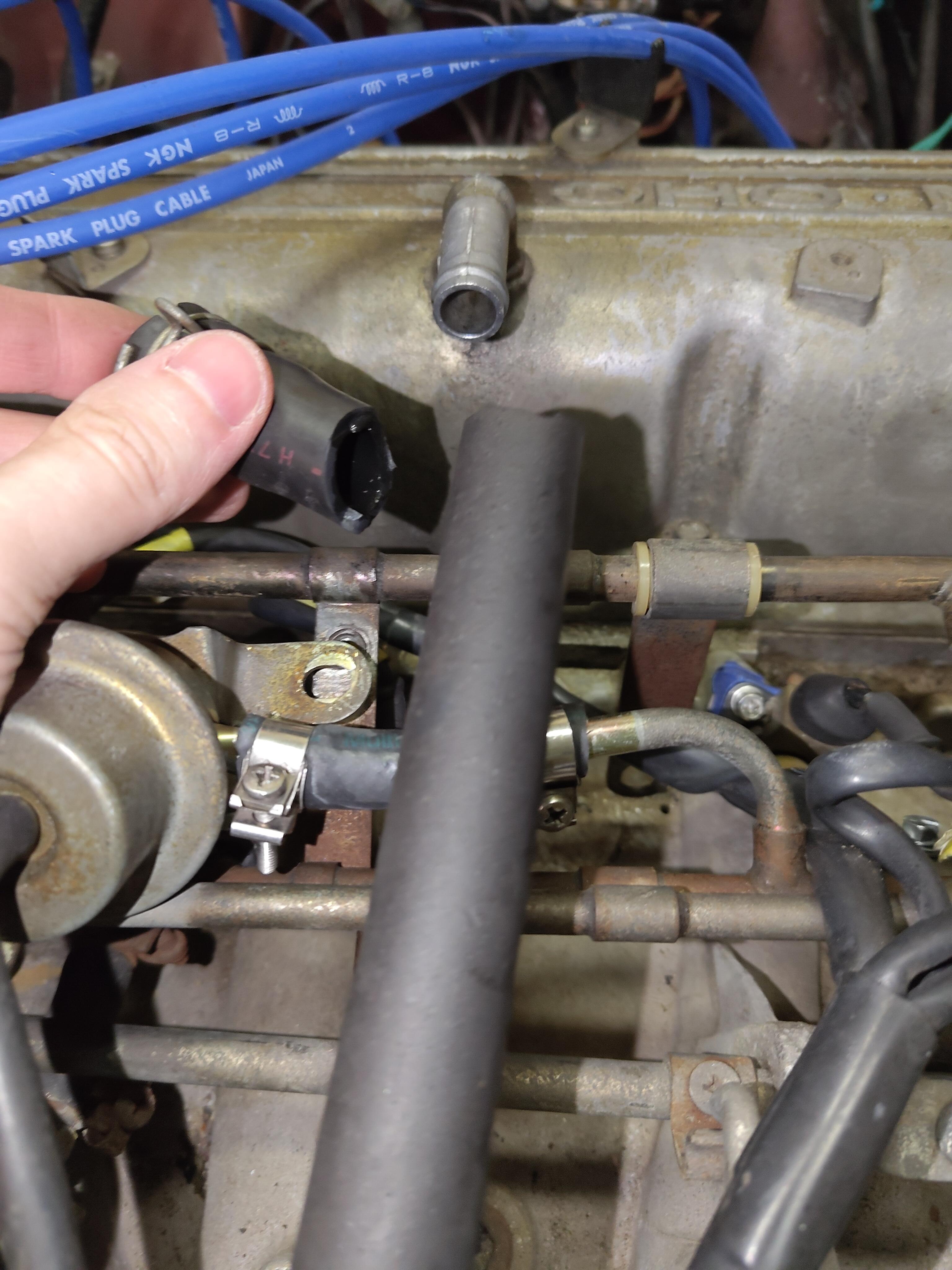

HOWEVER! As I was staring at the engine, pondering life, I thought to myself "look at the hose coming off the valve cover"  So I did, and it was very loose. VERY loose. I felt the underside of it and there was a gigantic crack; I attempted to pull the already loose hose off, and it just fragmented into two pieces.
I put my thumb over the end that led back to the AFM accordion pipe, and the idle audibly lowered, so maybe I've got vacuum leaks to chase down? Would that cause the missing/stuttering  because its metered air that's lost?
Also, as I turned the car off I could hear a definite air hissing noise that stopped after maybe 4-5 seconds as it waned.
