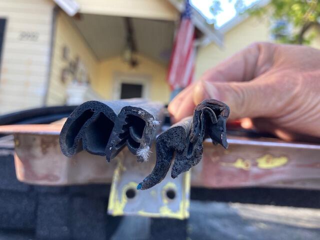

I just went to the pick-n-pull and got some weather stripping off a 1999 LandRover discovery.  I pulled the back hatch and the two front door weather stripping and they fit really good.  The doors and hatch are a bit tight as I believe the rubber has to settle for a bit.  If you buy new they also indicate door need to be slammed shut as they rubber needs to be compressed.  They suggest to keep the door closed in a warm environment. Well now that I think about it these are used so maybe they won't compress more.  Well time will tell.
Left side the new and of course my 53 year old gasket on the right.  The best is the price......$1.50 each.
