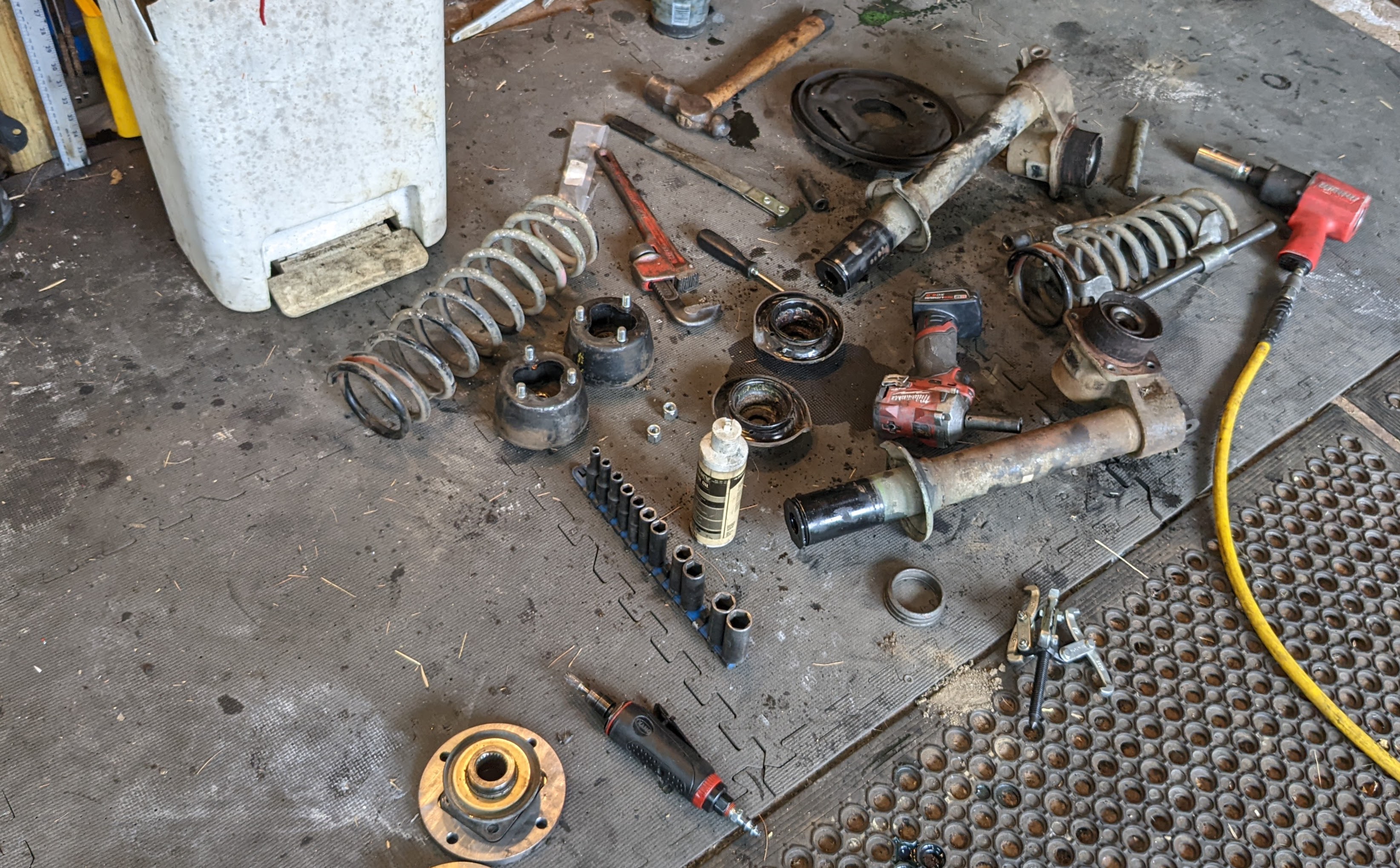

July 8, 20231 yr comment_654925 On 7/6/2023 at 8:25 PM, HusseinHolland said: Did the mustache bar bushings and the inner control arm bushings. If I can't extract the outer c/arm bushings in-situ tomorrow, I'll have to drop the arms entirely. I'll get the trans jack if that happens, I'll need it anyway for the V8/4l60E drivetrain. Forward bushings are longer than the rears. For mustache bar, the original bushing sleeves need to be kept, so I holesawed the rubber out & wire brushed the sleeve of residual rubber rear bushing sleeves came off with just a little soaking old remnants Those crenallated washers still have value to some people Link to comment https://www.classiczcars.com/forums/topic/68436-75-280-rear-suspension-work-disc-brake-conversion-milkfab/?&page=2#findComment-654925 Share on other sites More sharing options...

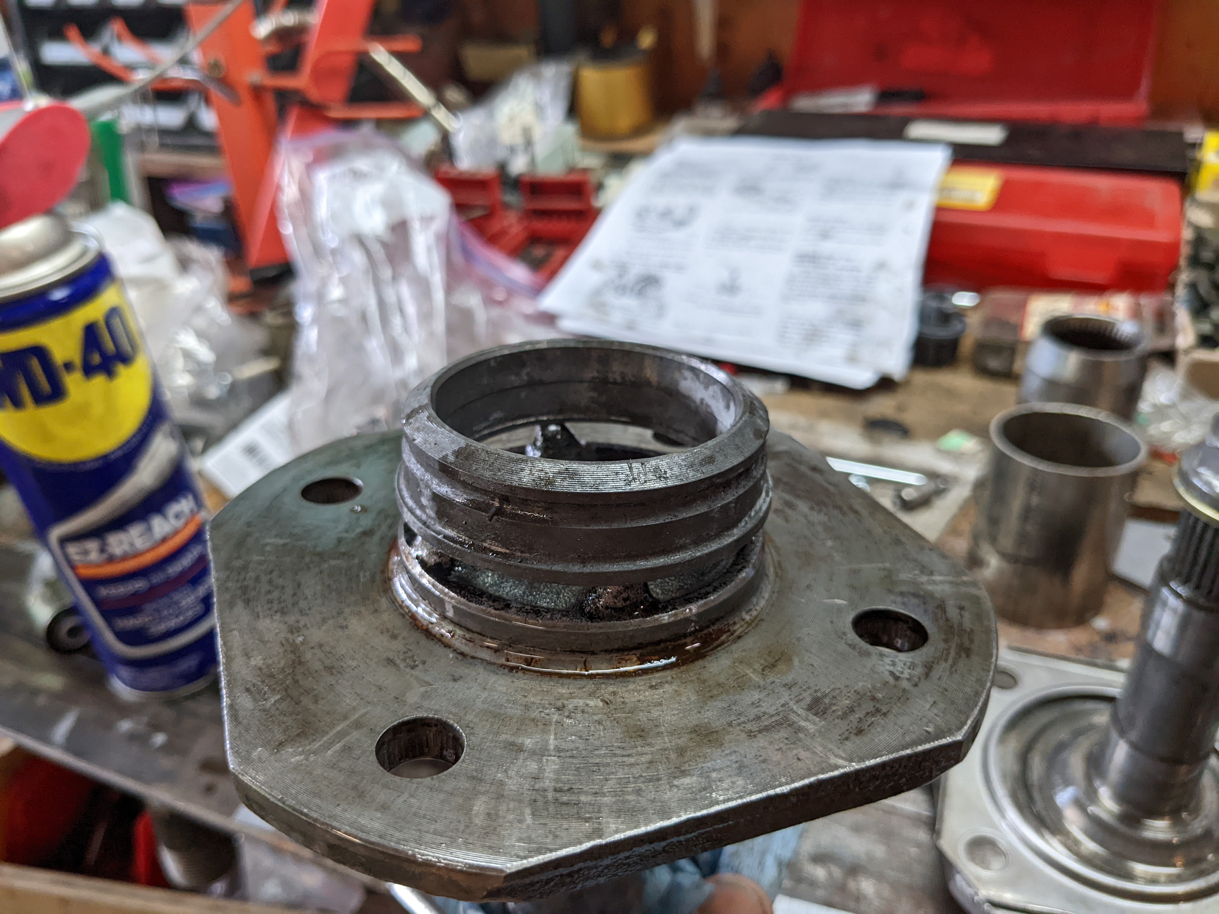

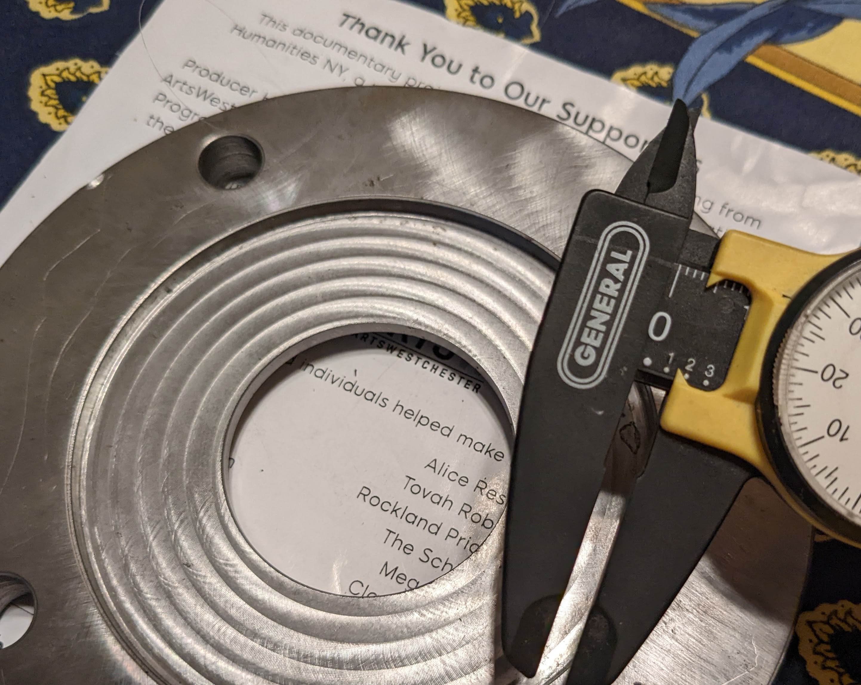

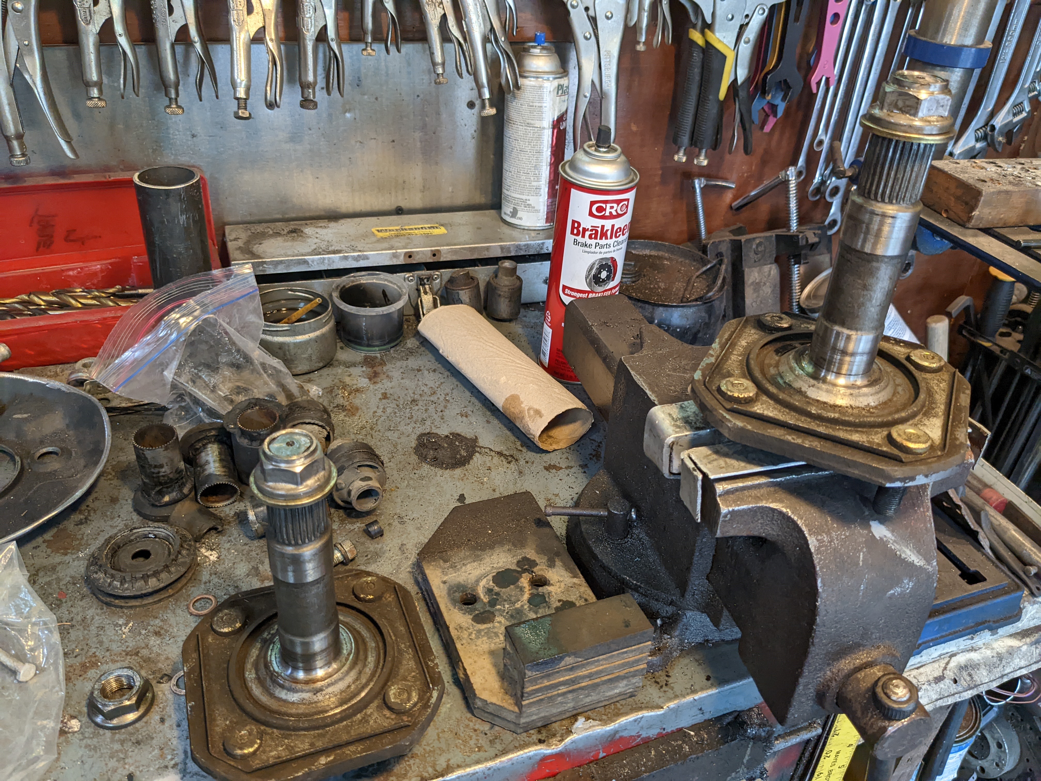

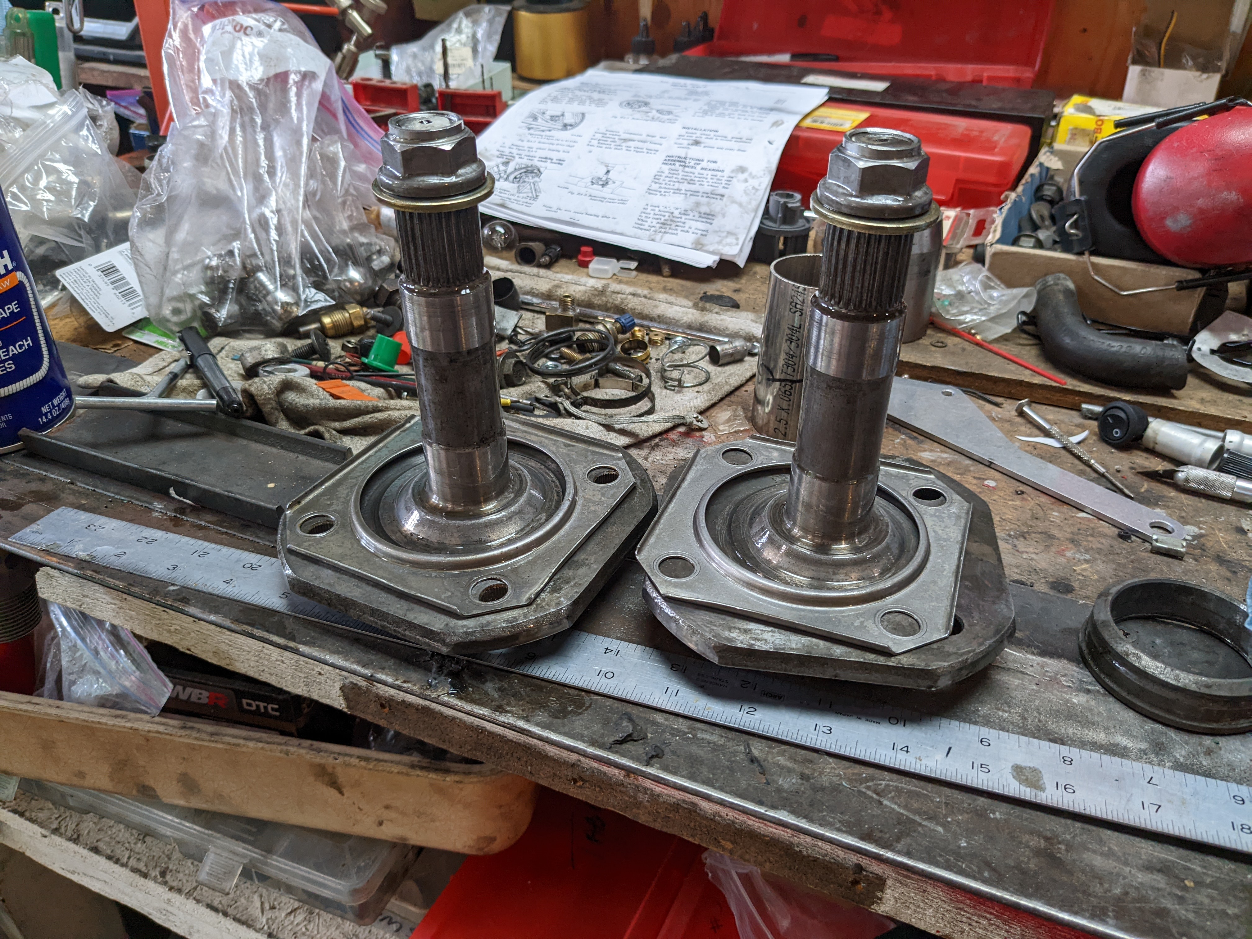

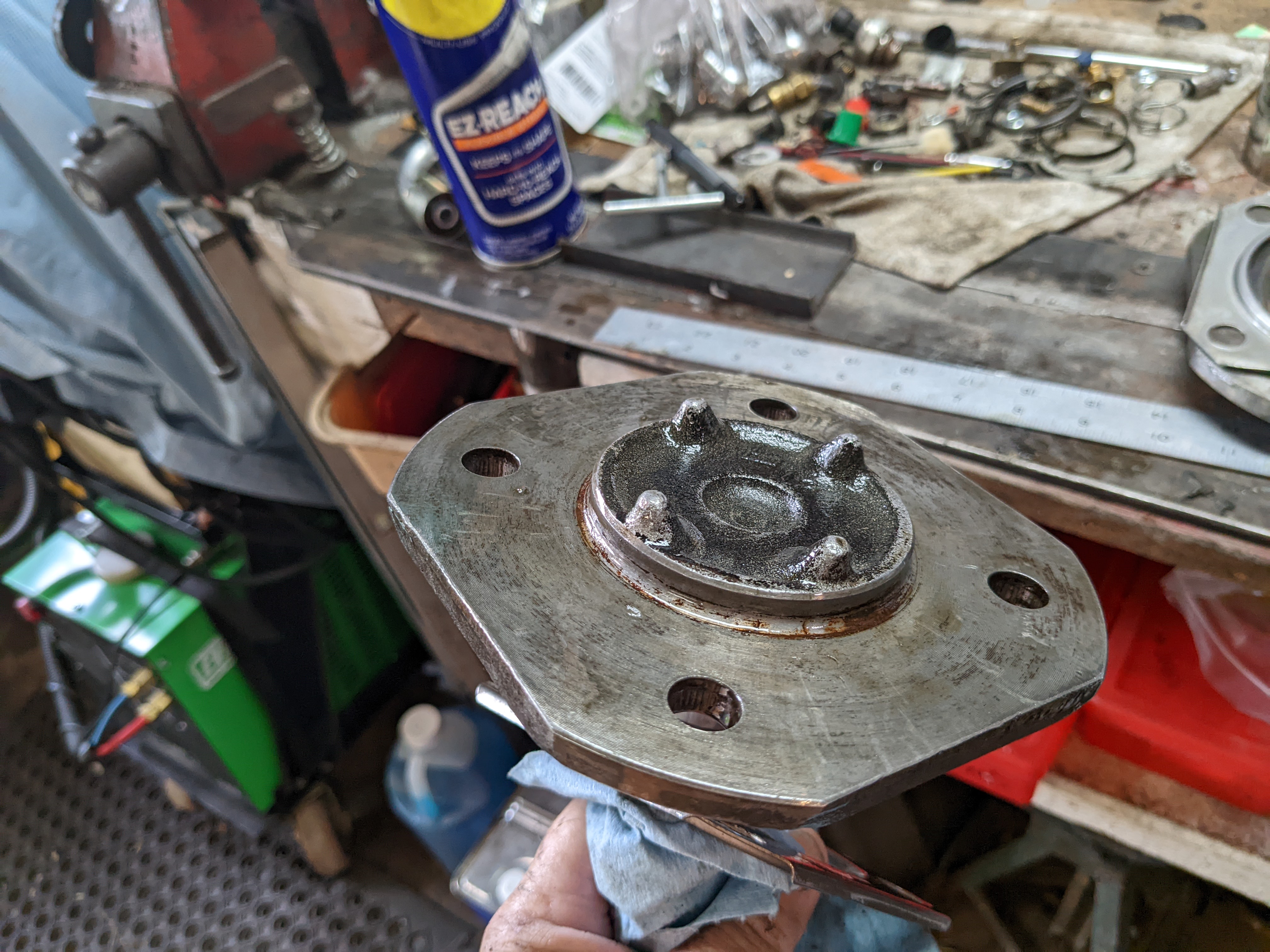

July 9, 20231 yr Author comment_654947 Took the rear struts & hubs apart after doing the Fuel pump setup. Removed the drum brake back plates that are no longer needed. cut down the nub of the spindle, to make sure the Z31 CV cap doesn't hit removed the (too short) wheel studs & cleaned the outer flanges Still not happy with not having a hub seat for the wheels I may weld on a sleeve (cut from a Volvo), that will allow me to use a hub centric ring (65.1 - 73.1) to set the Konig wheels. Have to have the nubs turned down in that case, to get a good seat for welding Edited July 9, 20231 yr by HusseinHolland Link to comment https://www.classiczcars.com/forums/topic/68436-75-280-rear-suspension-work-disc-brake-conversion-milkfab/?&page=2#findComment-654947 Share on other sites More sharing options...
July 9, 20231 yr comment_654959 14 hours ago, HusseinHolland said: Z31 CV Haven't read the details but if you're planning a CX axle conversion you'll want to take good measurements if you're using aftermarket CV axles. Apparently they often have longer compressed lengths than the factory CV axles. People have had problems.  Don't forget to use the axle shaft as the center for machining when you convert to hub-centric. Since Nissan used lug-centric they would have no reason to set a tight tolerance on the rough cut of the "hub".  Link to comment https://www.classiczcars.com/forums/topic/68436-75-280-rear-suspension-work-disc-brake-conversion-milkfab/?&page=2#findComment-654959 Share on other sites More sharing options...

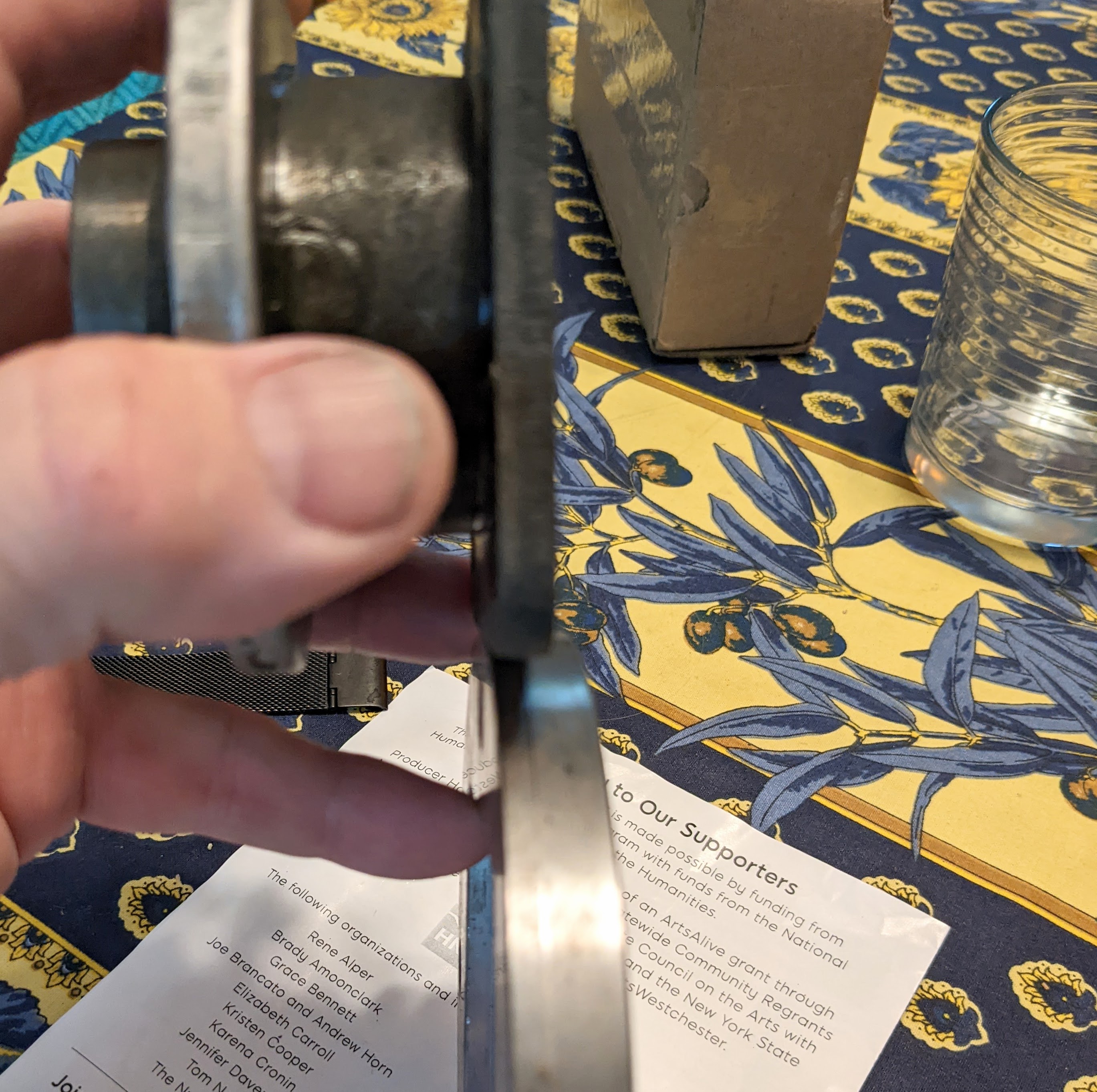

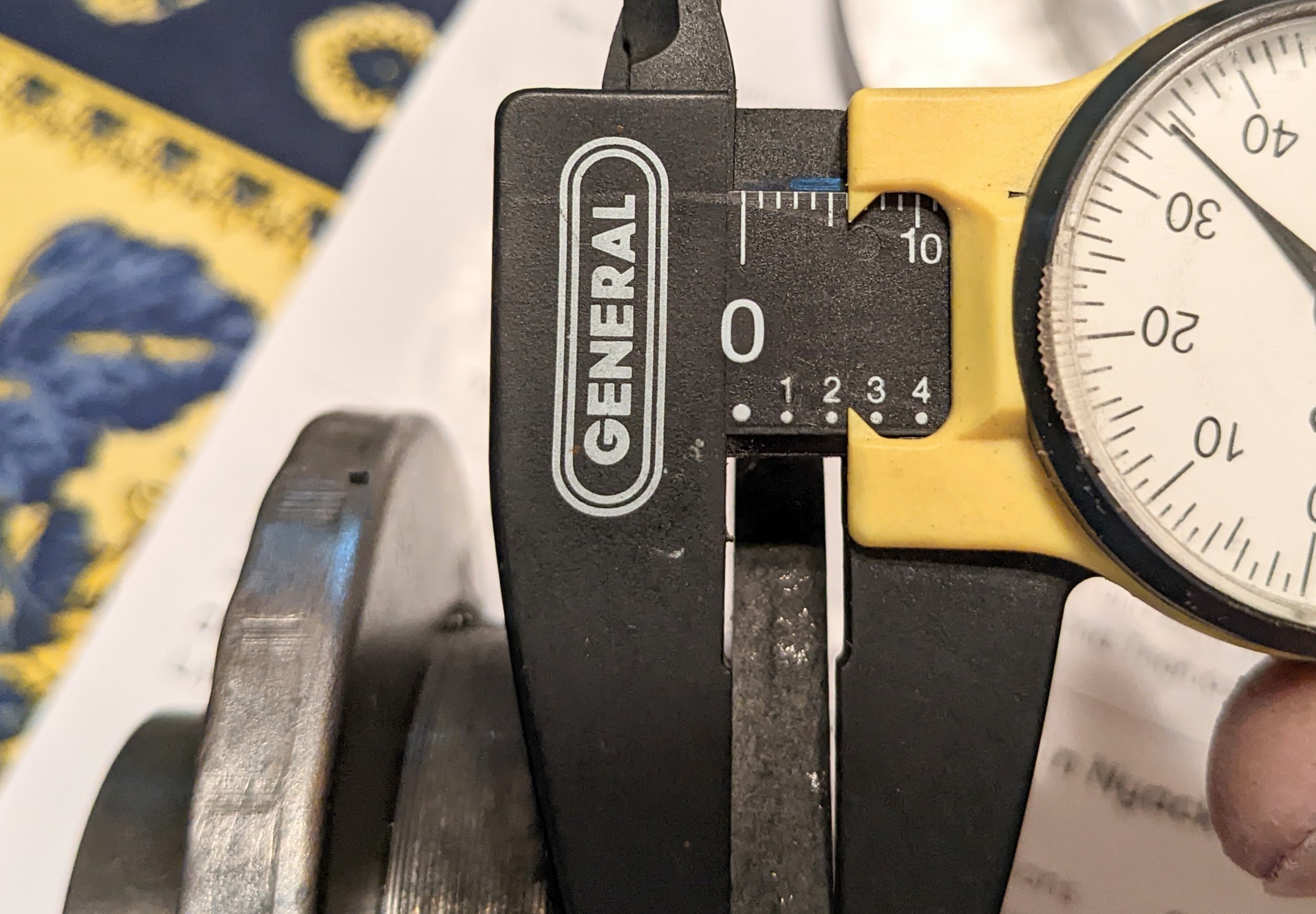

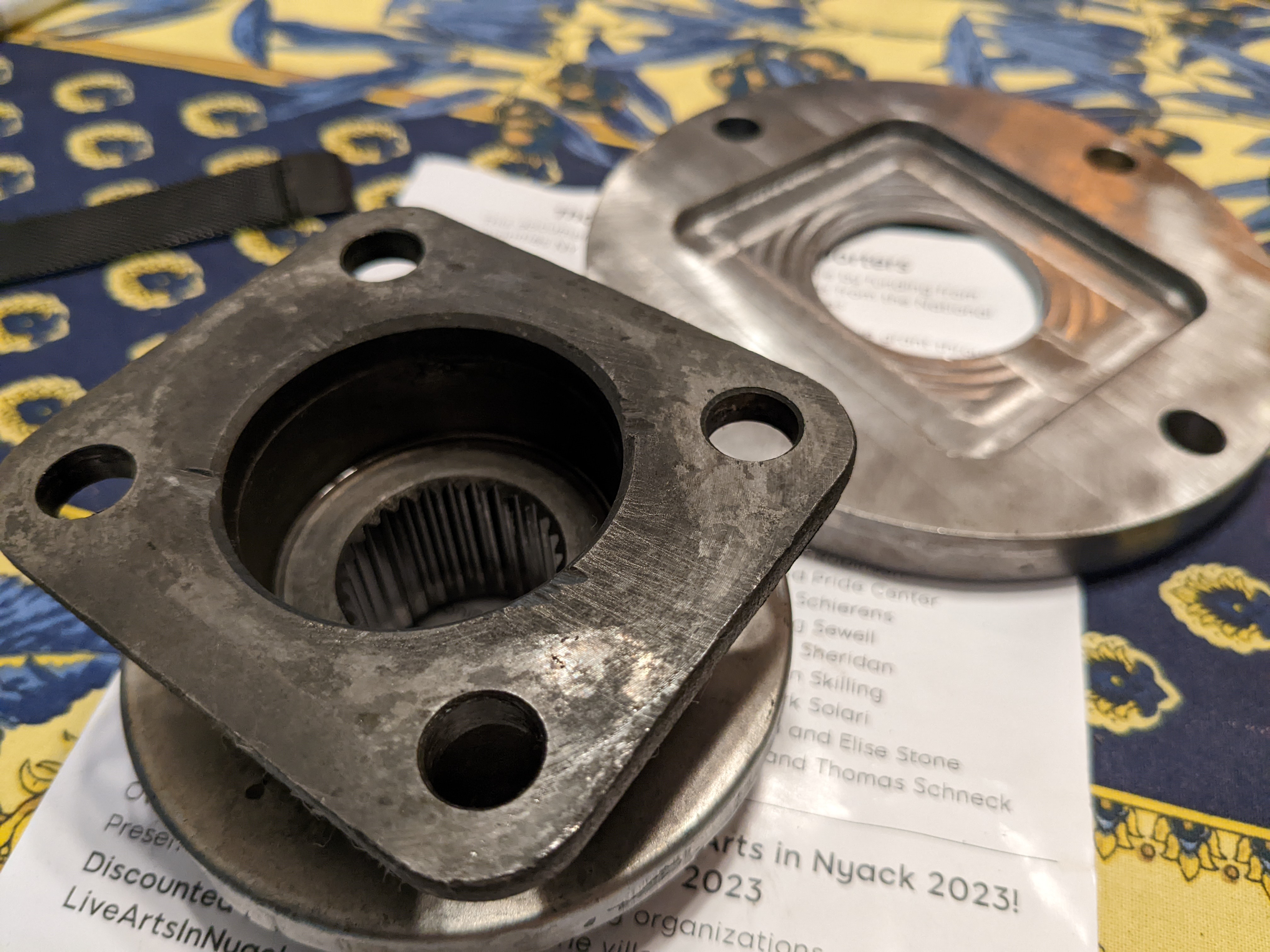

July 9, 20231 yr Author comment_654961 11 hours ago, Zed Head said: Haven't read the details but if you're planning a CX axle conversion you'll want to take good measurements if you're using aftermarket CV axles. Apparently they often have longer compressed lengths than the factory CV axles. People have had problems.  Don't forget to use the axle shaft as the center for machining when you convert to hub-centric. Since Nissan used lug-centric they would have no reason to set a tight tolerance on the rough cut of the "hub".  I bought the Z31 ('87 300ZX T) axles (NI8435, NI8442) that go with the Silvermine flanges - Trackmotive  brand off RockAuto. What I don't like is that the existing flange doesn't sit in all the way, so there is about 8mm lost in terms of overall depth for the new axle, which as we know is longer than stock. The other factor is the one you mention, that Nissan didn't bother making the flange concentric with the hub/axle, so that has to be addressed. The way the plates are supplied, they are supposed to be welded in to the recess provided, but since the stock flange isn't hub-centric a jig of some kind is required to center the weld flange to the hub. What I'm thinking of doing is removing the inner flange & having the hub shaft turned with a 4mm shoulder for the new CV flange to seat on, so I can get the flange surface back to stock depth. That should prevent the CV from bottoming out & binding, I hope. stock flange 6mm thick new flange is 12mm Old flange only sits 4mm into recess other side recess for CV cup is 4mm  Edited July 10, 20231 yr by HusseinHolland Link to comment https://www.classiczcars.com/forums/topic/68436-75-280-rear-suspension-work-disc-brake-conversion-milkfab/?&page=2#findComment-654961 Share on other sites More sharing options...
July 10, 20231 yr comment_654967 I've never messed around with converting to the CV axles, so I'm all kinds of confused. With that in mind... You cut length off the end of the stub axle. And now (with just the washer and nut) on the threaded portion of the stub, the end of the axle is below the surface of the nut? How does it look with everything assembled in-situ? The reason I ask is that when installed "as used" the nut will not thread on as far as you have in your pics and you will have even less thread engagement. I'm not really worried that you'll have enough threads, but I am a little concerned that there won't be any place to put your anti-vibration peen. In other words... When you put everything together, it's the bearings and spacer tube (distance piece) that establish where that nut will get tight. Not where the washer bottoms out on the splines like you have in your photo. The nut will become tight before it's as far on as you have it in your pics. Another question is how do the new CV adapter flanges attach to the original rectangular flanges? I've never messed with them, so I have no idea. Do you drill holes for bolts, or do you weld them on or what? And lastly. it should be a relatively simple matter of machining the original wheel mounting flange to accommodate some sort of hub-centric ring. I haven't done it, but seems like you could turn down the original center hub to a smaller diameter and fit a special made centering ring over it. Press it on with no welding required? What is the diameter of the original hub ring, and what diameter are you trying to achieve? Link to comment https://www.classiczcars.com/forums/topic/68436-75-280-rear-suspension-work-disc-brake-conversion-milkfab/?&page=2#findComment-654967 Share on other sites More sharing options...
