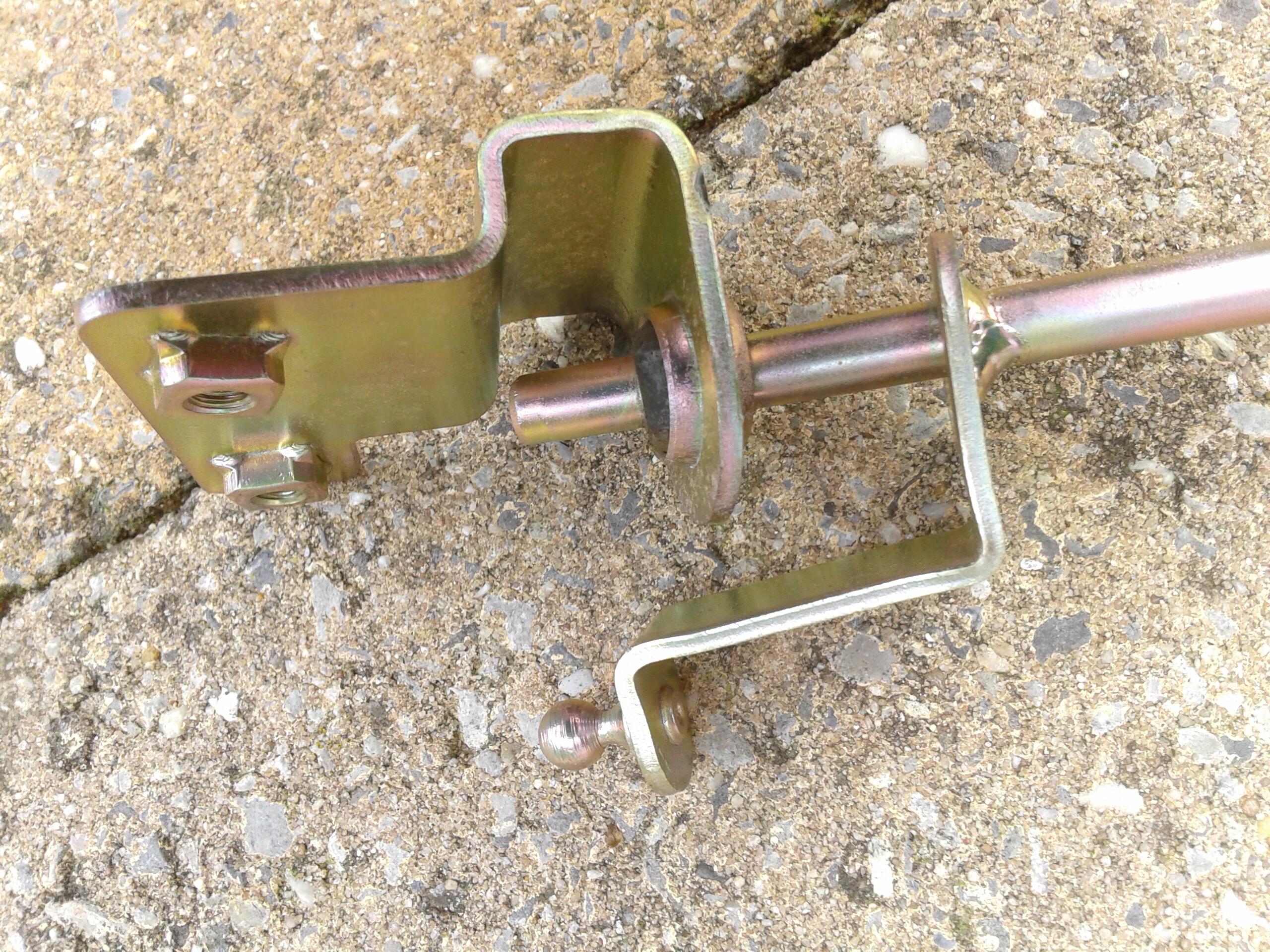

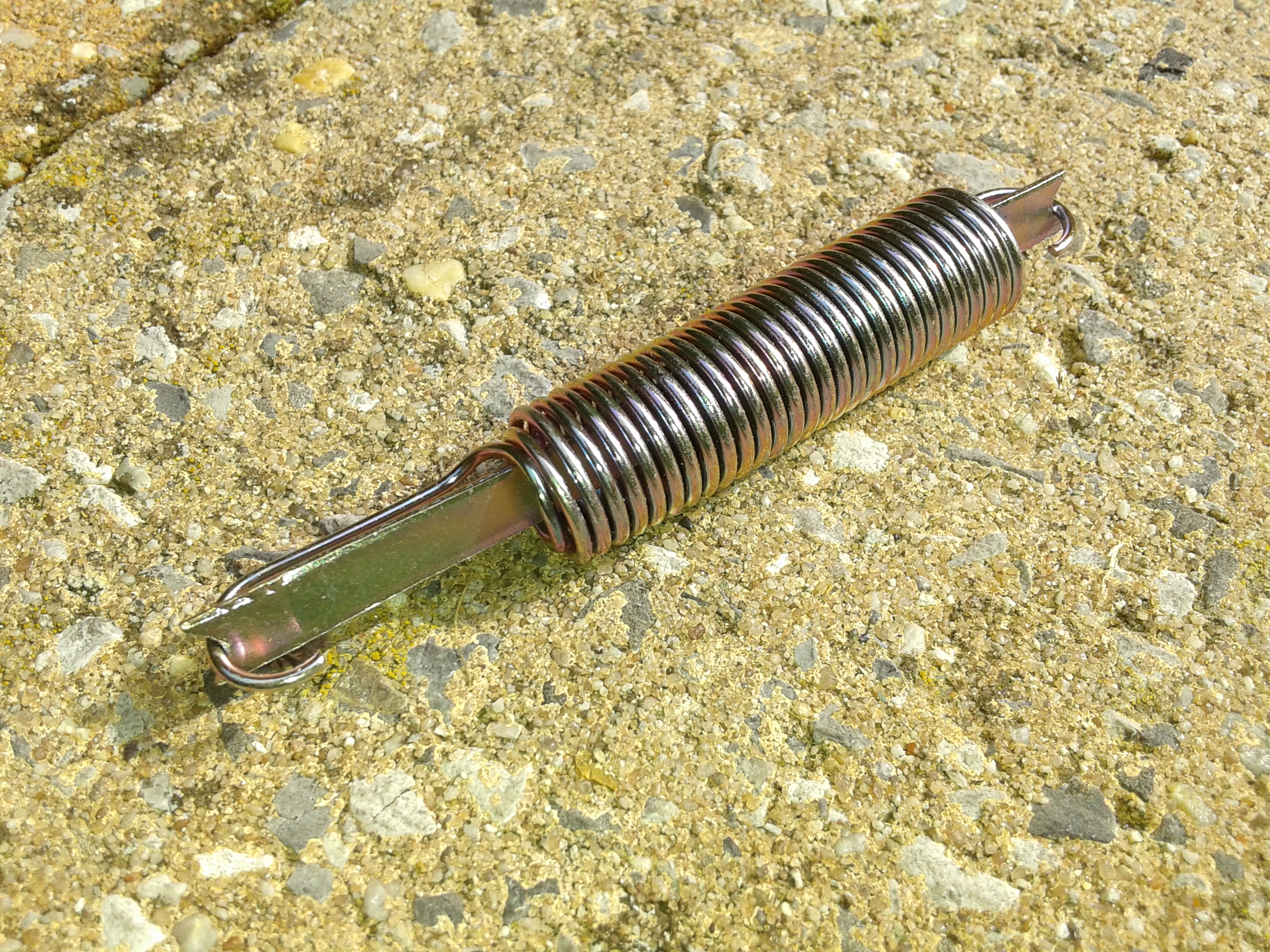

Tip.. put a small steel strip in the springs.. now you get a nice perfect passified part..

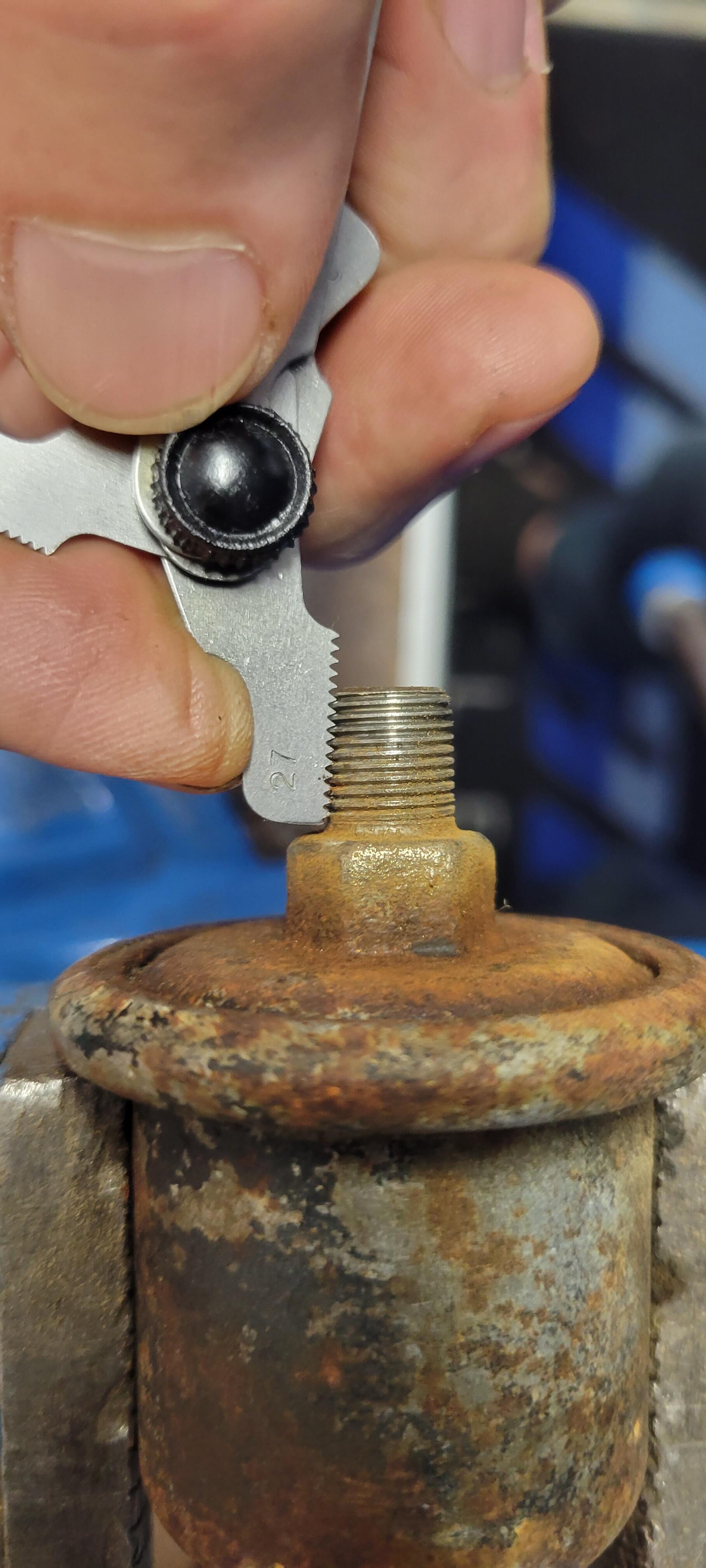

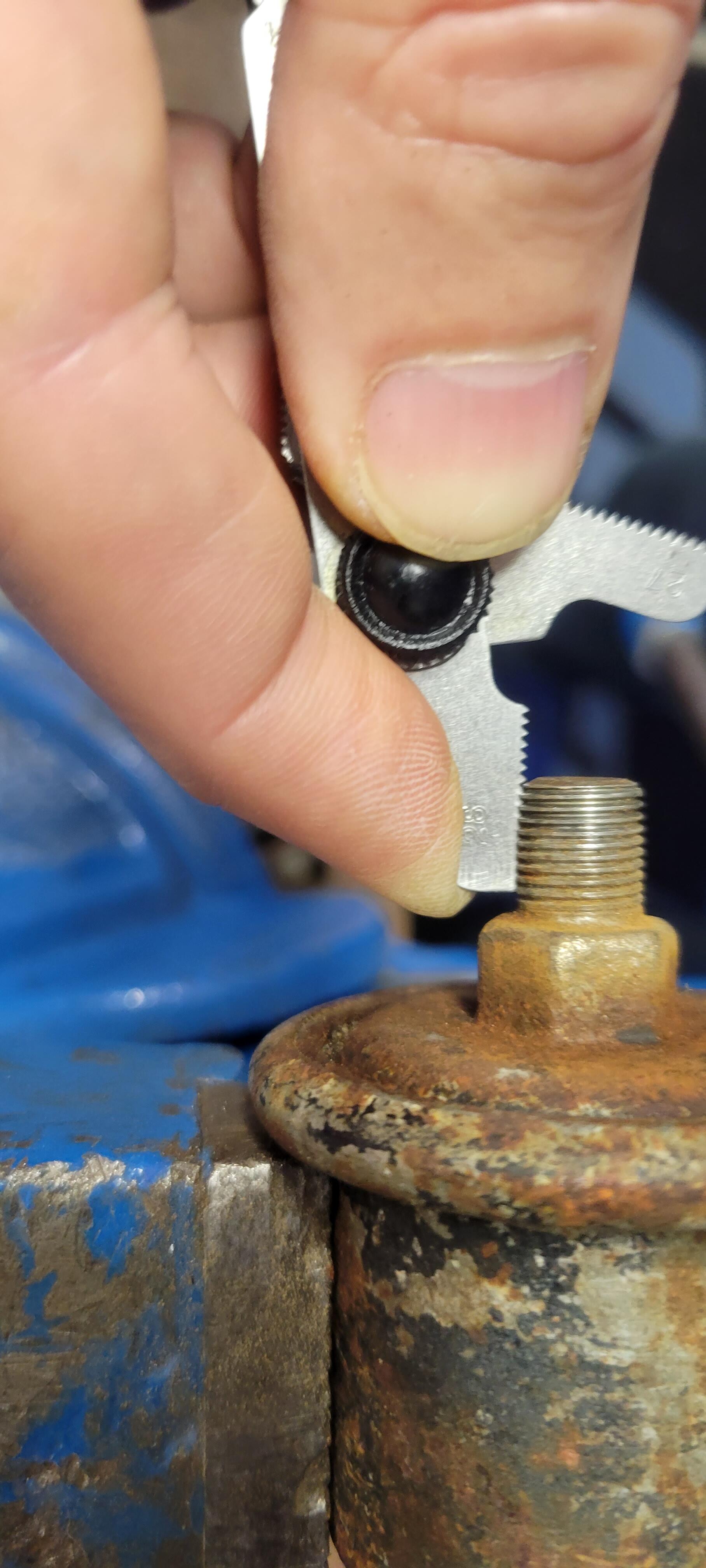

Actually the OEM oil pressure sending units used by Nissan are 1/8"-28 BSPT, not 1/8"-27 NPT. If your Beck-Arnley was 1/8"-27 NPT that would explain why it would not screw in easily. Here are pictures fitting my thread pitch gage into an old OE sending unit I have, The 28 threads per inch gage fits well (first pic) and the 27 did not.
In addition to thread pitch differences, the NPT thread also has a slightly larger nominal male thread diameter. the chart below is from Swagelok, BSPT is also known as ISO 7/1
Edited by CanTechZ
AND... as it's thread is tapered, you don't need to screw it all the way in.. as a matter a fact about half way is enough and some tape (PTFE) is a good insurance that you don't brake it.
