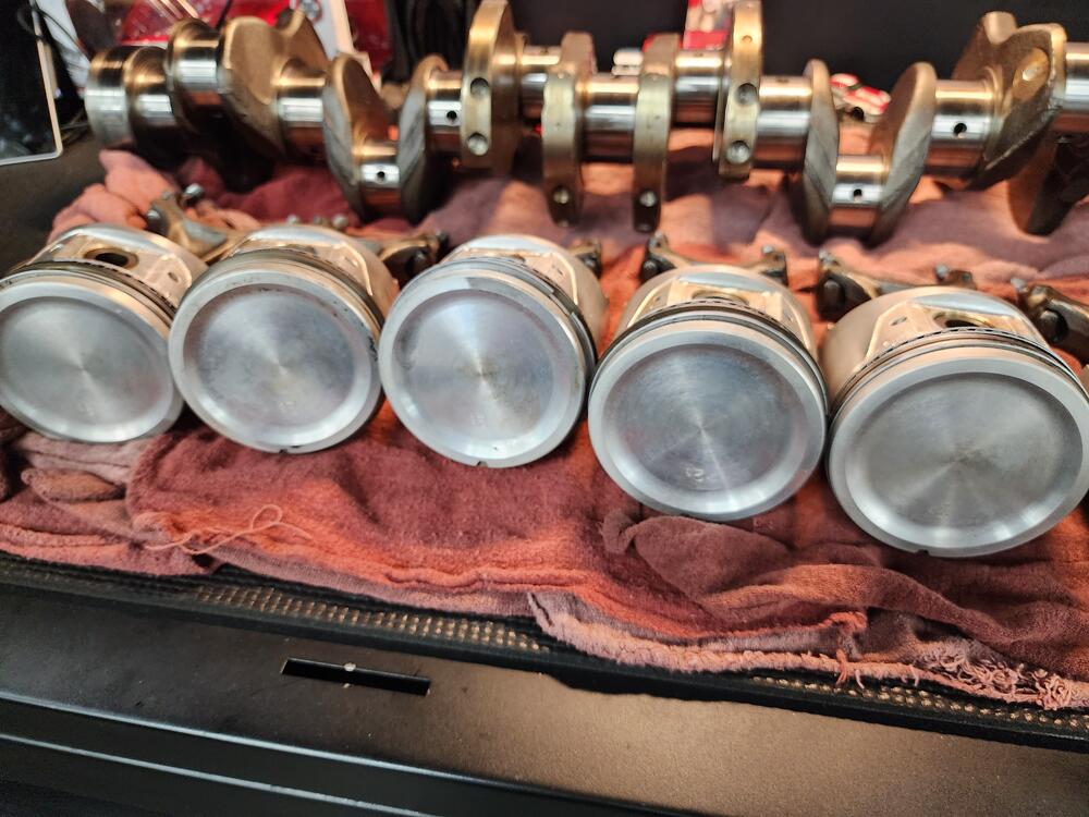

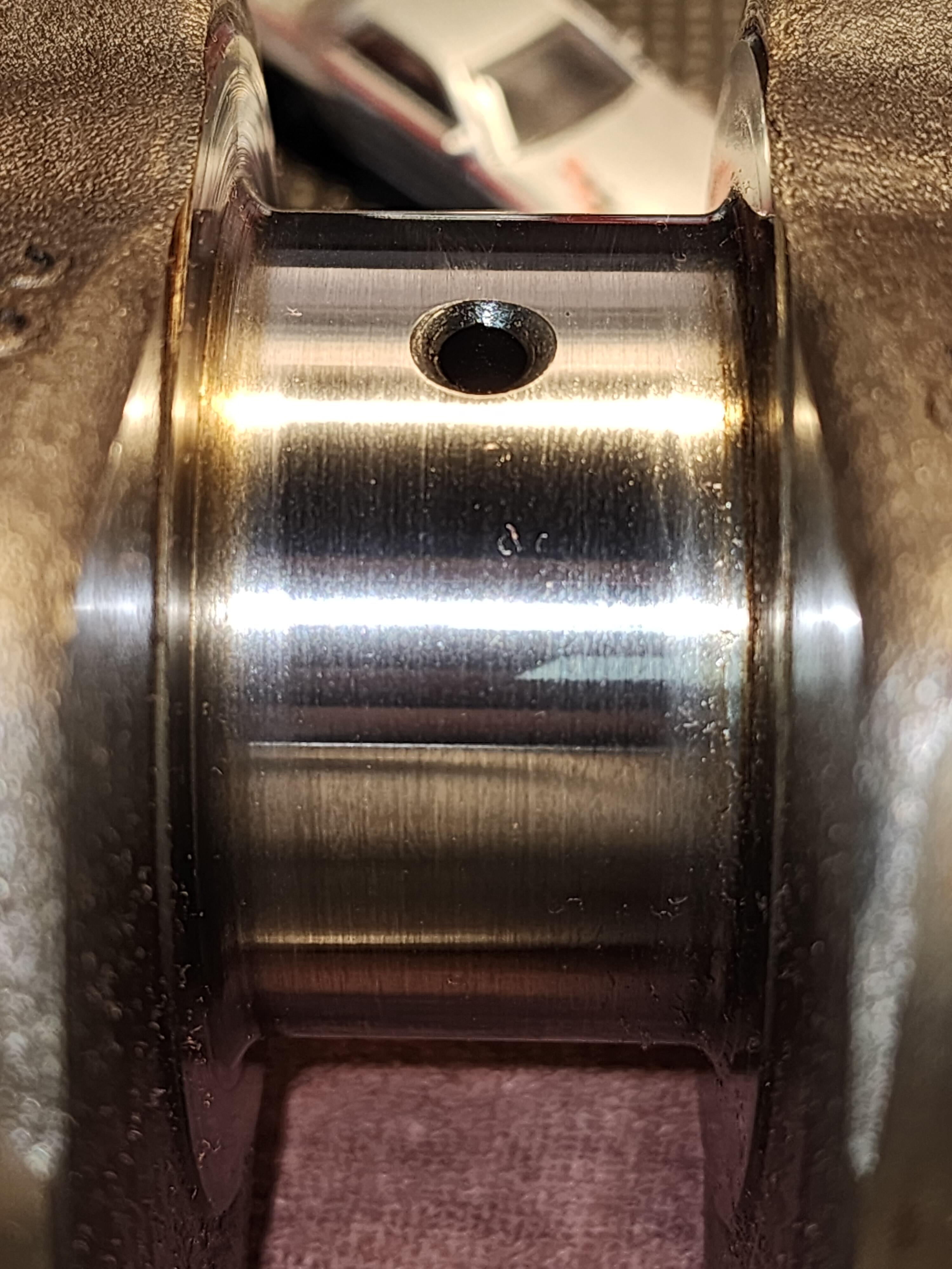

Just wanted to get back to you guys with some pictures. I went ahead and removed the pistons and cleaned them up. Crank looked pretty good overall. Went ahead and polished the crank by hand and looked even better, zero scoring that can be felt with the finger nail or thin plastic gauge. For the most part the journals seem to be even based on how my co worker measured it.

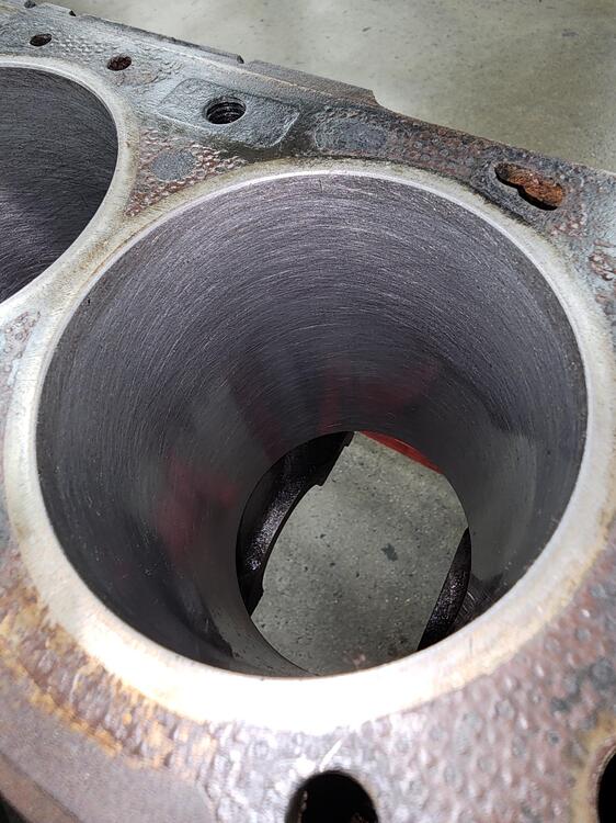

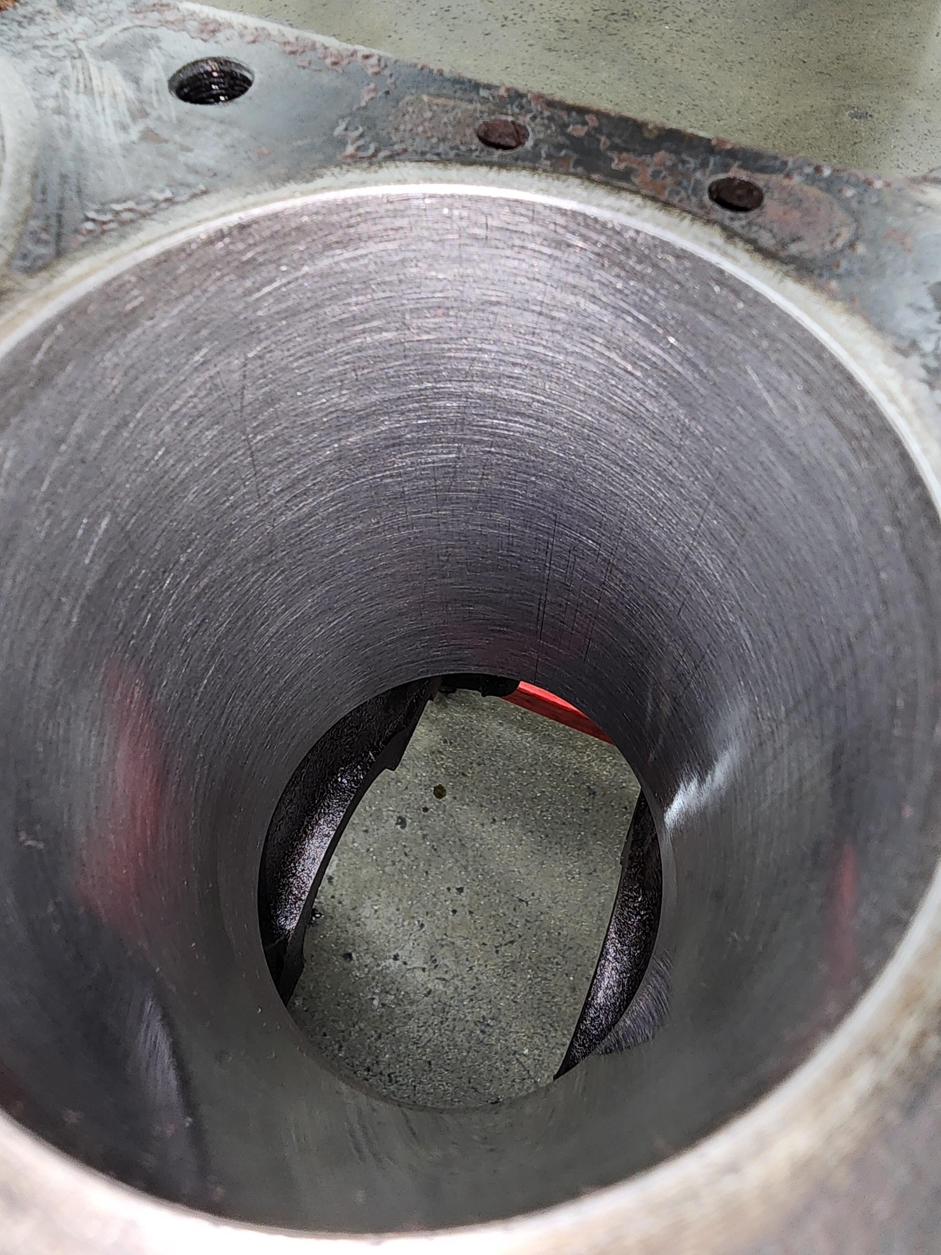

Cylinder walls my co worker went ahead and honed it and if you ask me looks very good. Measured the bores and they are still at a perfect 86mm like when I measured before the hone. Going to take to a machine shop in a week or two to have them clean up and do some fiber measurements.

Did you guys use a ball hone?  Looks scrapey.  The angle seems shallow like it wasn't moved up and down fast enough.  Not an expert.  You can still see the scratches.
Don't have the experience to say if it will seal well with the scratches but it doesn't look ideal.  I think that you're on the edge of "go cheap and hope" or spend the money and do it "right"?  If you have the means of tearing it down again easily, I'd probably just put some new rings in it and see what happens.  If you have limited space and time maybe you should spend the money and make sure it's right.  It's a dilemma.
Another way to describe it - if you like working on it do the rings and take a chance, if you like driving it spend the extra money on an overbore.

Yeah he used a ball hone. He went pretty dang fast if you ask me. I think a lot of it has to do with the camera making it look sharper than it really is because I see what you mean but in person looks different. Based on my eye though and trying to feel for scratches etc you can't feel anything.
For now I'm going to take the chance with new rings, bearings etc and see how the car performs. Worst that can happen is I burn oil and have to pull engine again which I'm okay with. $3500-$4000 is a lot compared to $300 and for the price difference I'm willing to sacrifice some time and extra work if need be.
The cross hatch angle should be around 30 degrees. I still see vertical scratches in the bores too. You mention the bores are still 86mm. What is the difference, from a measurment inline with the crank, and at 90 degrees to it? Be sure to also measure near the top, halfway down, and at the bottom of the stroke. You will find a difference, in diameters, and at each of the three locations from top to bottom. There is a specification for the amount of elongation of the diameter, and the taper from top to bottom. Check the service manual.
The cylinder block deck still looks pretty rough, and would need cleaned up prior to installing the cylinder head. Have you measured it for flatness? I believe the allowance is something like 0.003".

As for the crank.. it can be as shiney as a new chrome part, but that tells me nothing. Use a micrometer to test it. And look in a service man. what it should be.. (And you have a good chance you find out that the crank also needs a new surface and new bearings.)
