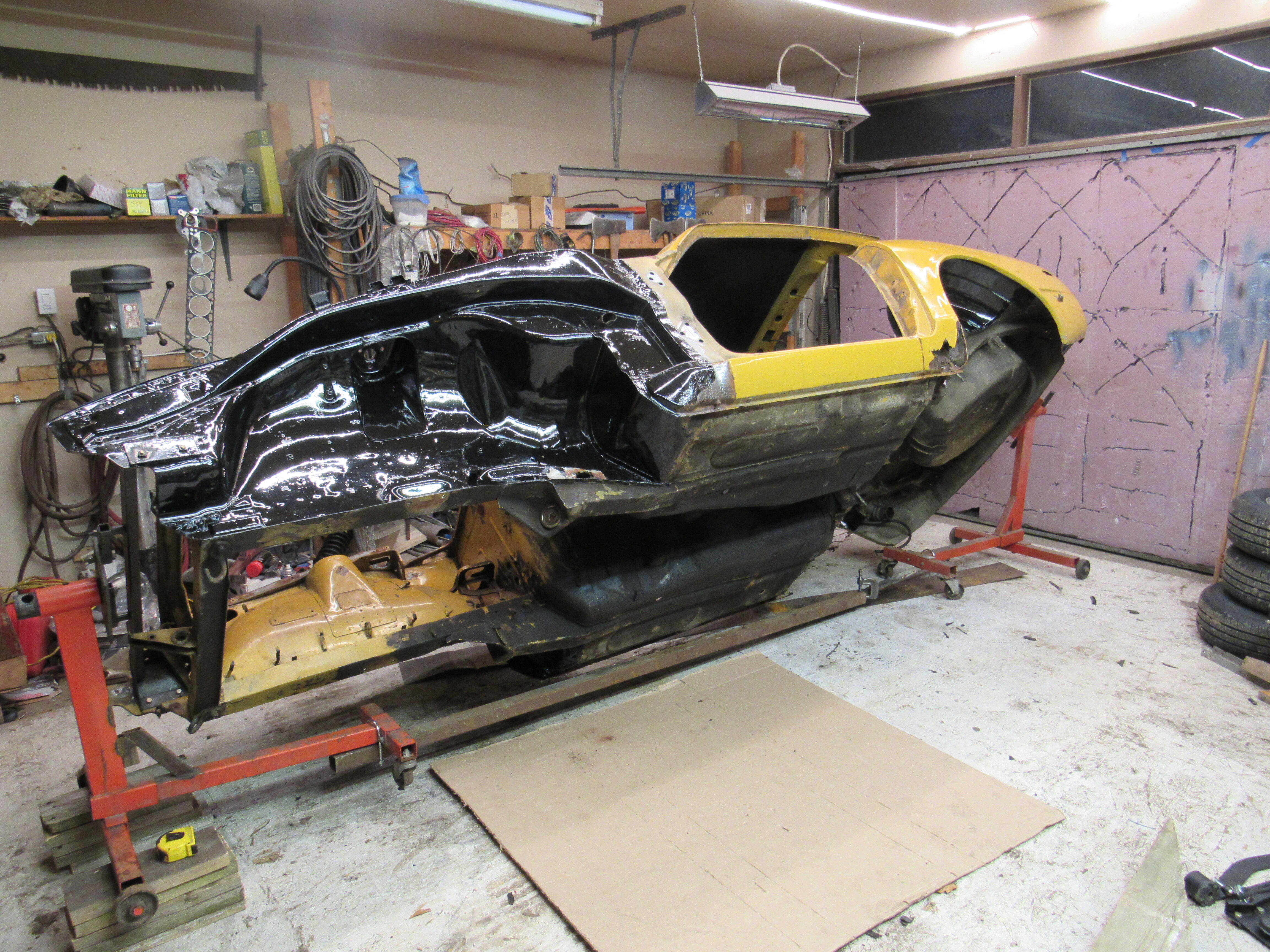

Well she's up in the air, like an idiot I sold my good rotisserie last fall thinking I would never use it again.  So I had to dig out the old one, not very pretty but it works fine.

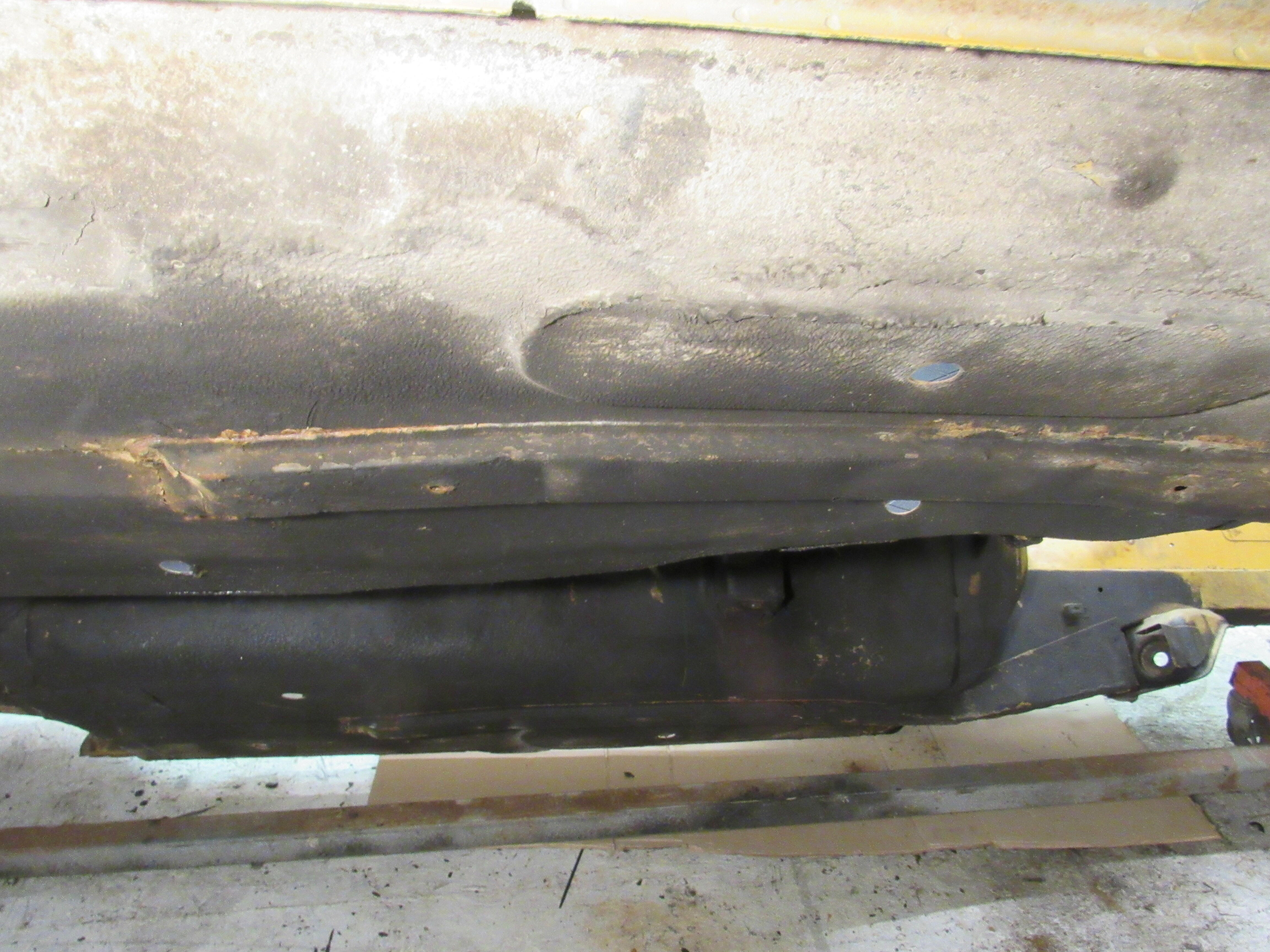

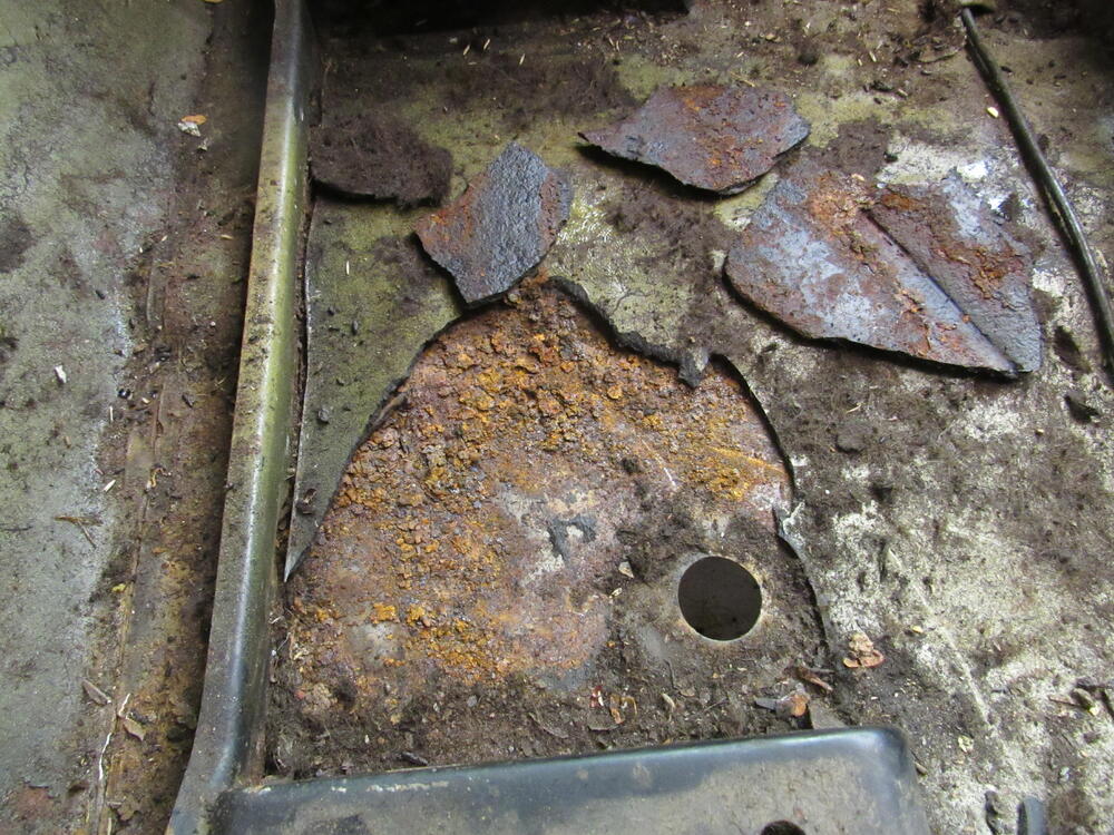

Someone jacked the car up in the middle or the floor pan, I have an anvil that I p/u and drop to correct those.

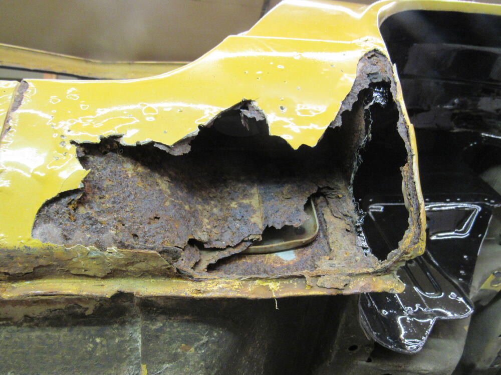

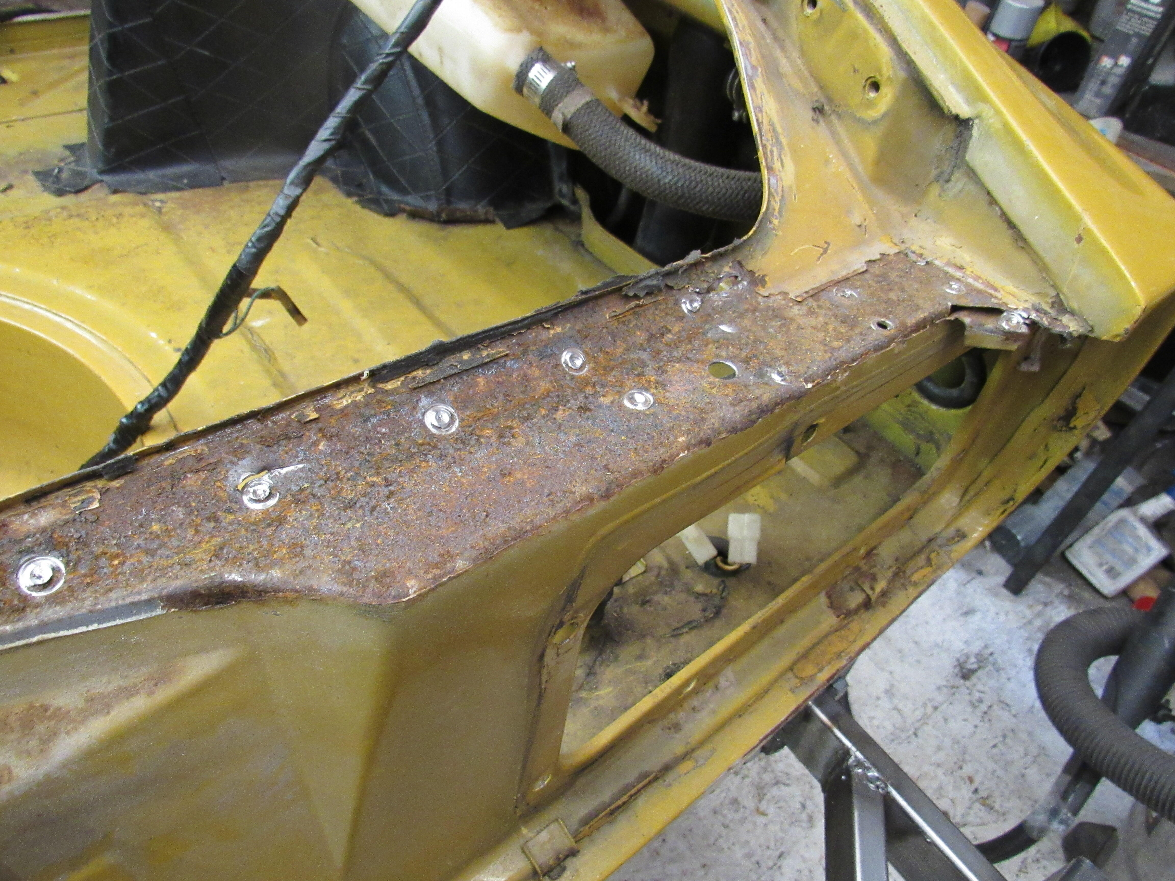

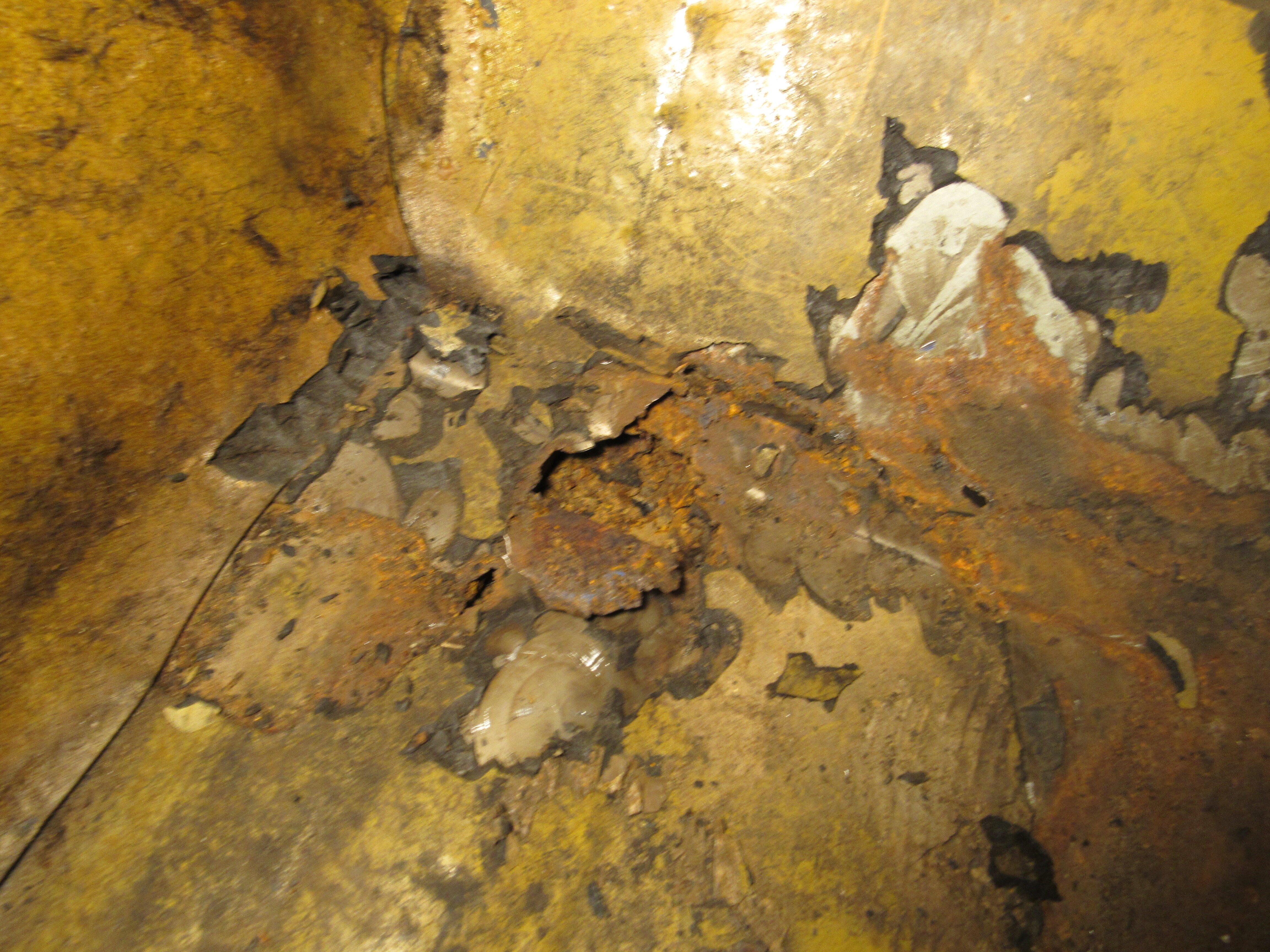

Some rust porn.

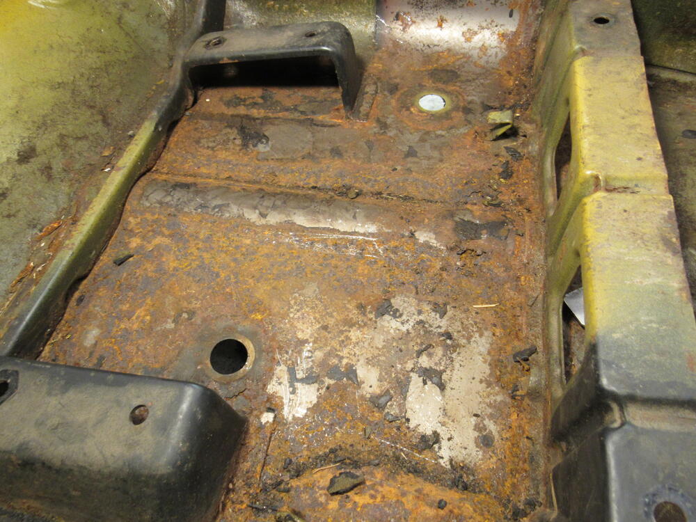

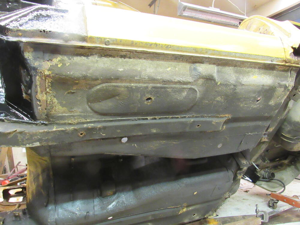

I started chipping away at the tar mat today, oh what fun<_<
I was hoping I could save the floor pans but they are too far gone, water was pooling and the rust is bad.

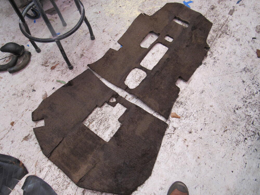

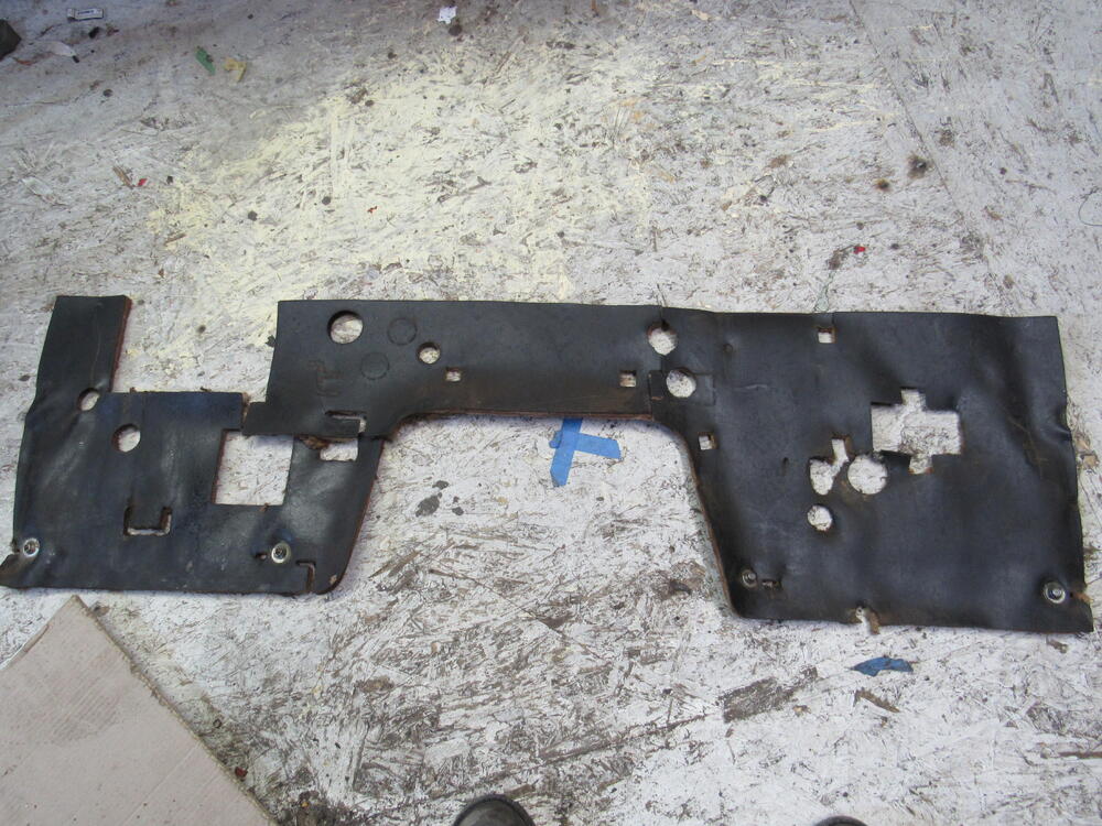

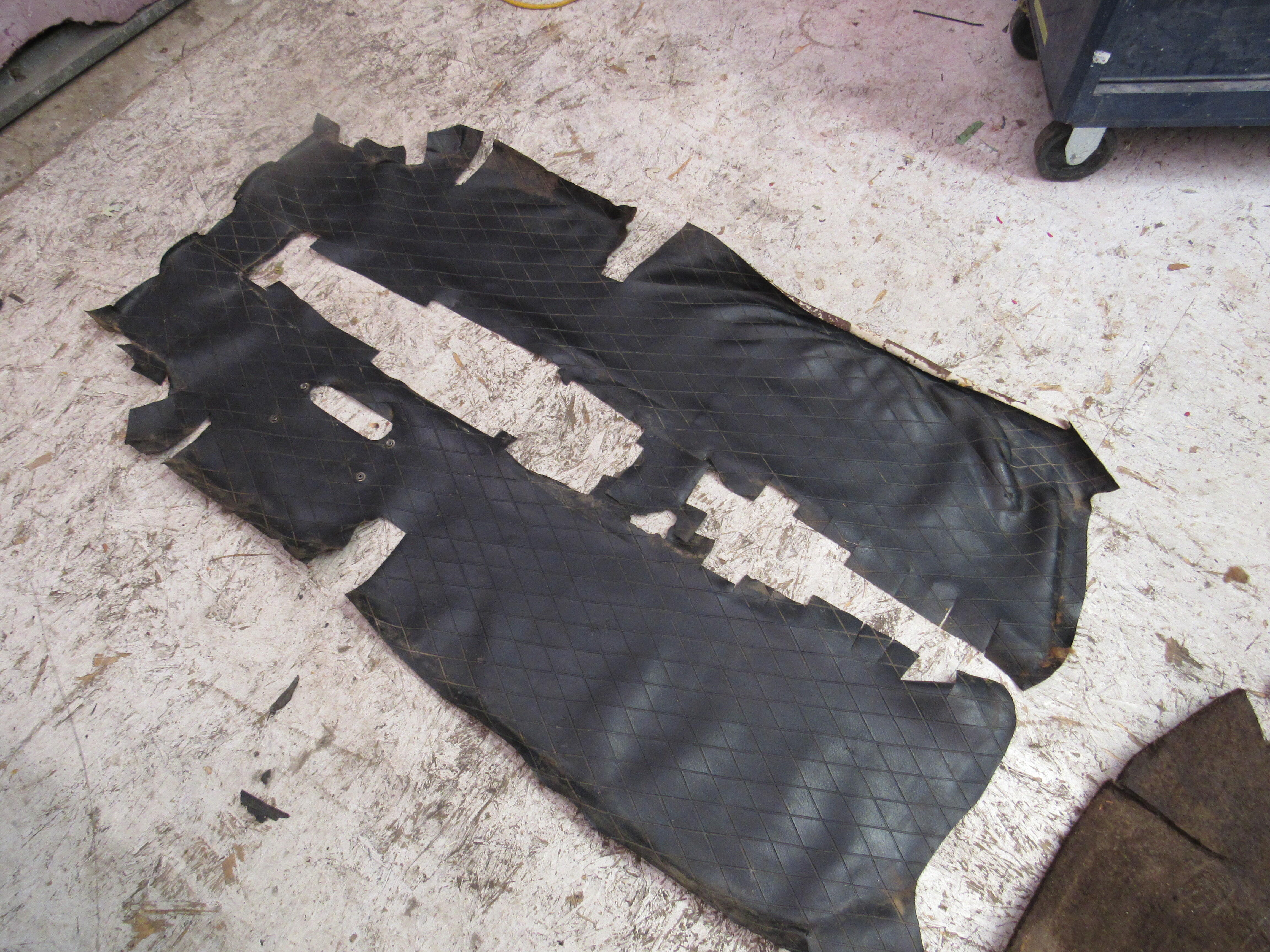

I manged to remove the firewall insulation, vinyl cover and original trans tunnel insulation and I can reuse all of them.

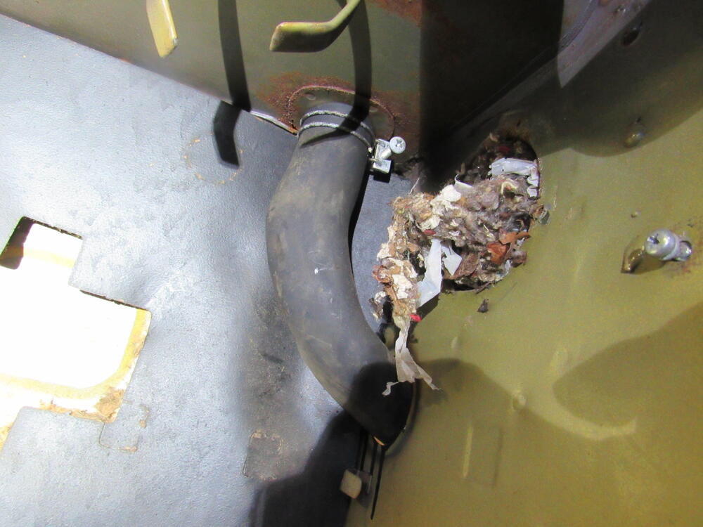

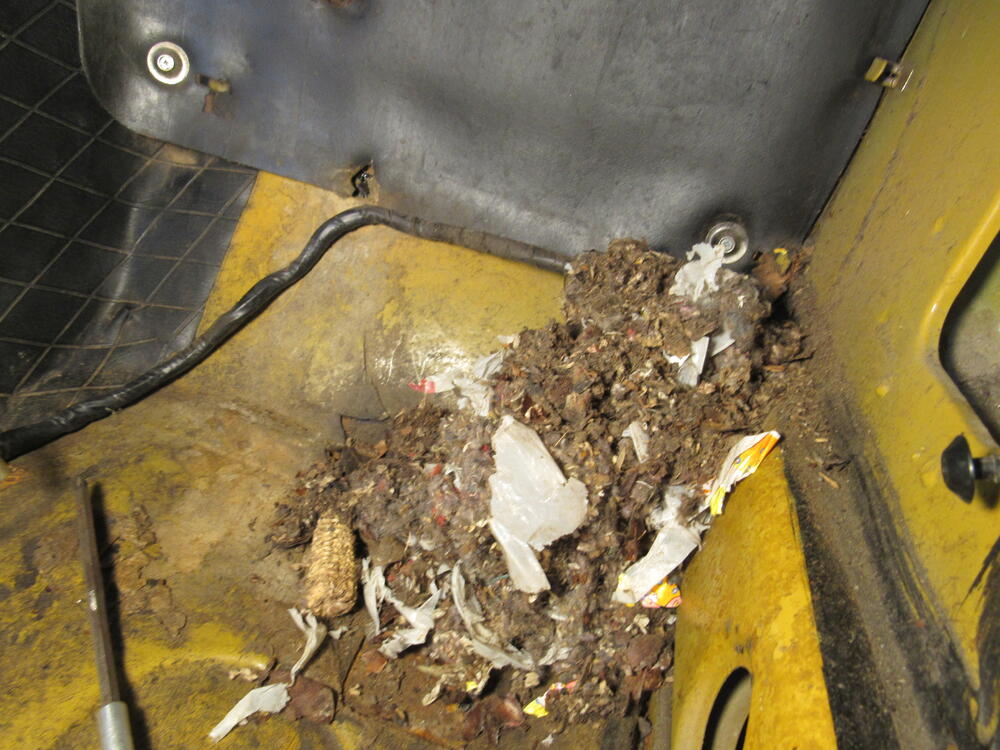

Also found another long term tenant, this was only half of what was came out, the rest I had to get by sticking the vacuum hose through the vent.

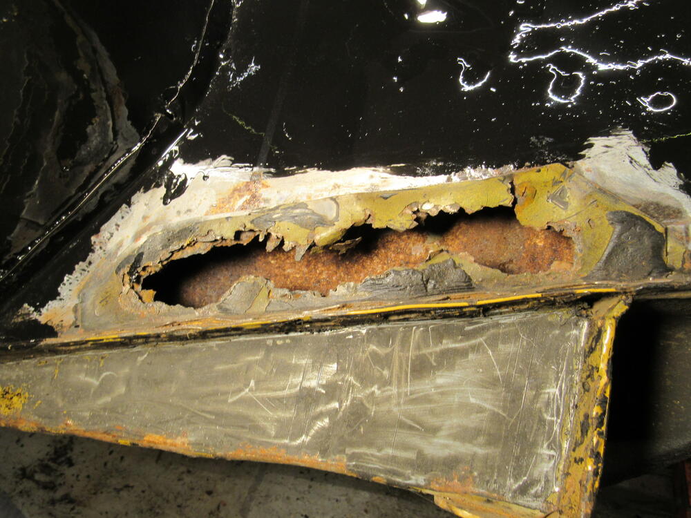

Dang. That layered rust is giving me PTSD. Even my X1/9 rot pales in comparison.
How do you get through all those layers without completely removing everything inside & out?

Sometimes, you have to do exactly that. Fortunately all of the metal panels are available now. That is a fairly recent phenomenon. That makes this repair a lot more manageable. The real problem is you have to sequence the work and be careful to get the car back together straight.

The tail light panel looks pretty rough on top...
Luckily, KF Vintage makes the exact replacement sections, https://kfvintagejdm.com/shop/datsun/under-slam-panel-repair-section-left-side-datsun-240z/

Patcon said it, like an archaeologist you have to remove the first layer, second layer and just keep cutting back until you reach clean metal . If it's real bad you just remove the whole piece but something so localized like that area I'll use the back of the rocker panel, the dog leg panel and probably a piece of the inside rocker.
I'll post pics as I cut through.
  1. Can you talk a bit a bout your 'chipping' technique.  Did you use dry ice, for example?
  2. What's your approach for drilling out spot welds and peeling the layers part?
  3. Is that a corn cob that came out of the air vent?
