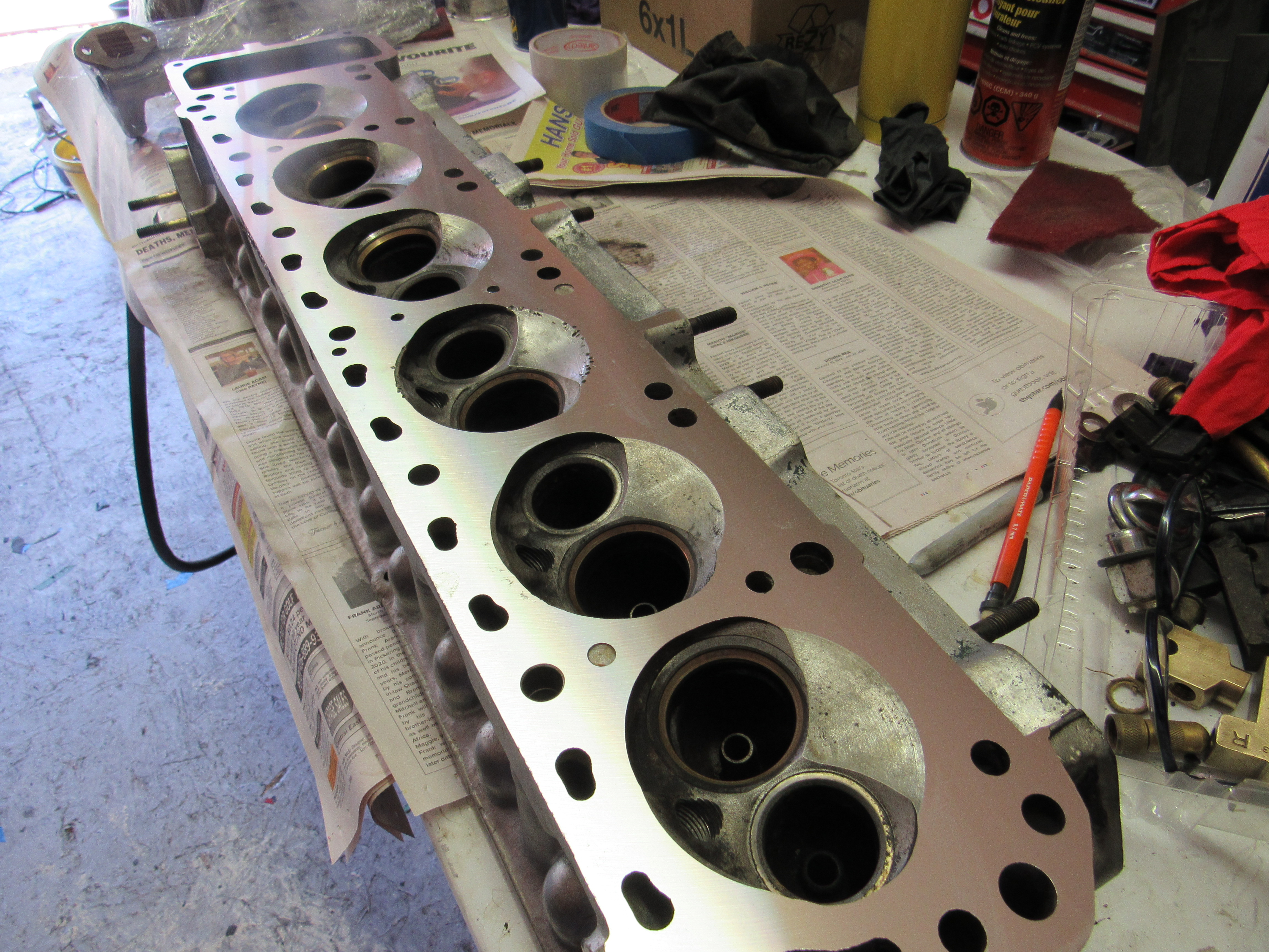

Here’s a pic of known FOD . This was done by a small bee bee of weld that found its way in the intake and got sucked in the engine - it’s a long story . That head is still in use on my 3.2 stroker
Are you going to do anything to the head ? New seats , bigger exhaust valve, unshroud the valve areas.

So was this head worked previously ? Are those steel seats ?

There is lots of stuff I'd like to do.😀   The valves are in good shape and so are the guides, also Dave would like to avoid mission creep, he is looking for a weekend driver that is as close to stock as is cost effective, gotta stay in budget.

If those are original seats I wouldn’t skip that step . I doubt they are steel . You’ll really have some dings if one of those let loose .

How noisy was the debris in the cylinder?
For a split second on start up . I had been welding dirty steel on my work bench and the head was also on the bench . One of those molten BB’s must have danced right into the port opening . Some more had burned themselves into the side of the port that I found later . That’s how I figured out what happened . It did take a while if scratching my head . What made it more strange was I had a rod bearing go on that engine . They issues were not related

Might want to check how close those dings are to the fire ring on the HG - they look close
