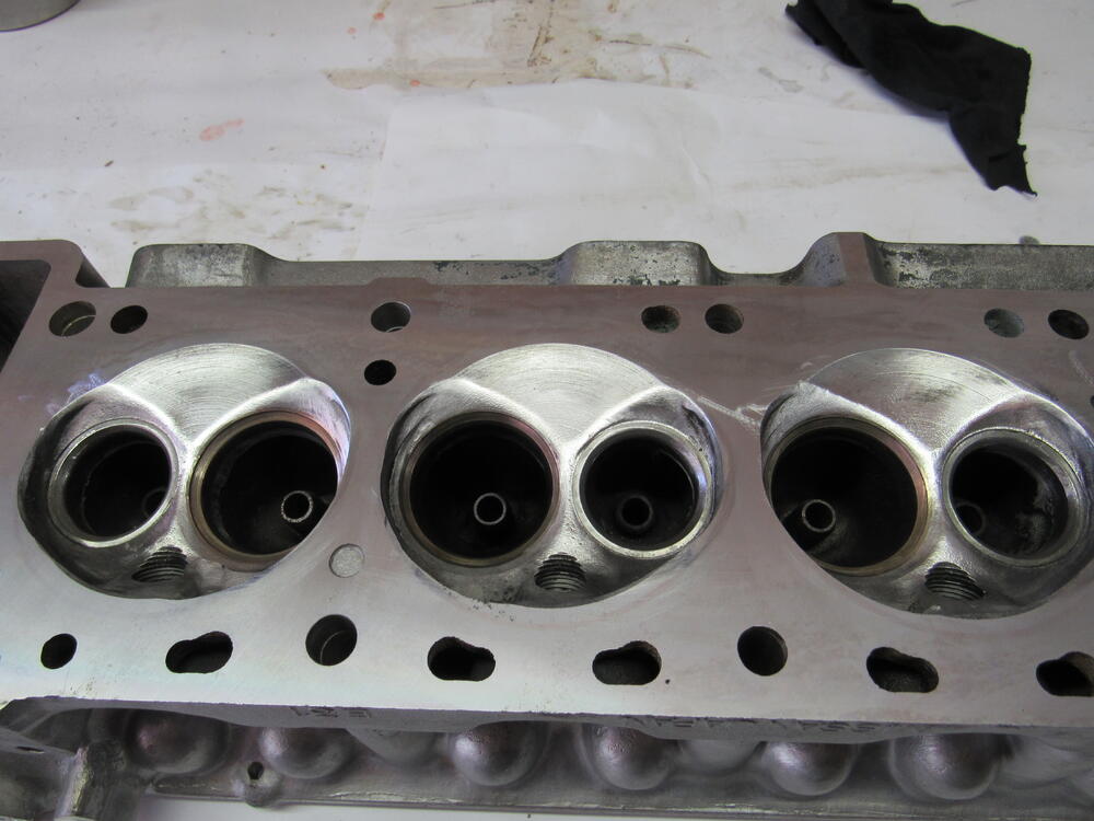

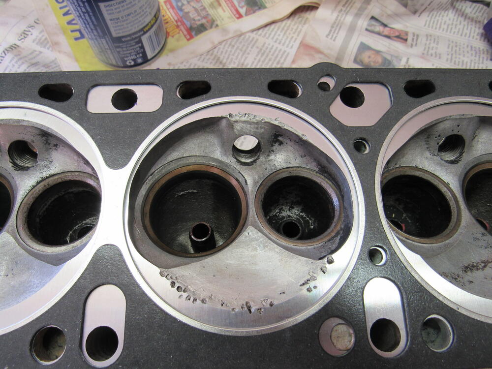

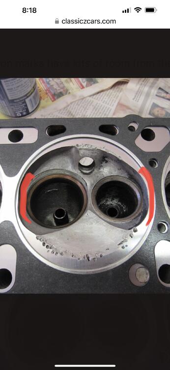

Those detonation marks have lots of room from the fire ring.

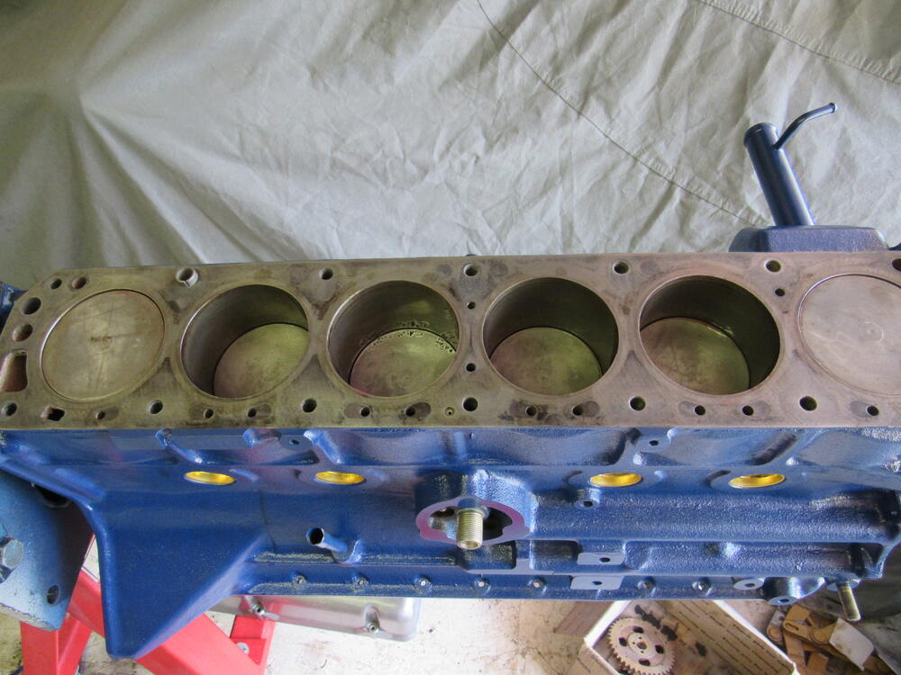

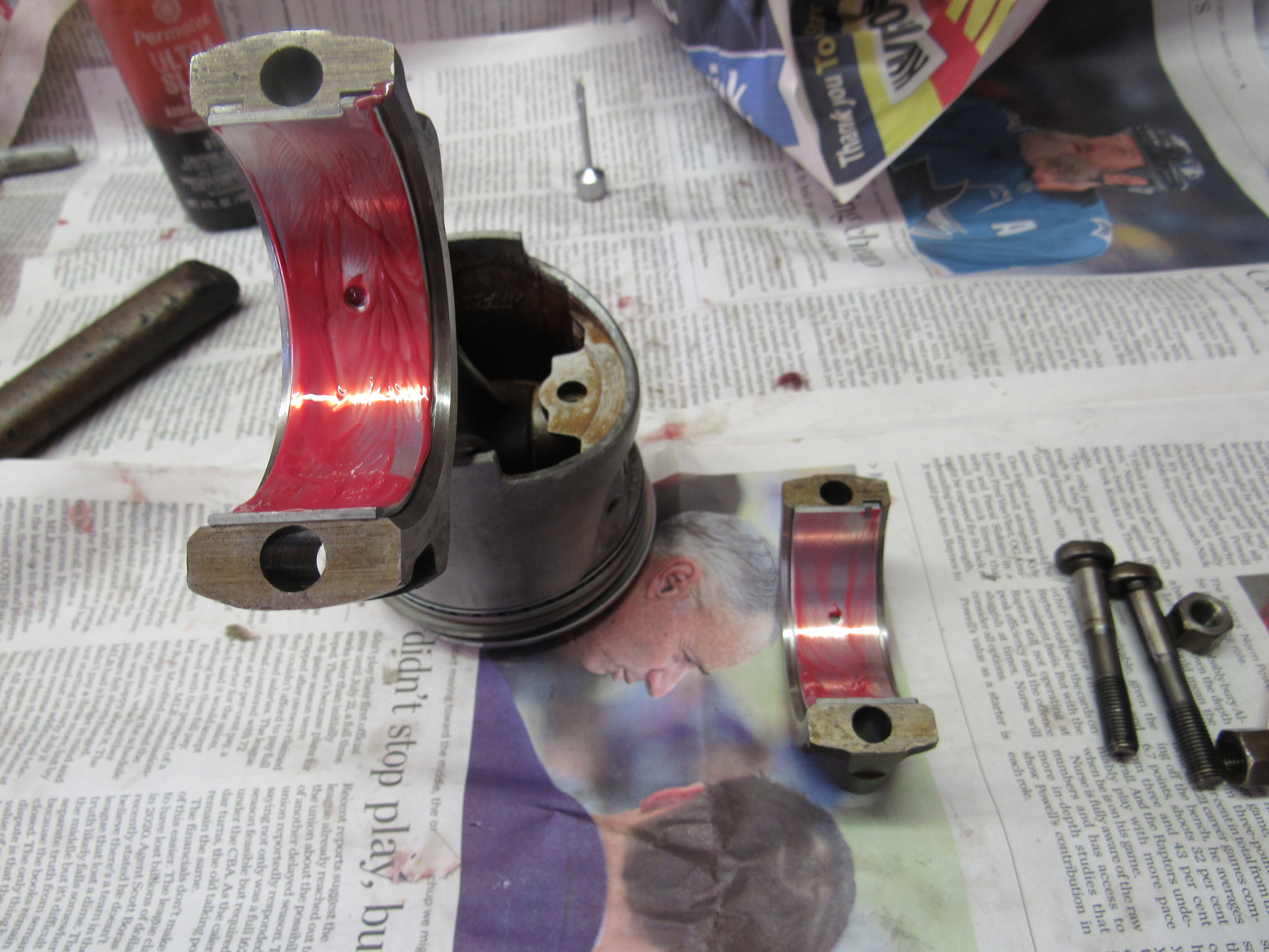

Just a few shots of the block assembly, 3rd pic down is the #6 piston going back in, next to it is the knuckle cutter, also know as a ring compressor.

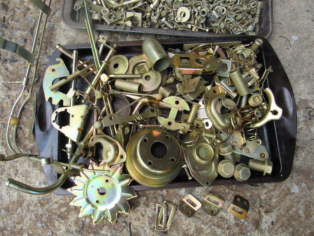

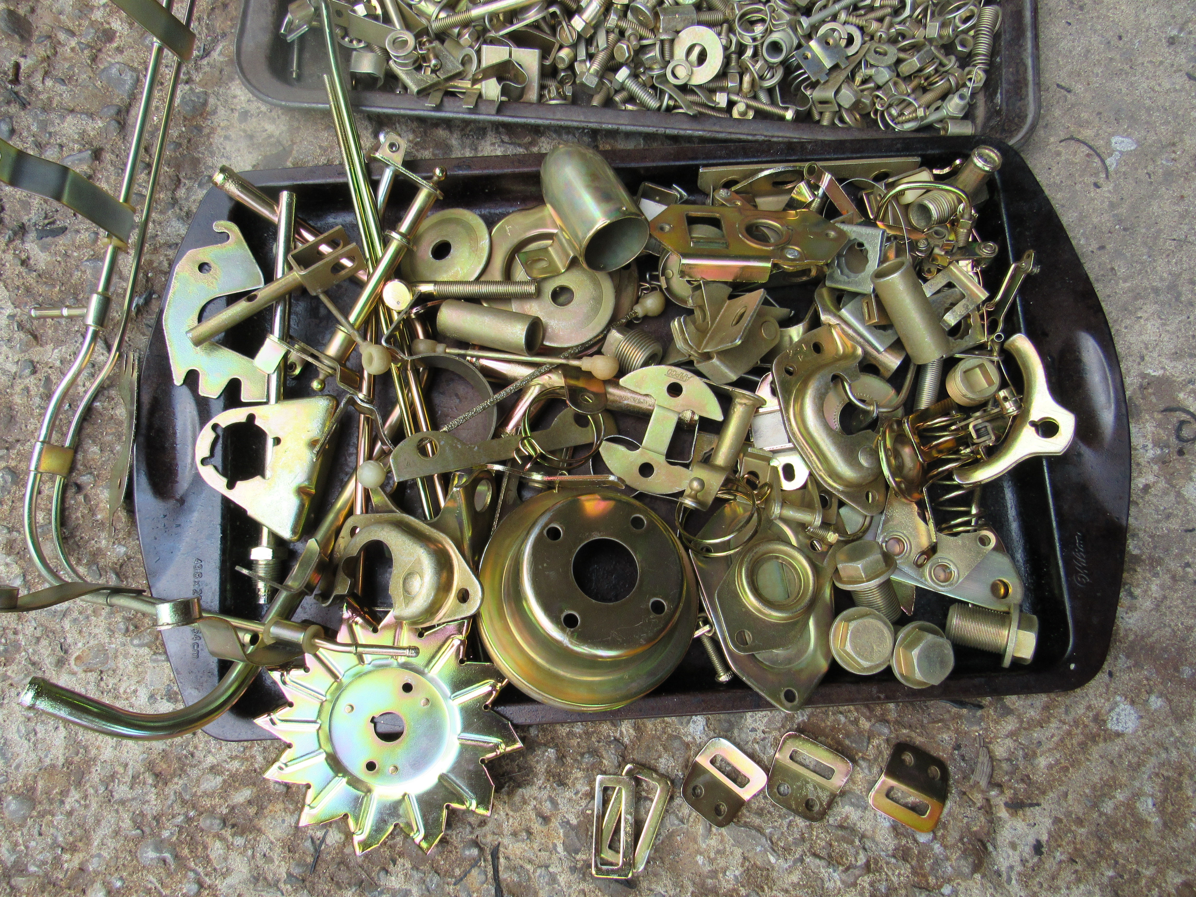

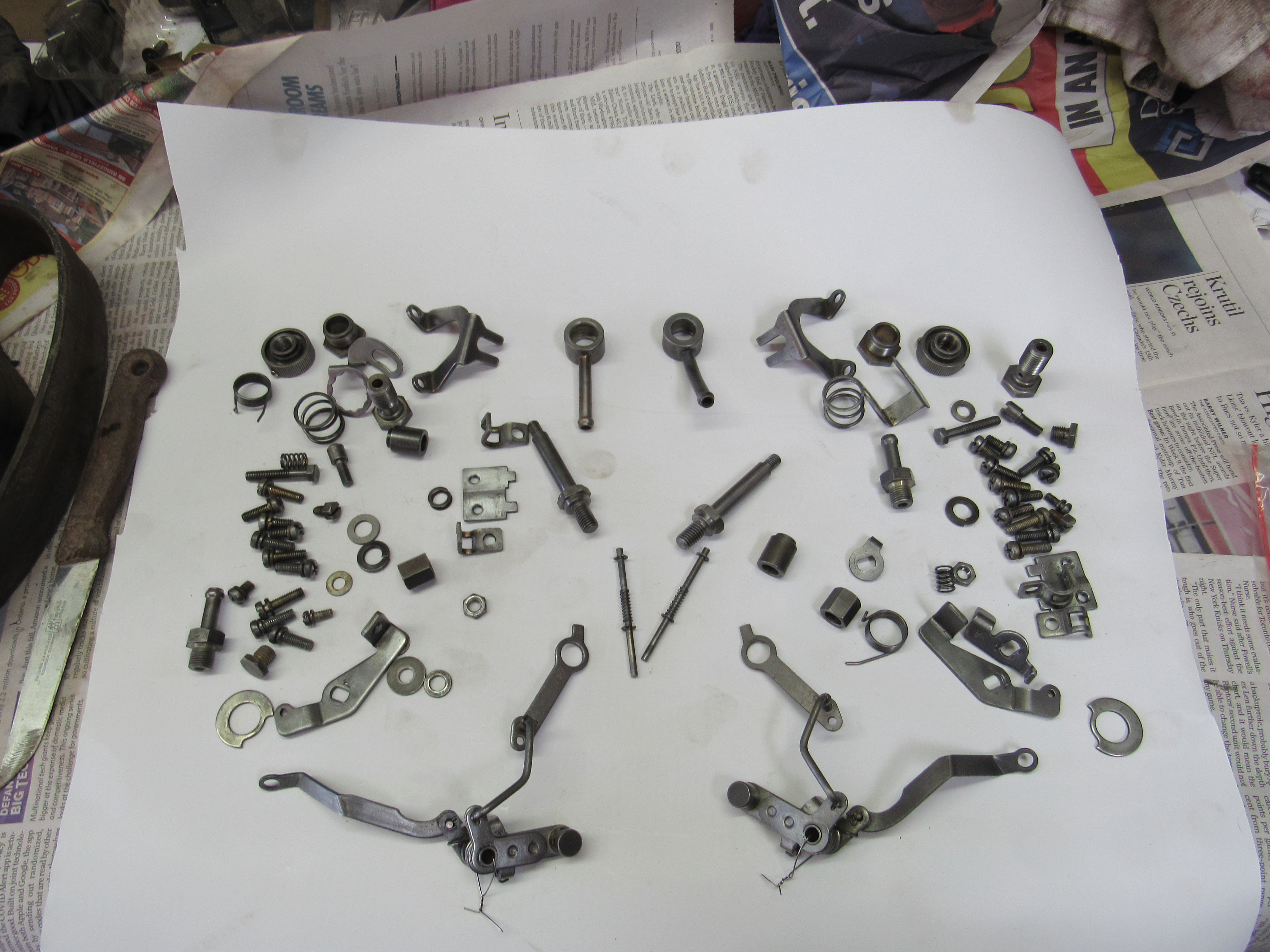

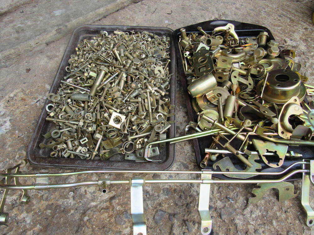

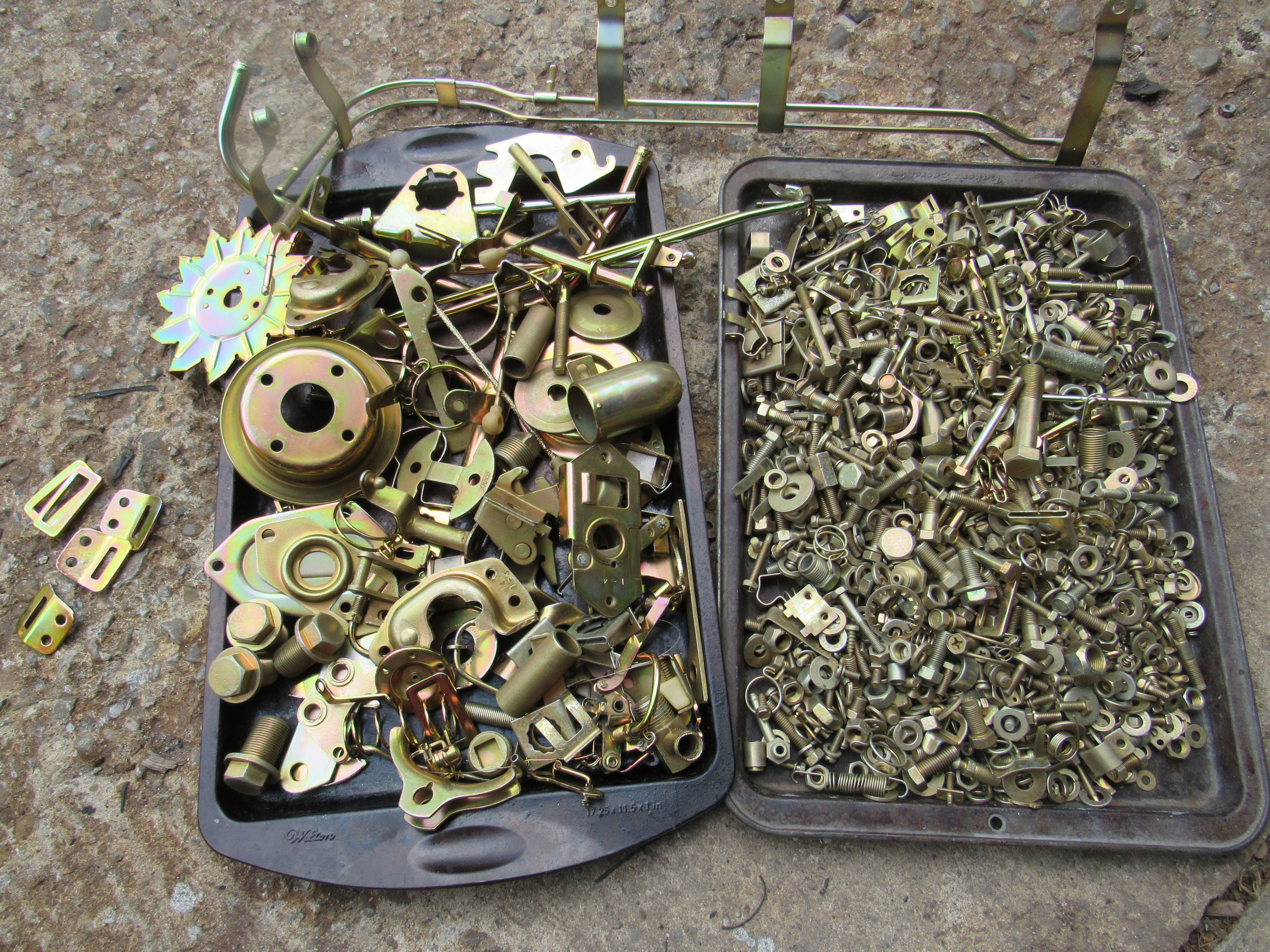

I hated throwing all the duplicated SU parts in to the plating bucket but I had to or it would cost twice as much, here's my map to sort them out afterwards. Plating is going in on Monday.

Yes - you have tons of room away from the detonation holes . I would unshroud those chambers . That engine will breathe much better and it’s easy to do .
1” drum sander with 80 grit is about ideal. You can use that on the chambers and on the block to clearance everything.

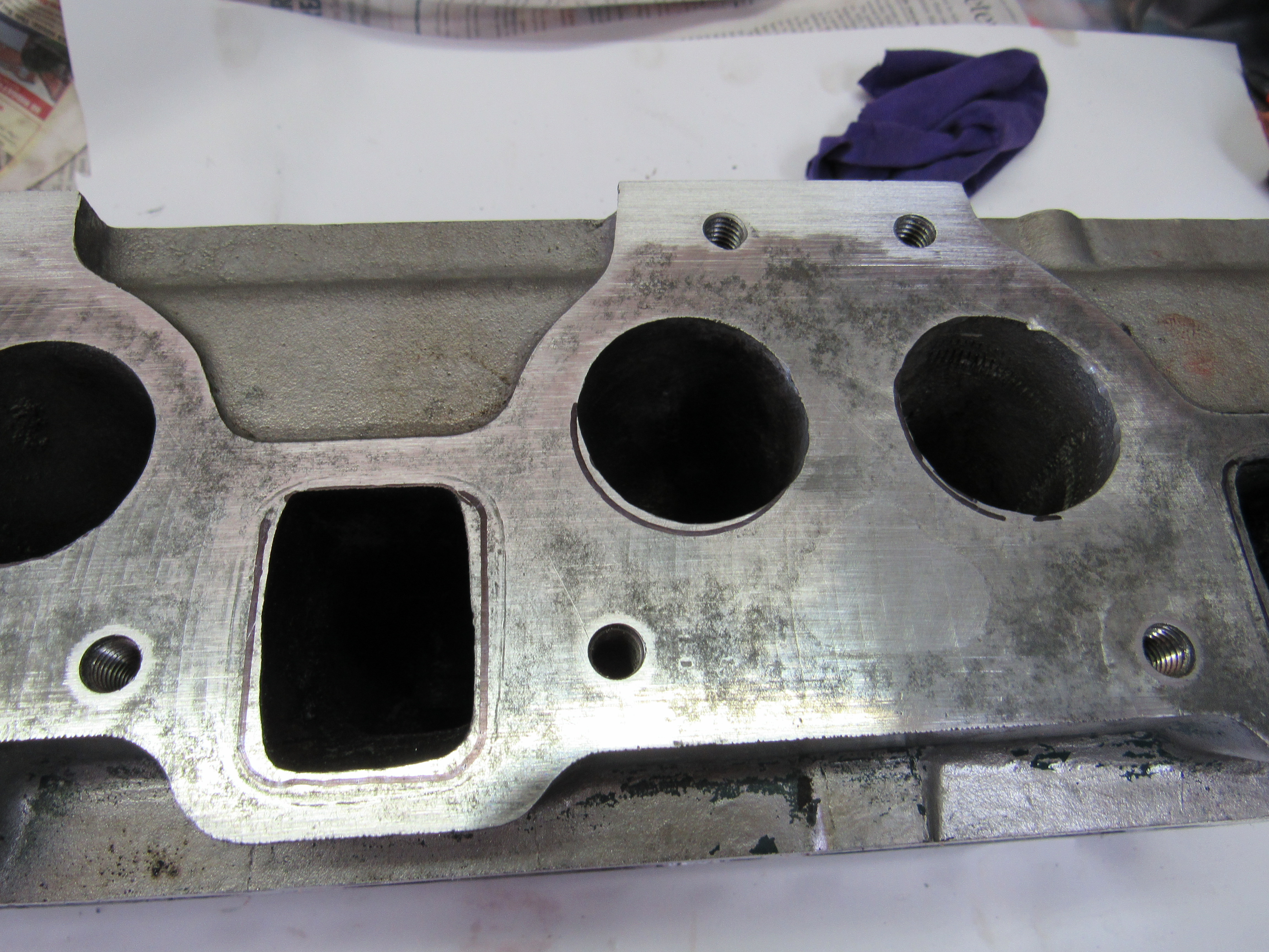

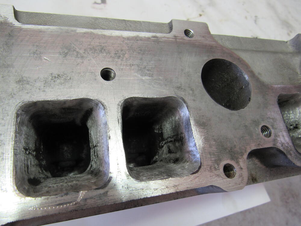

Now this isn't anywhere near a proper port n polish but I thought I would smooth out the combustion chamber since the seats are coming out anyway, opened up the exhaust runners a bit so at least the ports match better. Still have to grind down the fresh air pipes in the manifold.  Also clearenced the cylinder walls for the new intake valves.
This car surprises me again and again how pristine most of the parts are, once you get the crud and minor rust off.

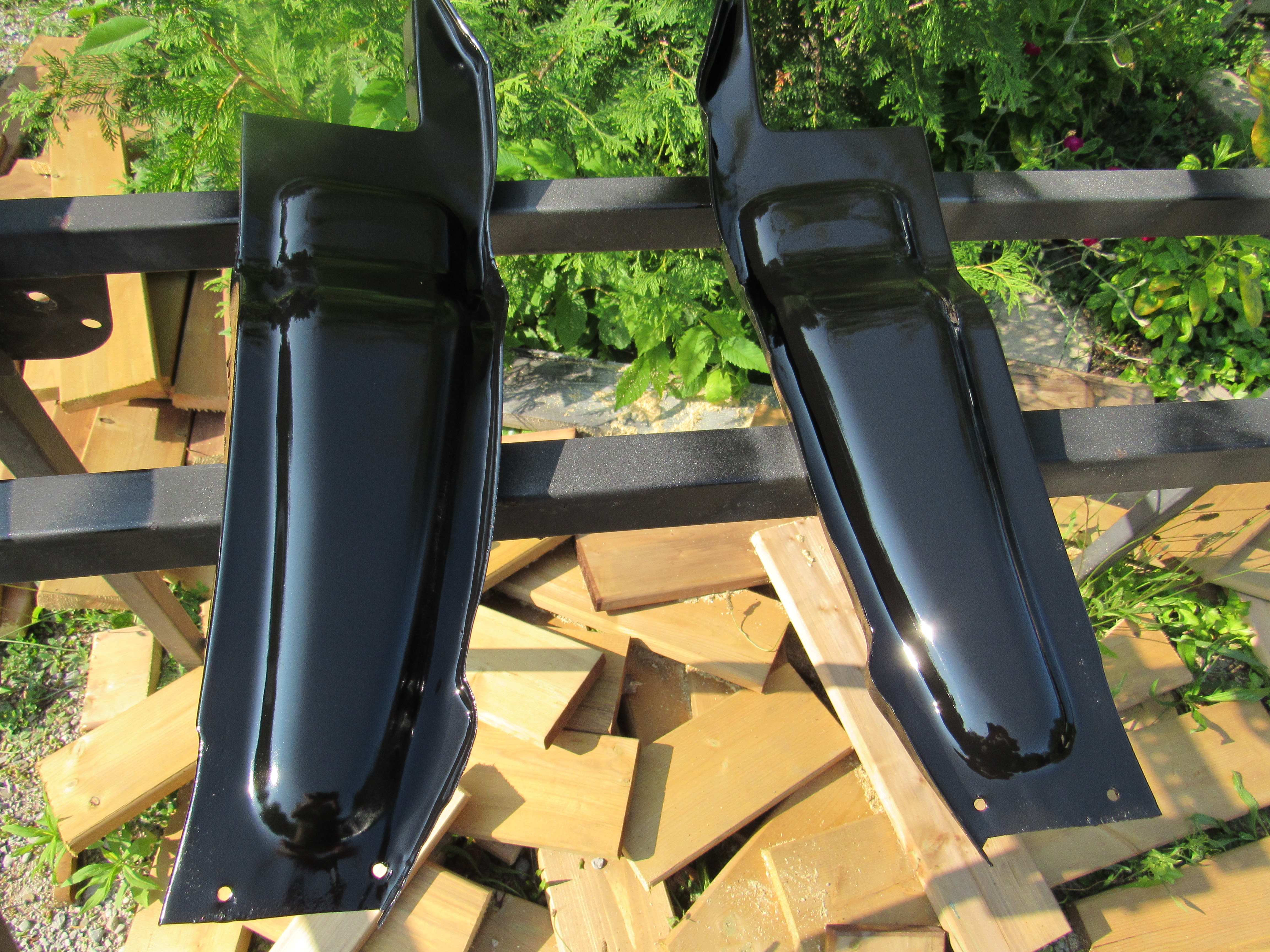

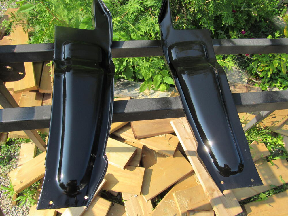

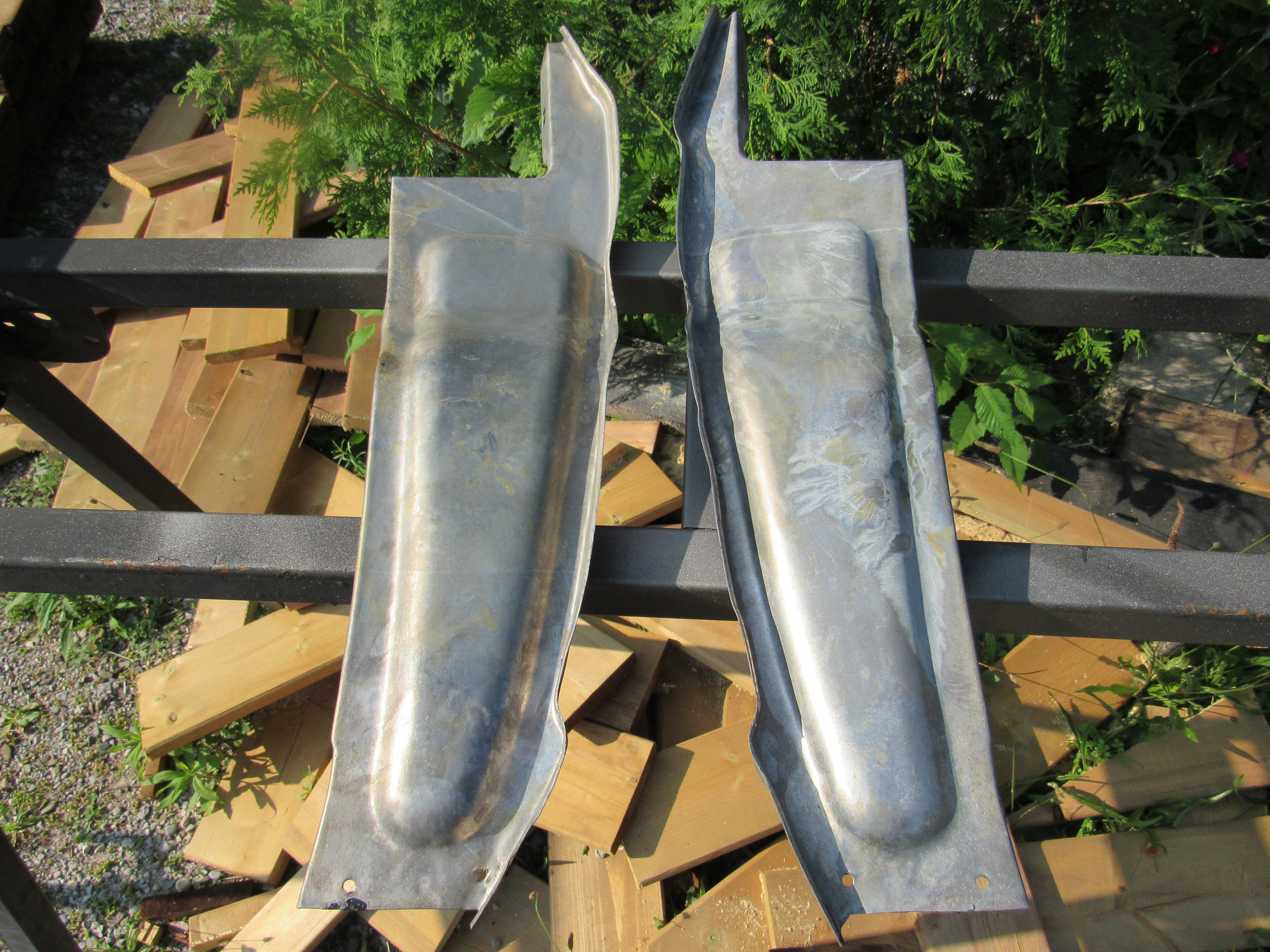

Looks like there are owls in my cylinder head. What did you use to clean off the fender supports (or whatever they're called)? I spent hours cleaning the dealer undercoating off the insides of the wheel wells. The metal underneath most of it was beautiful, but it was quite a job. I used everything I could think of, including kerosene, wire wheels, a heat gun and scraper, sandpaper, a grinder, etc.2b3b1d21c0ddf982b18657d071ccd22a.jpg

While you’re at it 🙂 - take your dremel tool with the biggest drum sander you have and clearance those areas I highlighted . Installing the larger exhaust valves will have a harder time breathing with the shrouding of the chamber . Etch a line from the HG and sand a nice radius to allow them valves to breathe . The engine will appreciate it .
Sent from my SM-S908W using Tapatalk
24hrs in a pan of Lye (sodium hydroxide) then a heat gun and a putty knife.  I call them mud guards as that's all they are really doing.
