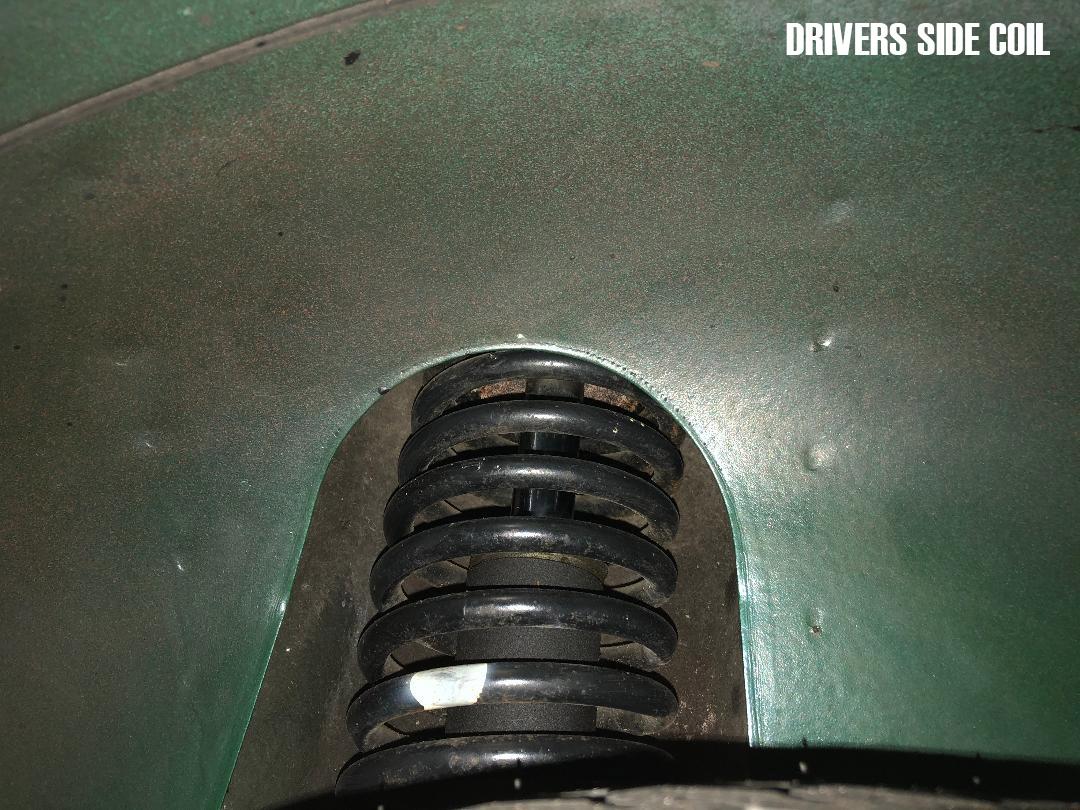

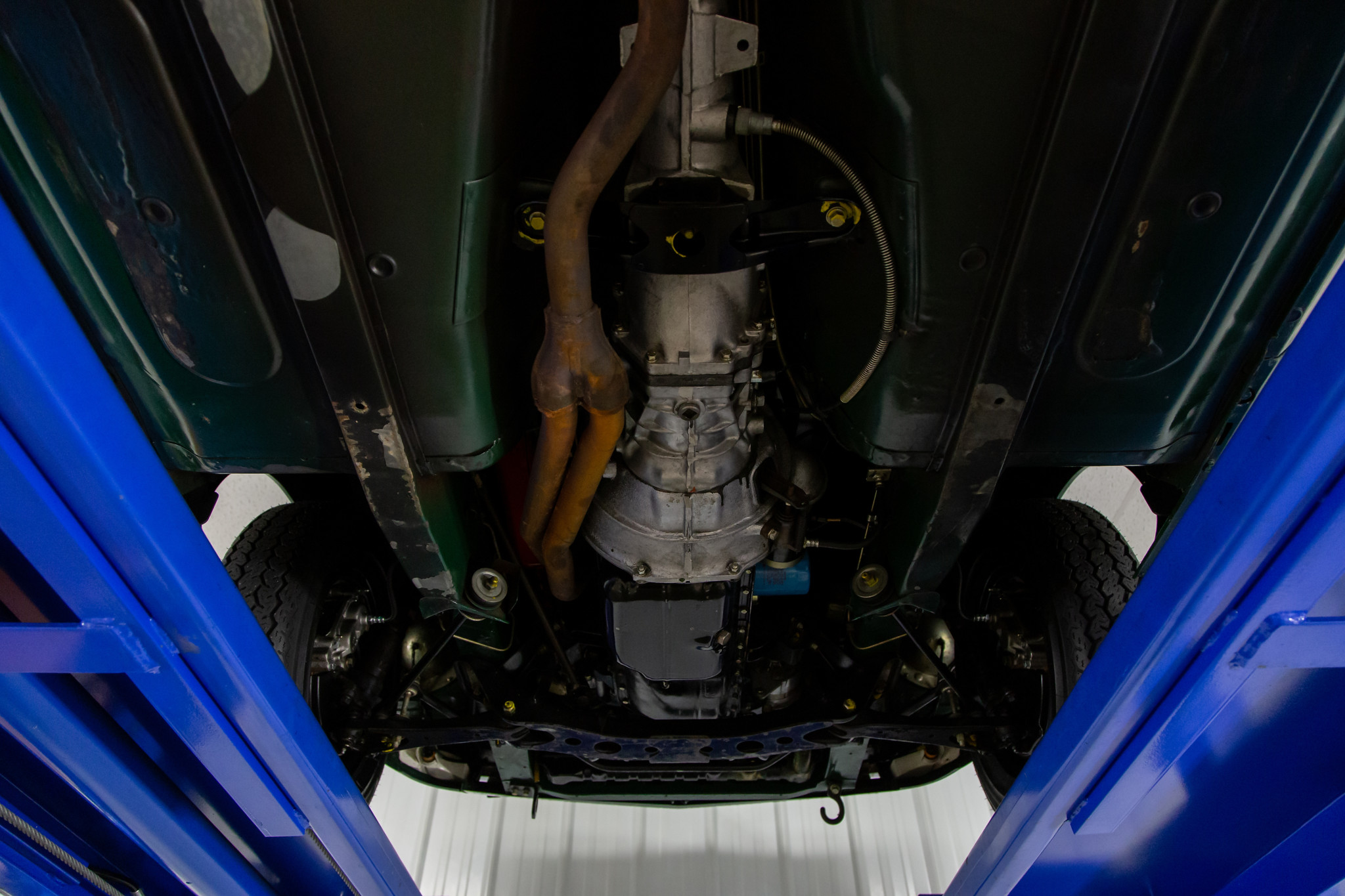

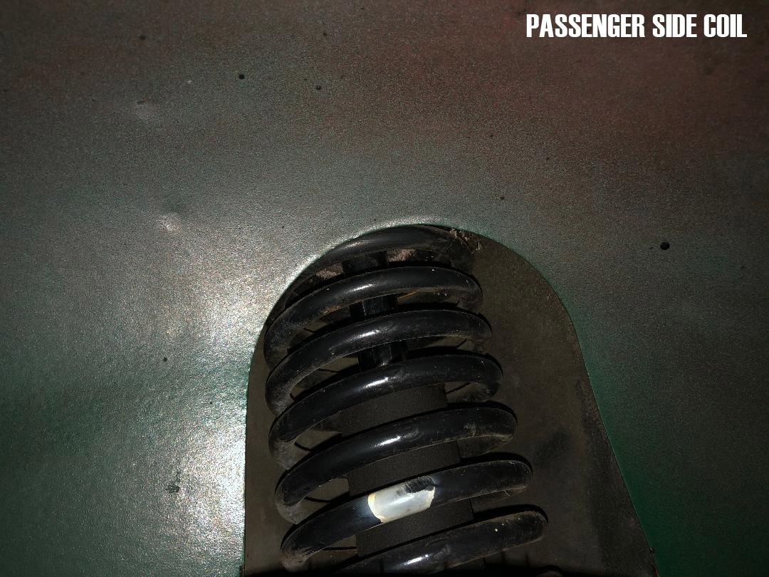

Are you sure your car did not have any undercoating? My 05/70 and 08/70 have some type of protection under the paint. Even the very original BAT $310k 240Z that was built in May 1970 has it.
Another good point in favor of the Raptor finish.  The Raptor finish on my car has a little more texture than what SpeedRoo showed but it's close.
I really appreciate the feedback.  Silly details like this really bother me.  My 6/70 looks like the green car.  To me, it looks more like 3 coats of heavy primer with some poor quality over spray. I have a 5/71 that received similar treatment.  None of them are like traditional undercoating. So if a person were to go for accuracy, it seemed to me that base+clear would be more accurate to what they did at the factory than traditional undercoating.  I have a later '71 model year car that has undercoating similar to what was done to the later cars (It's vin tag is gone so I dont know the mfg date).

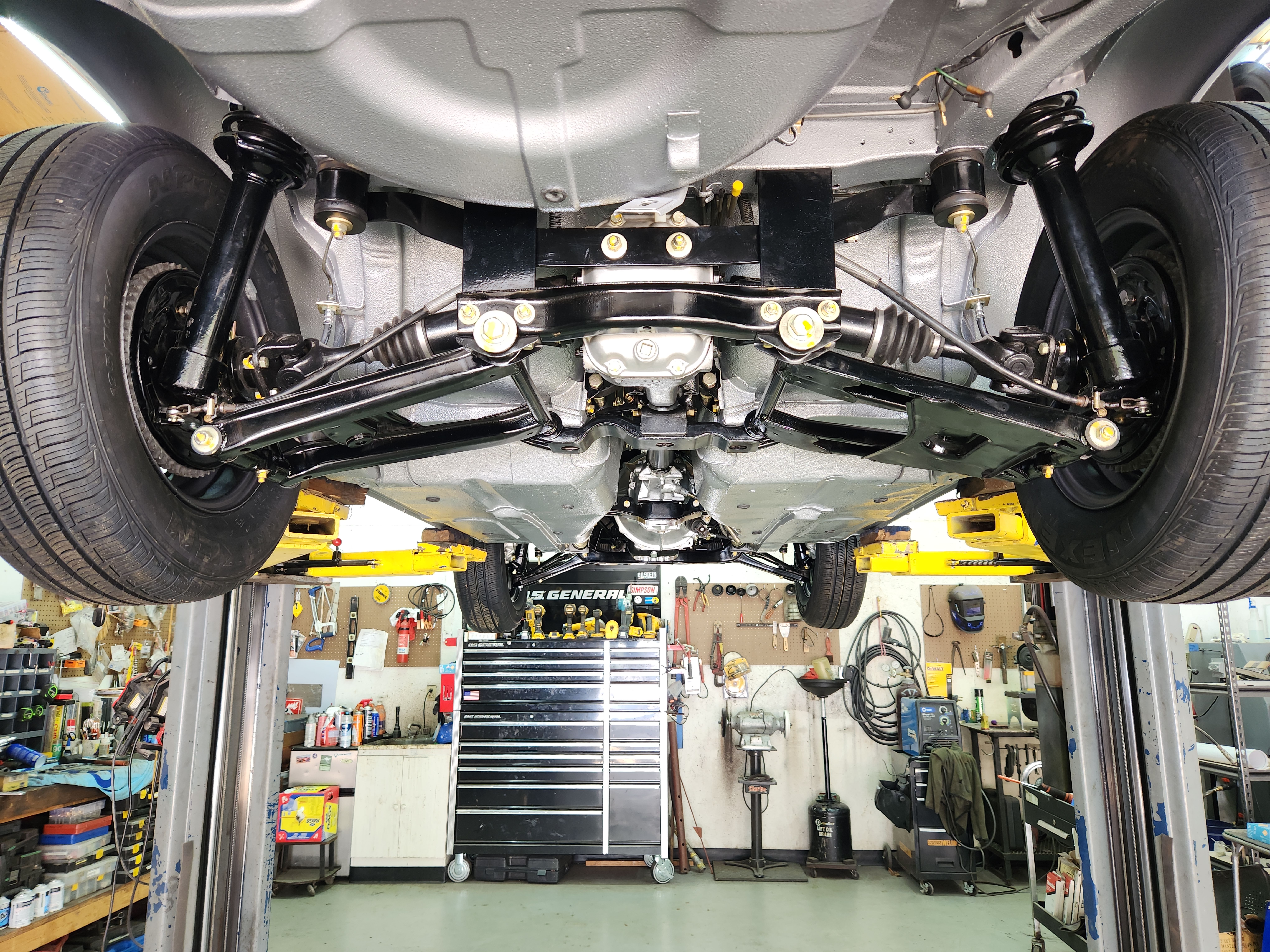

I did raptor liner with body color over it. I am really happy with how it turned out. Maybe one day the other side will get paint!
