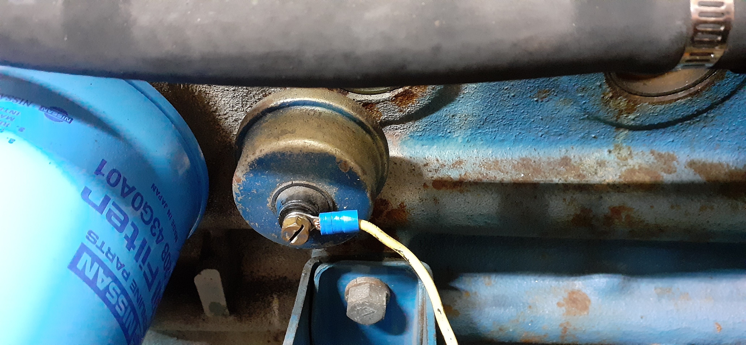

Does anyone know if the OEM oil pressure sender had a wirelug connector or a bullet style? I don't see a picture of it in the FSM. I'm looking to replace the oil pressure sender on my 4/74 260Z. The one on the car has a wire lug with a screw that holds the wire in place. All the replacement units i've found have a bullet style connector. Before I cut wiring to change connectors I thought I'd ask around. If the correct one is with the wire lug, can a replacement be found anywhere?

I've not seen one with the ring connector either. Pre EFI has a single wire for the gauge only, the 280s have one for the gauge and one for the high pressure fuel pump cutoff.
I'm pretty sure I used the yellow size crimp bullet connector on my '72.
You could buy the new sender then figure out your connection when you get it.
Better yet, who put it on there and why would you trust it? Wiring looks different. @SteveJ?

That looks exactly like the one on my car. My guage is indicating almosg no oil presure at idle speeds which is obviously concerning. I'm curious to see if its a sensor problem or something else. Thanks again.
The rule of thumb is 10 PSI/1000 RPM. Full scale is to 90 your car, so 10 PSI isn't that far up the scale.
@SteveJI did not realize you had encountered this before. Maybe back in the day “World Parts” may have put this out there.
