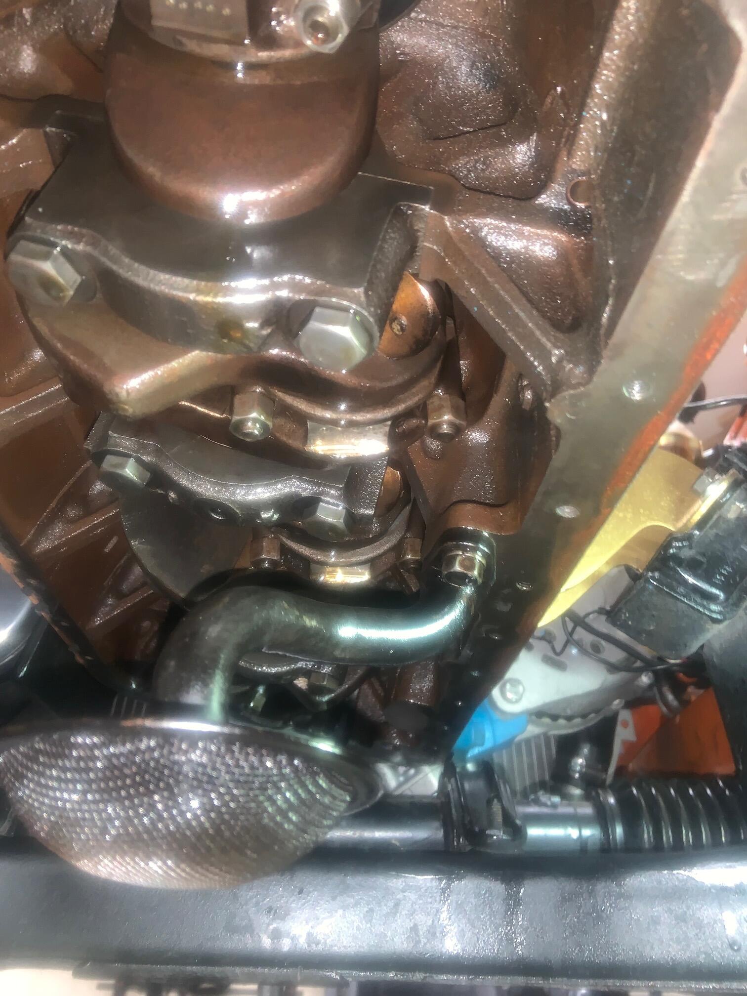

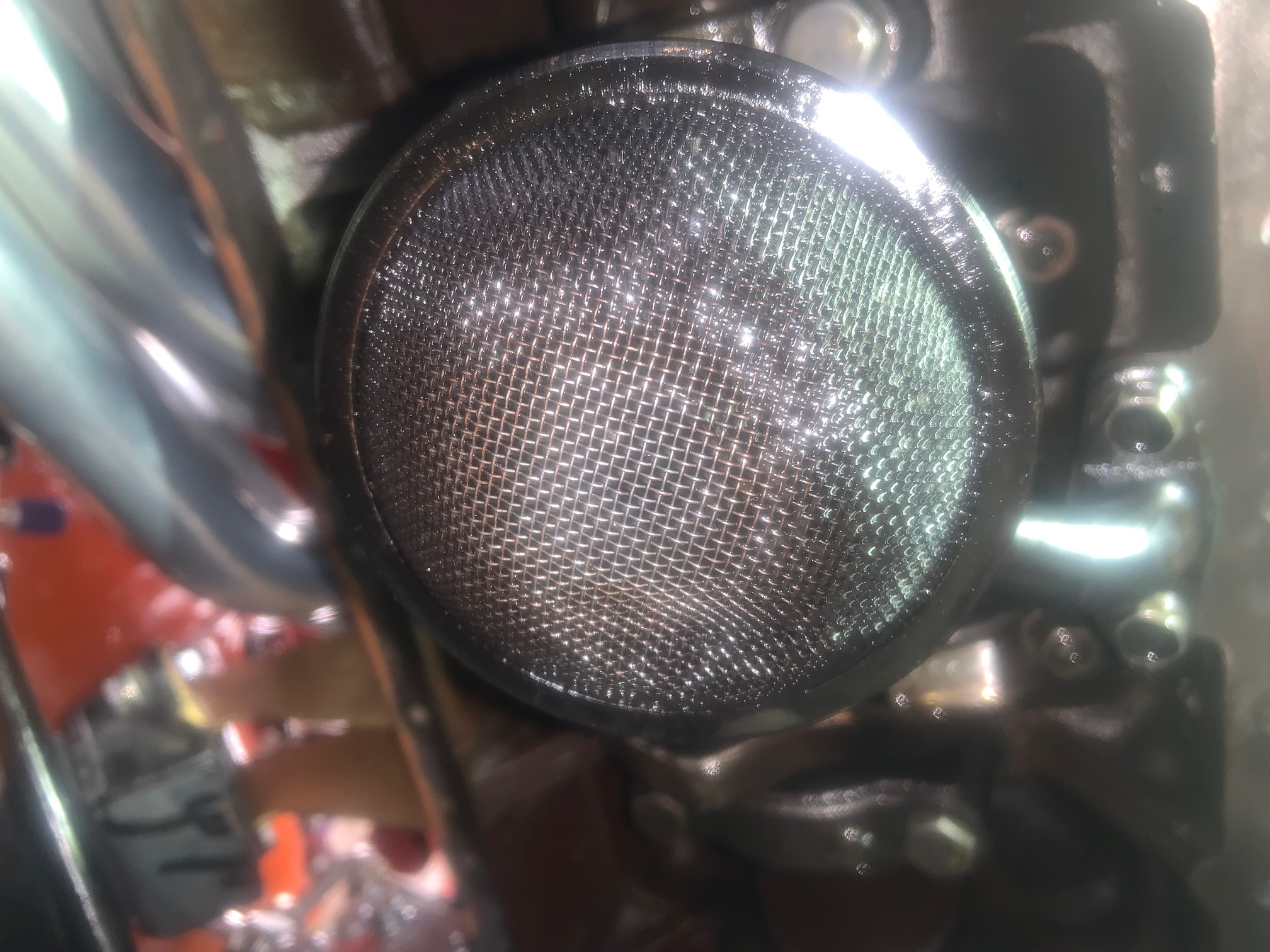

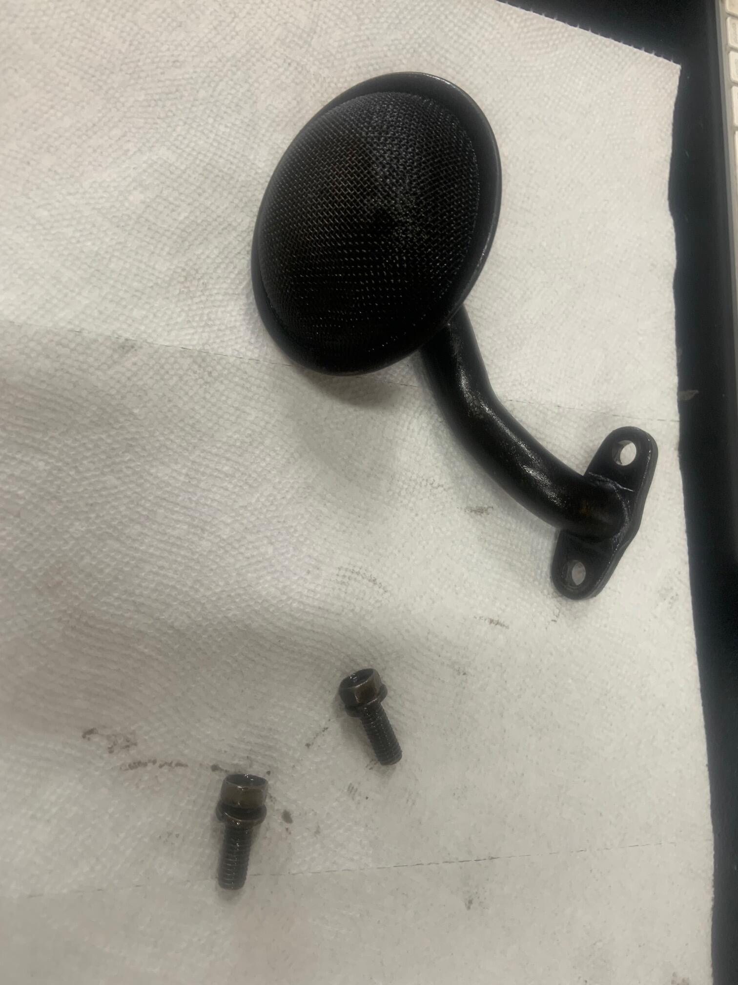

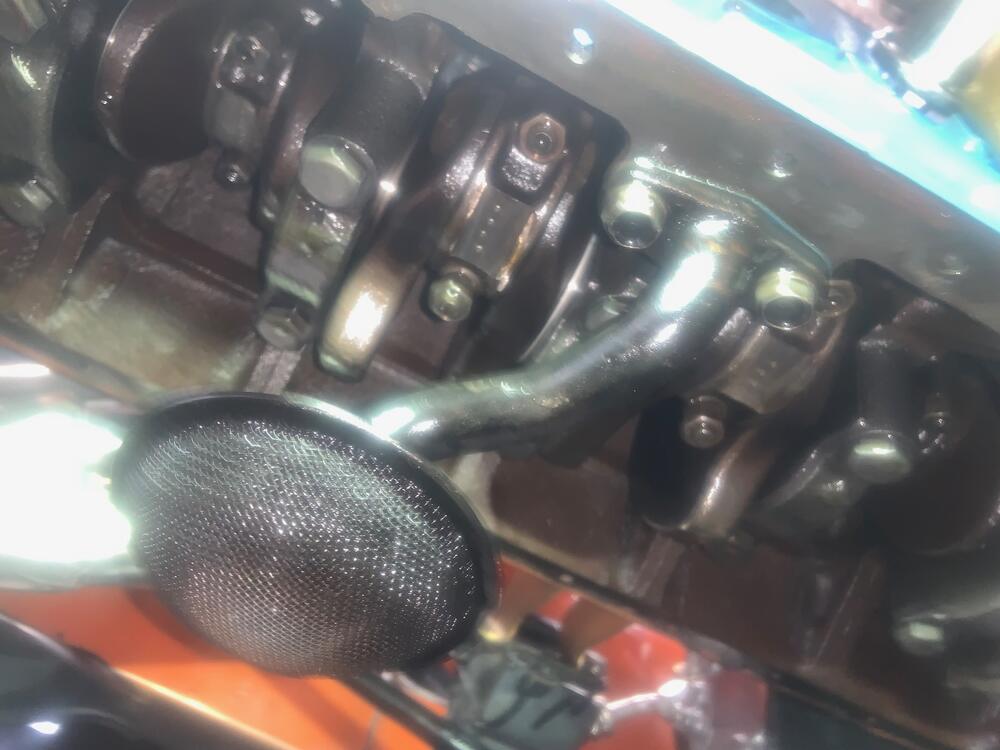

January 30, 20232 yr Author comment_649856 1 hour ago, Racer X said: I’ve already made recommendations going forward. So far Wally hasn’t followed them. I have tried to. you said check the relief spring. i just did. you said check the threads on the pickup. I am trying to do that. I am also going to empty all oil and start with clean filter like you said. You did comment on "bearing clearance" and such but sadly that is over my head. But you did say you didnt think this was the issue As for starting the car, others said to do so(i think Mark, before you posted to) and see what i could see. the only harm was spilled oil which i cleaned up. I do appreciate your all advice though.  I got the pan off. Turns out the i need to manually turn the crankshaft a hair so the front part of pan would clear some bolt coming from the front cylinder area Here are images i took. Everything looks clean but bolts on pickup dont have thread lock. they came out really easy. The thread locker would i assume blue?  The pickup has zero obstruction btw. I am sure hard to tell by images.     Edited January 30, 20232 yr by Wally Link to comment https://www.classiczcars.com/forums/topic/68097-low-oil-pressure/?&page=6#findComment-649856 Share on other sites More sharing options...
January 30, 20232 yr comment_649859 I think that you might have to get Piston #1 to the bottom of its stroke so that the counterweight is up in order to get the pan off. Too late but I would have spent more time at the oil pressure gauge port and maybe even at the oil filter when everything was together. Watched some oil come out, see what it's doing. Oh well. You'll know a lot more about your engine when you're done. Link to comment https://www.classiczcars.com/forums/topic/68097-low-oil-pressure/?&page=6#findComment-649859 Share on other sites More sharing options...

January 30, 20232 yr comment_649863 2 hours ago, Wally said: I have tried to. you said check the relief spring. i just did. you said check the threads on the pickup. I am trying to do that. I am also going to empty all oil and start with clean filter like you said. You did comment on "bearing clearance" and such but sadly that is over my head. But you did say you didnt think this was the issue As for starting the car, others said to do so(i think Mark, before you posted to) and see what i could see. the only harm was spilled oil which i cleaned up. I do appreciate your all advice though.  I got the pan off. Turns out the i need to manually turn the crankshaft a hair so the front part of pan would clear some bolt coming from the front cylinder area Here are images i took. Everything looks clean but bolts on pickup dont have thread lock. they came out really easy. The thread locker would i assume blue?  The pickup has zero obstruction btw. I am sure hard to tell by images.     So clean the threads, both in the block and on the bolts. Blue thread locker is supposed to be removable, red is intended for a more permanent lock. I use red for things like this, as it isn’t impossible to remove, and the bolts are less likely to come loose.  Link to comment https://www.classiczcars.com/forums/topic/68097-low-oil-pressure/?&page=6#findComment-649863 Share on other sites More sharing options...
January 30, 20232 yr comment_649864 2 hours ago, Wally said: I have tried to. you said check the relief spring. i just did. you said check the threads on the pickup. I am trying to do that. I am also going to empty all oil and start with clean filter like you said. You did comment on "bearing clearance" and such but sadly that is over my head. But you did say you didnt think this was the issue As for starting the car, others said to do so(i think Mark, before you posted to) and see what i could see. the only harm was spilled oil which i cleaned up. I do appreciate your all advice though.  I got the pan off. Turns out the i need to manually turn the crankshaft a hair so the front part of pan would clear some bolt coming from the front cylinder area Here are images i took. Everything looks clean but bolts on pickup dont have thread lock. they came out really easy. The thread locker would i assume blue?  The pickup has zero obstruction btw. I am sure hard to tell by images.     I know your experience causes you to be reticent to do so, but now is the perfect time to check bearing clearances to rule them out as a cause, or determine if there is a problem. You’ll also be able to asses the condition of the bearing shells. Did you mention how many miles on this engine since the rebuild?  How many oil changes?  Link to comment https://www.classiczcars.com/forums/topic/68097-low-oil-pressure/?&page=6#findComment-649864 Share on other sites More sharing options...

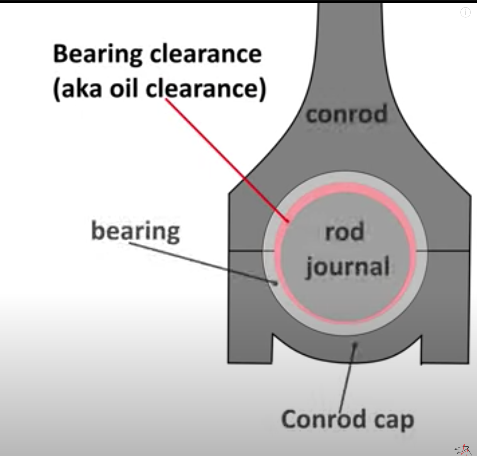

January 30, 20232 yr Author comment_649866 so as far as i know the method to check bearing clearance is to measure diameter of rod and subtract inside bearing diameter.. Thus the difference being the clearance. If so, yes, that does scare me to attempt. If there is a way to remove one conrod cap and measure the clearance gap i feel safe to do that...but i dont think that possible. I may drive up to the engine rebuild shop and ask the man to pull up his notes from my rebuild and see what he has written down. Of course this wont let me see shell condition  Since rebuild, I have put maybe 100 miles on engine. Only oil change since then is one i am doing now. Link to comment https://www.classiczcars.com/forums/topic/68097-low-oil-pressure/?&page=6#findComment-649866 Share on other sites More sharing options...
January 30, 20232 yr comment_649867 You would use plastigage and remove one bearing cap. Install plastigage. Retorque cap and then remove the cap and analyze the crushed plastigage. Link to comment https://www.classiczcars.com/forums/topic/68097-low-oil-pressure/?&page=6#findComment-649867 Share on other sites More sharing options...
