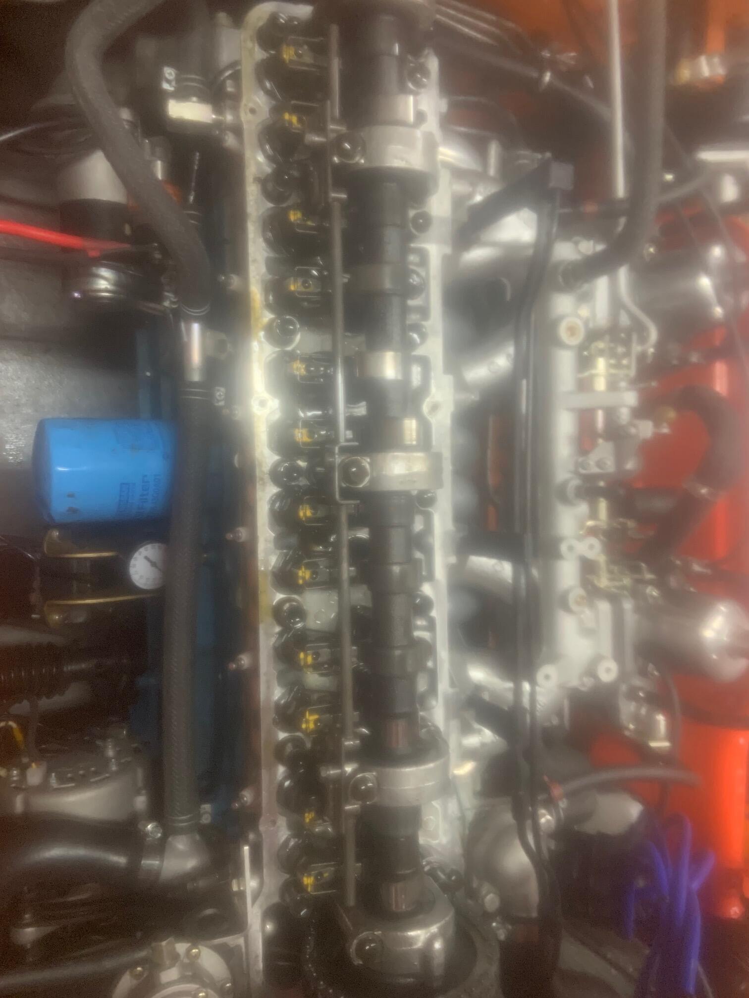

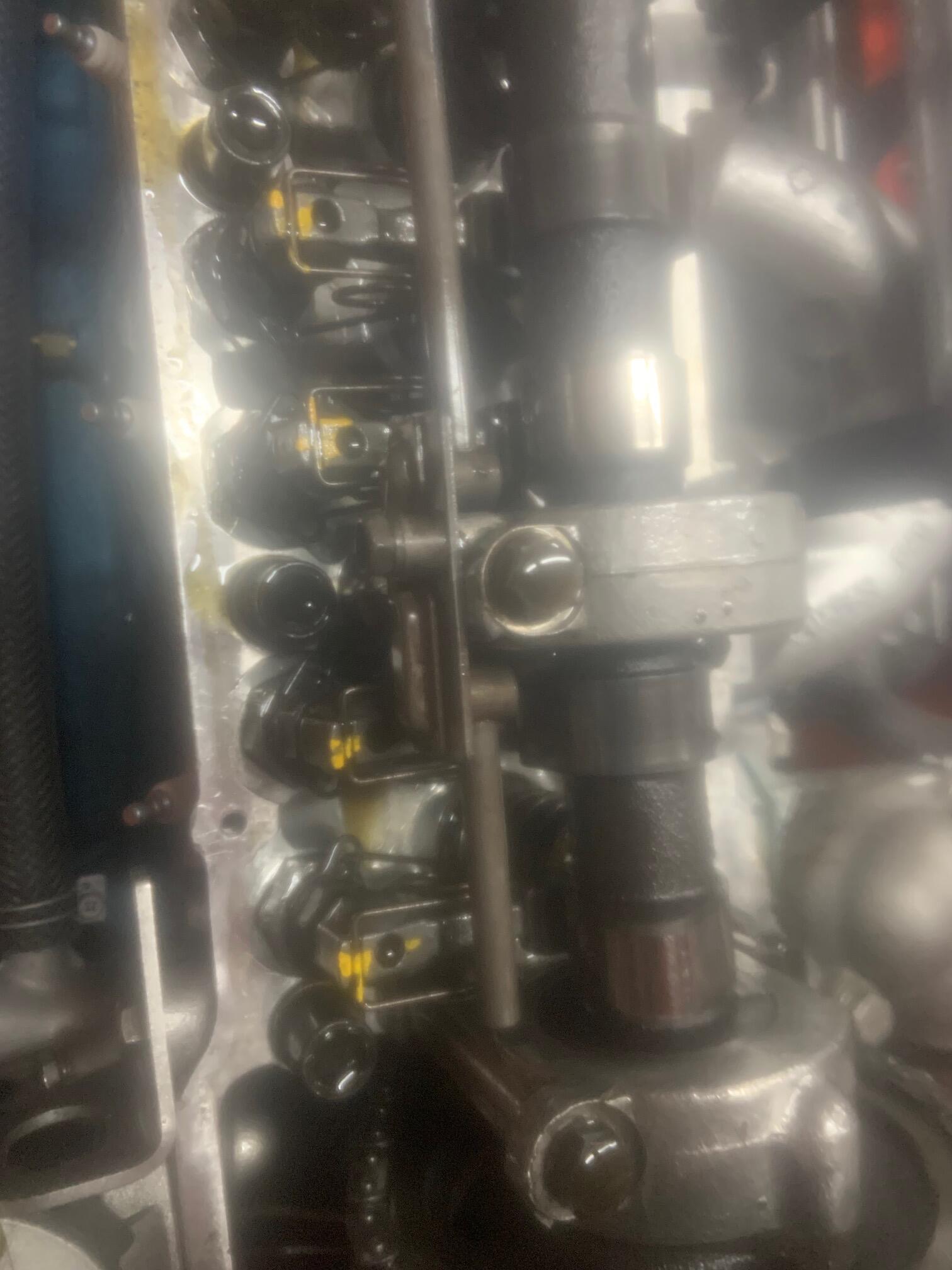

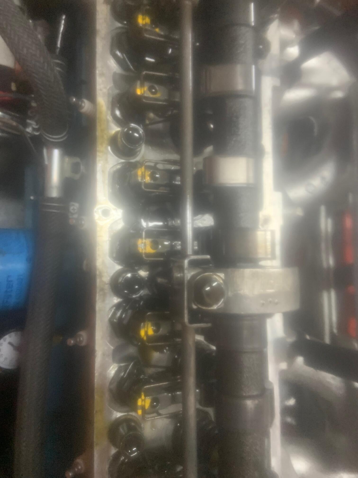

a local engine shop rebuilt it. they have been around 30 years. Here are some images after taking valve cover off.
Oil bar looks good to me. not sure about nozzles will crank up in bit and take a video. after all comments, i am concerned about sump pump. I know i re-used old one so i am gonna eventually drop the pan and check all that out.

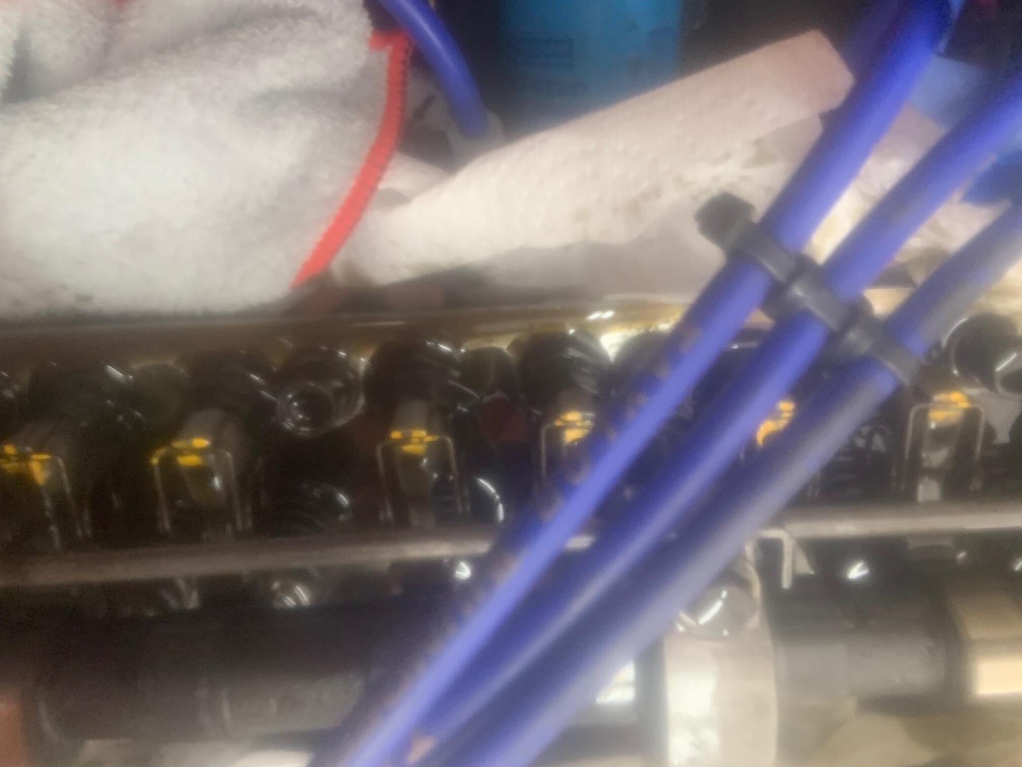

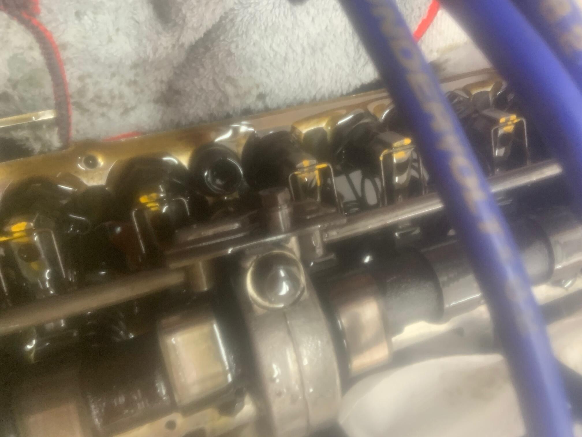

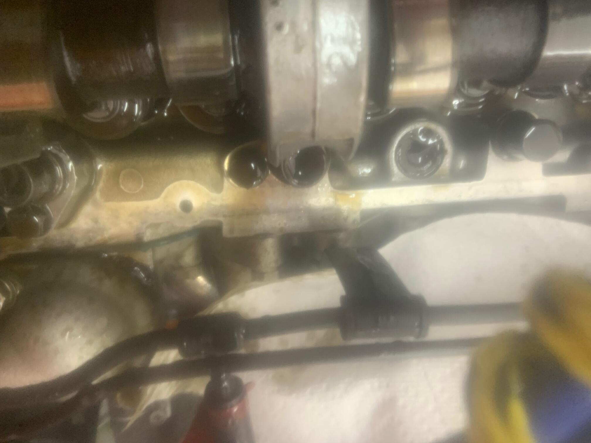

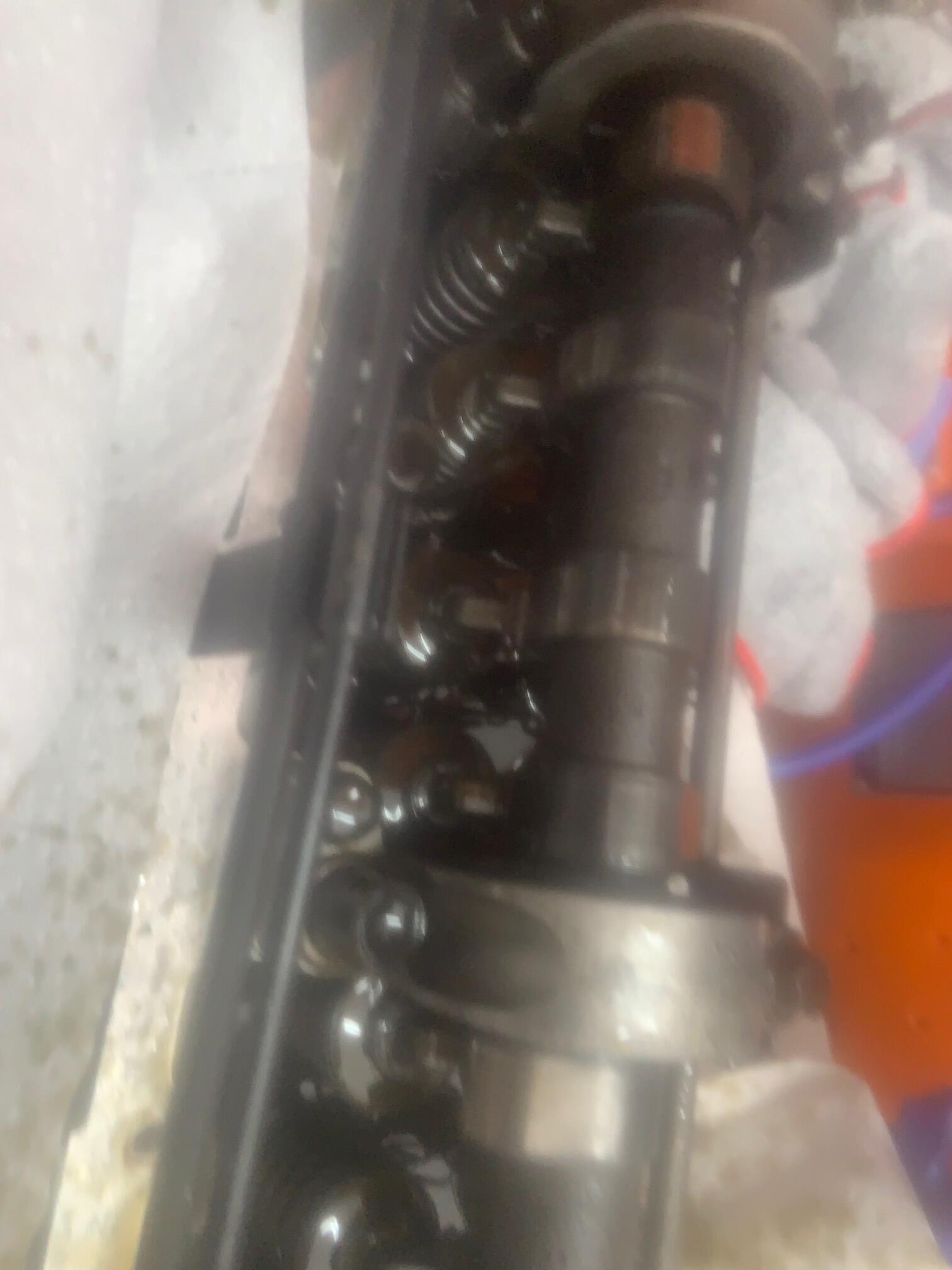

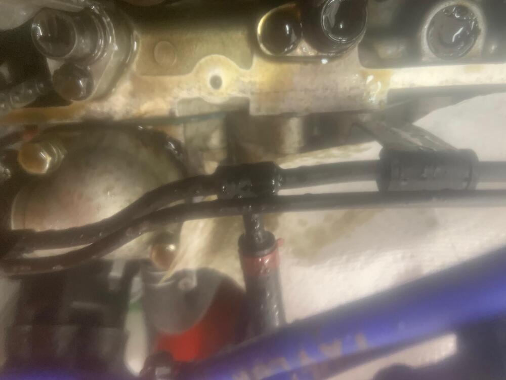

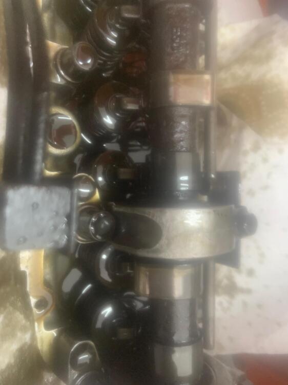

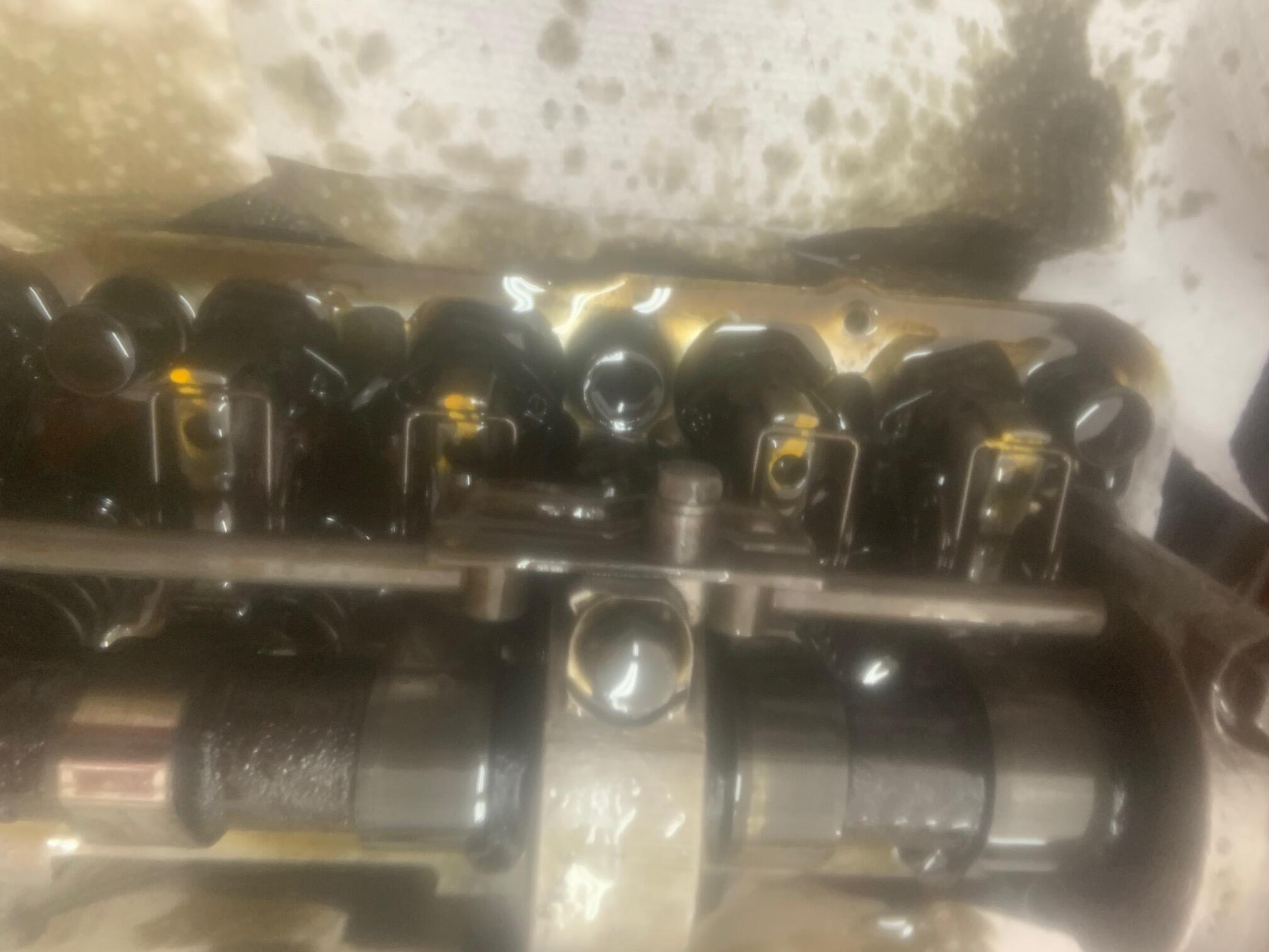

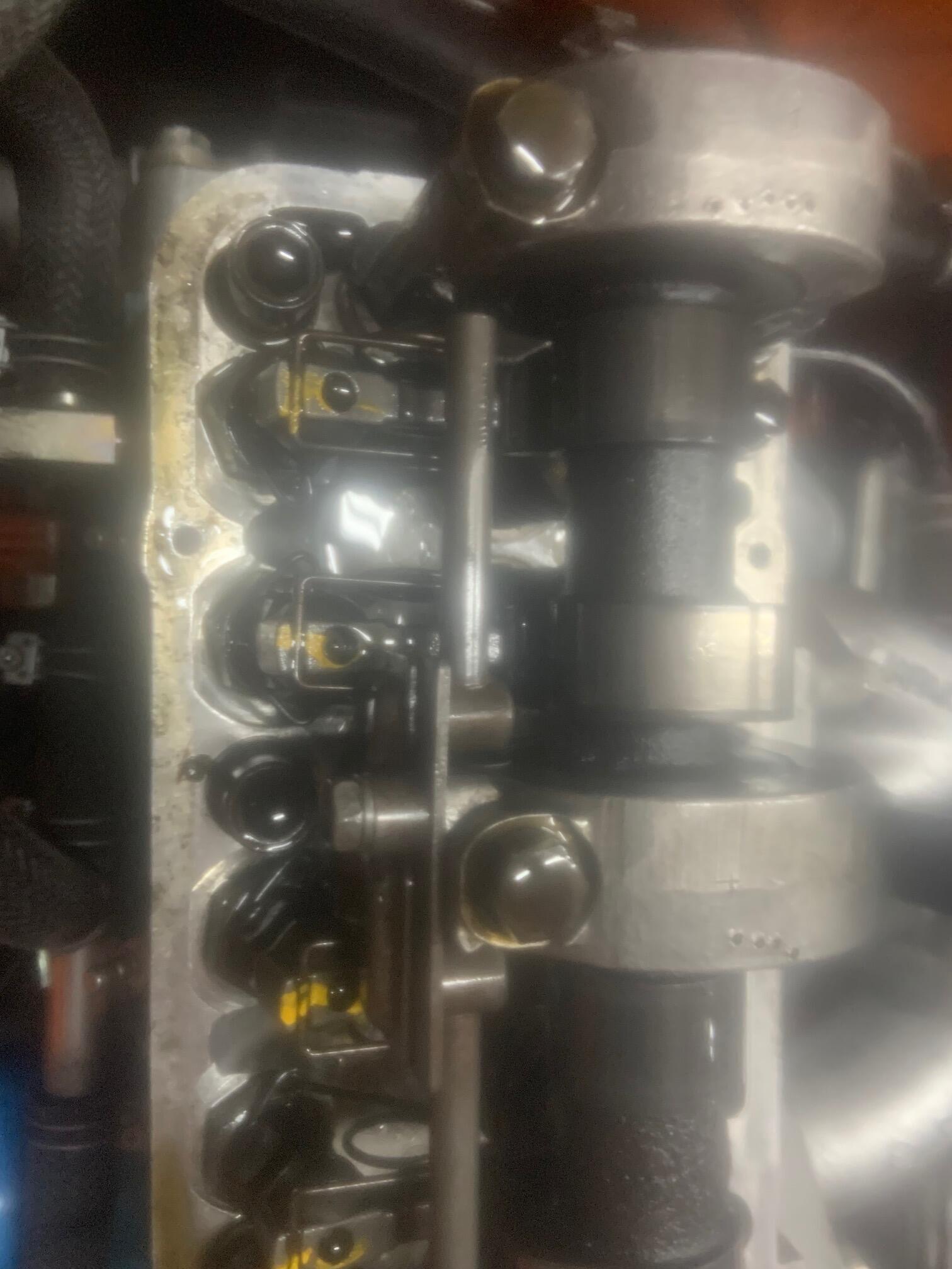

Here is one short video of engine running with cover off. Also several images of engine area right after turned engine off.
You could take the plugs out, dry them, and turn the engine over without plugs in to make sure you don't have too much fuel in the cylinders.
You should really verify that the cam is getting oiled before you run the car, though.
Glamour photographers smear Vaseline on a filter screwed on the lens to make a soft, blurry effect.
I don’t think that’s what you have tried to do here Wally. It is great that you post pictures and videos to help us understand what the malfunction may be, but honestly, it isn’t easy to see anything here. Too blurry.
I recognize the things in the images, cam, towers, followers, etc. I see there is oil there, but the poor image quality makes it difficult to accurately judge if there is, or is not, enough oil.
I assume you are using a cell phone. No worries , it is possible to coax a reasonably executed picture to share what you see. A clean lens is important, and also, consider the direction of light around the things you want to take snapshots of. Any light source, sunlight, fluorescent shop lighting, desk lamps, if they are in a position that the light falls directly on the image sensor in the phone, they cause glare, partly because of the low quality plastic lens, and the cover over it, and partly because the tiny image sensor can’t resolve such strong light directed at it, and compromise an already marginal image quality.
