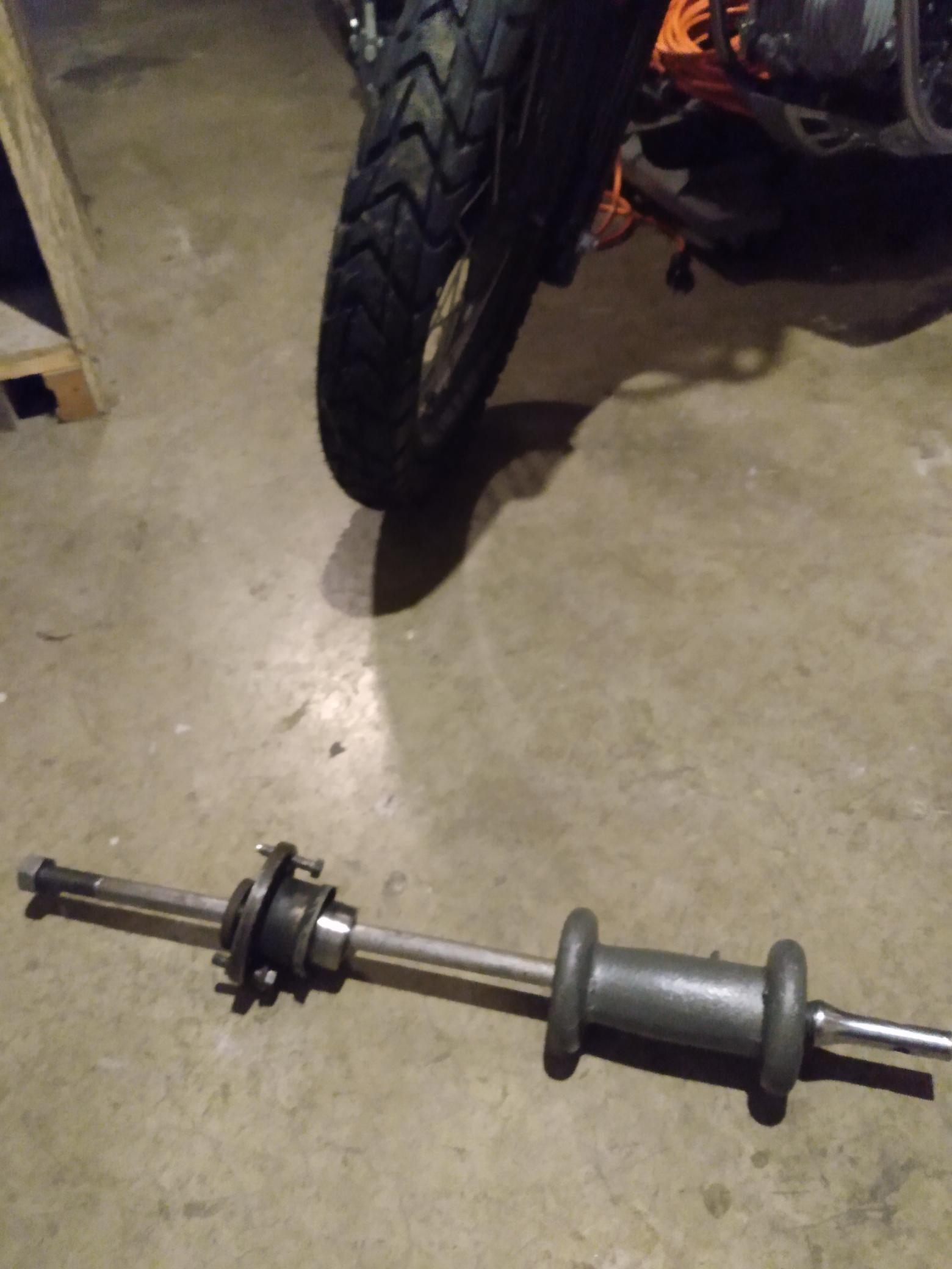

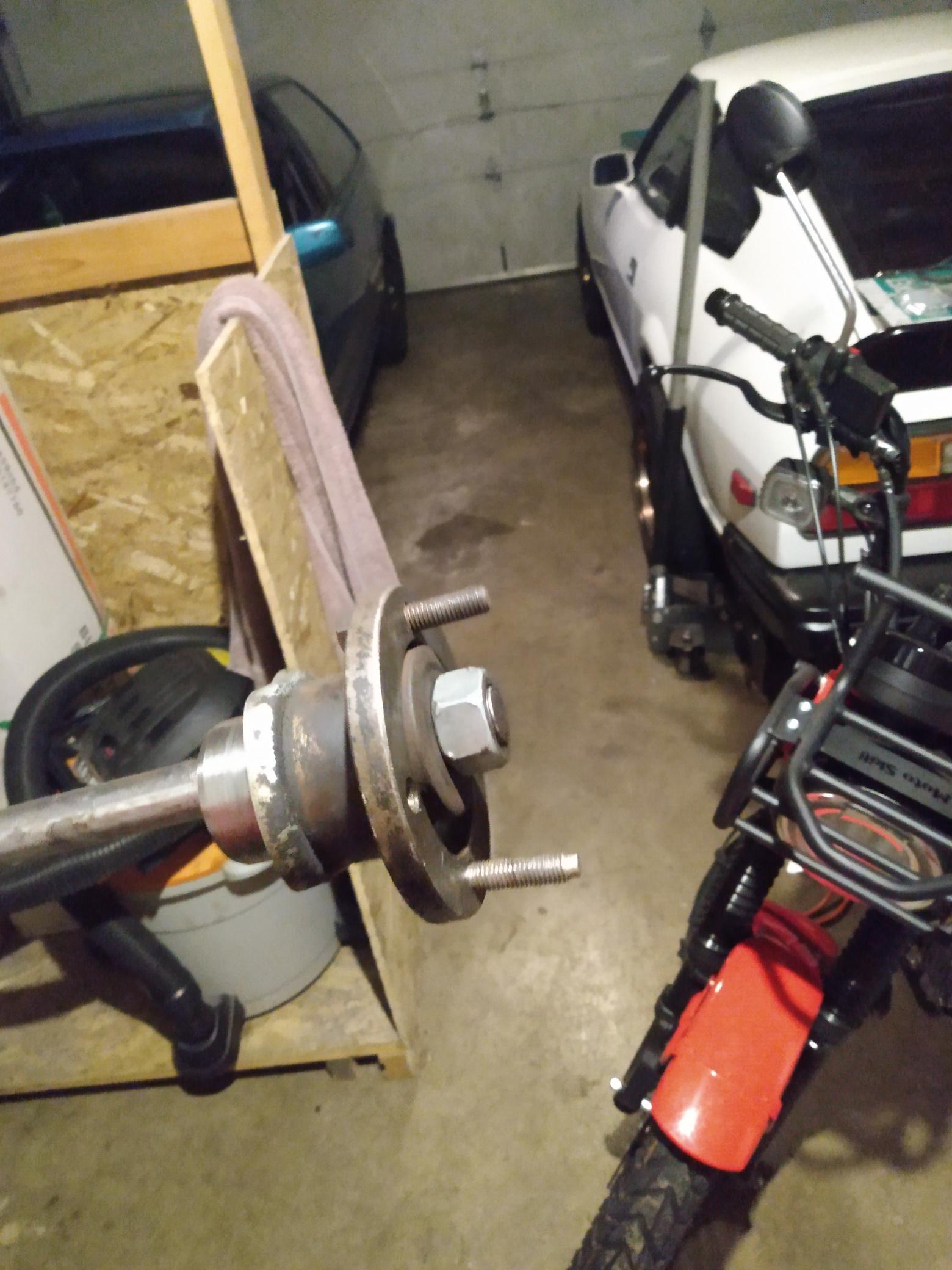

I made a cap puller out of a Harbor Freight slide puller and the end of a half shaft.  The bolt pattern matches up perfectly.
