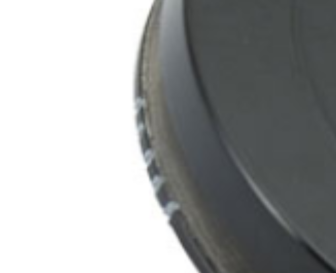

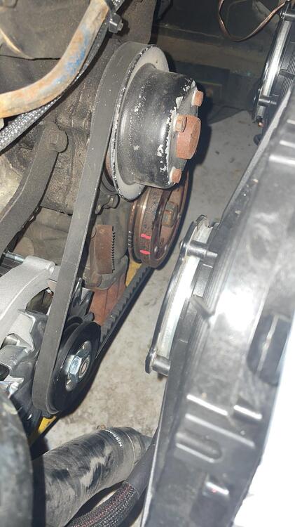

Can you take another picture and pan out to include the timing tab on the left.?  Never seen that many points.  You need to decide which one you want to use as zero.
Grab on to that damper (an engineering/physics word, not dampener) and yank it around and back and forth.  See if it's loose.  It's been known the that the wrong combination of bolt and washer can leaver the damper loose on the crankshaft.  Plus the PO replaced it for a reason, there might be damage under there.  That bolt head looks pretty beat up.
Here’s a better pic for you. As for why the po put it on, the car doesn’t have ac and was and will be raced somewhat frequently so having a harmonic damper helps. It doesn’t matter too much on an in-line 6 but still, and less rotational mass.
I tried turning the damper by hand and it moved a little but the bolt was also moving so I think it’s tight but I could be wrong. I didn’t get around to checking for exhaust leaks so I’ll try and do that tomorrow if I have the time.
Just realized that that is a 280ZX timing mark tab.  You never said what you're working on, you just kind of jumped in to valve lash ash and noises and have "280" in your user name.  Looks like a 280ZX engine.

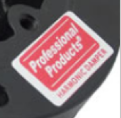

Anyway that's an aftermarket damper with odd markings.  Might be a Powerforce Performance Professional Products "Harmonic Damper"  like the one MSA sells.  You have some mysteries ahead of you.  Who knows what's in there.
Read the notes about the timing marks.  Might as well just start from scratch with RacerX's advice.
p.s. you always need a damper.  Somebody just replaced your factory damper with aftermarket.  But you could go back to a stock ZX damper if you wanted to make life easier.  Seems like the pulley diameter is smaller with that "performance" unit which will make your alternator and water pump spin slower.  Both bad for 280ZX and 280ZX engines.
