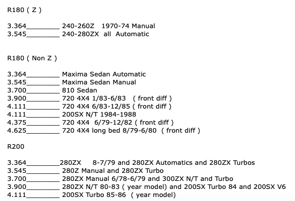

I have this list. I had a better one but lost it and the page is no more. I should have saved a screen shot.
Seems the 3:70 was short lived in the early ZX. I expect my car will have 3:90's R200 I'll find out when I get that far in.
I am not saying this is 100% accurate, but my findings have not found any errors. I have the 810 Maxima 3:70 R180 in my car now. I have the Auto 3:54 too and 3:36 R180's
I picked some 720 truck front's (1) 3:90 and (2) 4:11's I have never found the 4:37 or 4:62 all R180

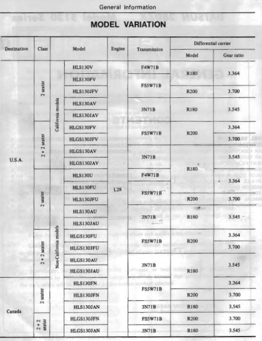

A lot of combinations shown on this list. The issue with it is the generalisation of the FS5W71B. We know there are three, a wide ratio, an early close ratio and the more common later close ratio versions. It also leaves out the 240mm flywheel in the 2+2.
Back then, we thought the 2+2 had the 240mm flywheel and the wide ratio 5 speed to compensate for the extra passengers and body work adding weight.
