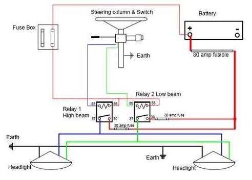

On my 240z I went with this wiring diagram to take the load off the wiring harness, steering column stock/blinker switch and also change ground/power configuration for the headlamp connector itself so that I could convert my headlights to LED further reducing load on the car wiring. Here's the diagram;
Once done it changed the headlamp bulb connection to this configuration allowing for the LED headlamps because the Diodes only allow power to flow one direction;
The way Datsun configured the wiring connector point 3 above was power with points 1 and 2 being ground back at the steering column. I've actually converted all bulbs except for the dashboard to LED further reducing load on the wiring. If you go LED for the blinkers be sure to replace the emergency and blinker flashers with LED compatible flashers.

I hope you used fuses smaller than 30 A. That high of a rating won't protect the wiring adequately in the event of a short circuit.
Just to be specific, this diagram only works for the early 240Zs where the headlight switch completed the path to ground. The later cars would have to be wired differently than this.

I actually used Dave's harness on my 240z which came with a single 30amp fuse before the relays where the 80amp fusible link is shown. The harness came with a 30amp, but where I've gone LED I could probably even reduce that.
Just curious what the change would be for the 260z/280z besides the pigtail connectors? Doesn't factory wiring for 260z/280z still have a single power to pin 3 in the headlamp connector and switching ground on pins 1 and 2 for Hi/Low beam switch?

The headlight circuit wiring changed some time during 71 or between 71 and 72, I believe.
The original circuit had the headlight switch completing the path to ground from the high/low beam switch as shown in the 70 and 71 FSM.
In 72, the headlight switch controlled the wire going to the fuse box. (white/red to red wires) The high/low beam switch connected to the ground wire instead of going through the headlight switch.
This later design was used for the rest of the S30 run. The change in the 260Z on is the type connector used at the headlights. I periodically search to see if anybody has found a source, but I haven't had any luck so far.
Dave mentioned the wiring change in the headlight circuit to me many years ago, and I dug through the wiring diagrams to understand what he was saying.

Since Dave's harness is good on all 240z's including 72 and 73 I would think that other than the connectors at the headlight pigtails the harness will work on 260z and 280z's if you change the connector on the pigtail to the 240z style connector (from a little google work it seems the round connectors in the 260/280 cars are unobtanium). If you don't want to cut off the round connector you could build a new pigtail to go to the headlamp.
