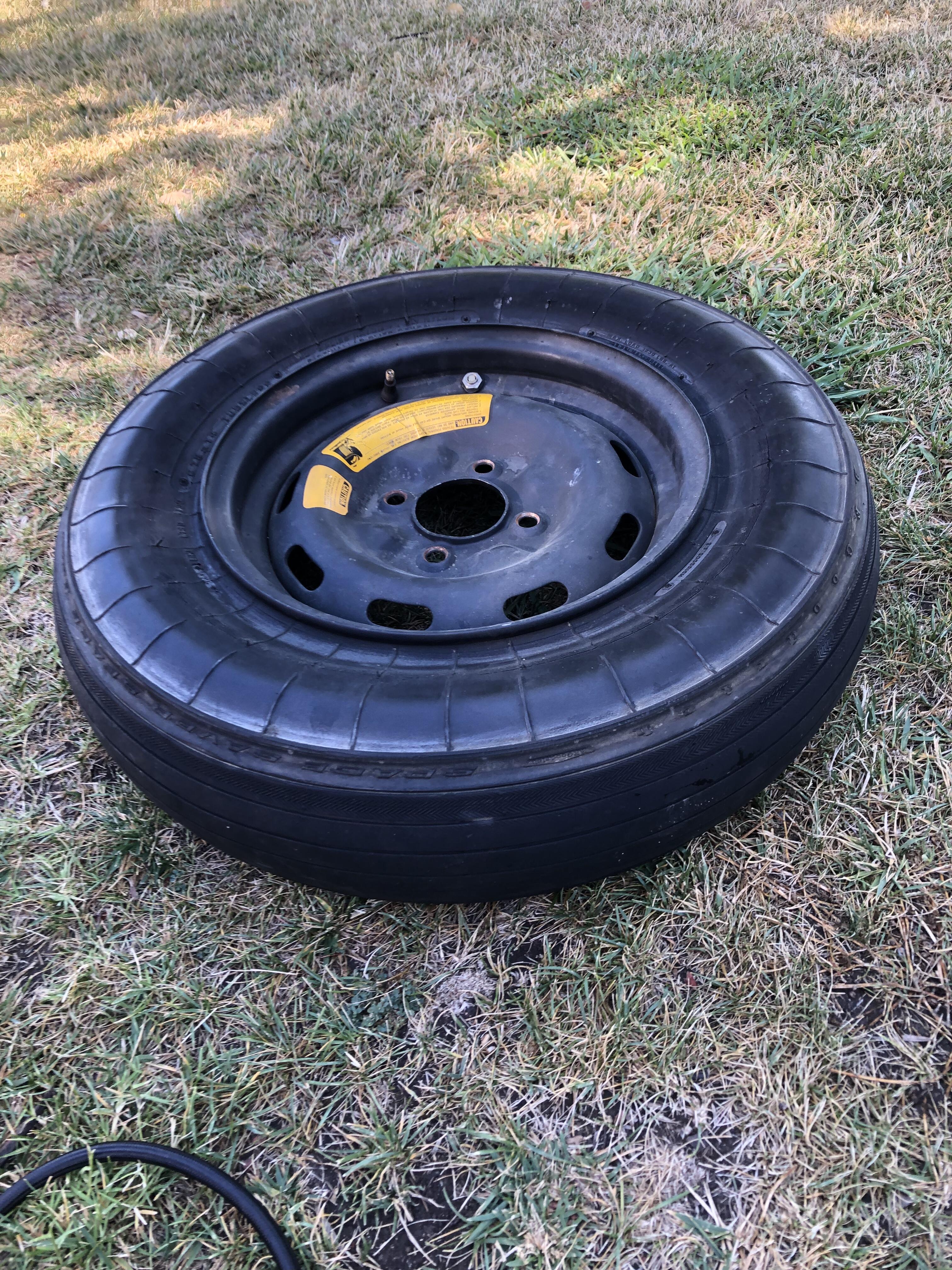

Inflated the original and it is not bad looking at all. I mean look inflated pretty evenly with a car inflator and inflated to 25psi in about less than 5 min. Seems to be holding air. I plan to let it sit for few hours.

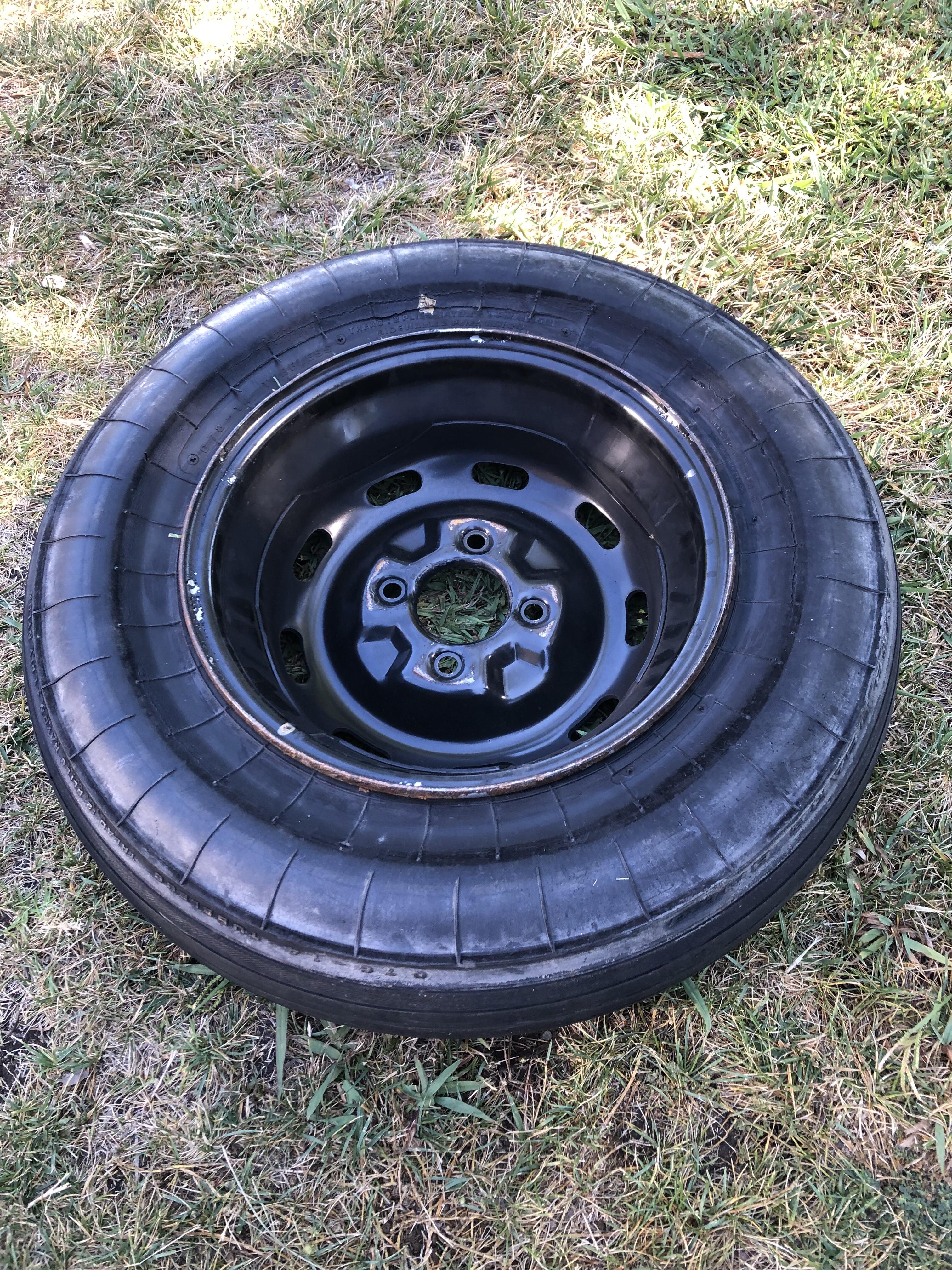

May be this has been answered in CO post. T115/70/14 wont fit the stock rims which the SST is on?
I'm not sure I would want to stretch a 115 wide tire out onto a five inch wide rim. My thoughts on the matter while I was in the thick of it:
"I didn't move the space saver tire over to the 280 original spare wheel because I was worried that the 280 spare wheel was too wide. The space saver tire was originally on a four inch wide rim and the original 280 spare wheel is five inches wide. I wasn't comfortable stretching that narrow tire out to a five inch wide rim.
I think you could use a 4.5 inch wide rim, but since I was in there messing around anyway, I took the opportunity to make it as narrow as possible"
