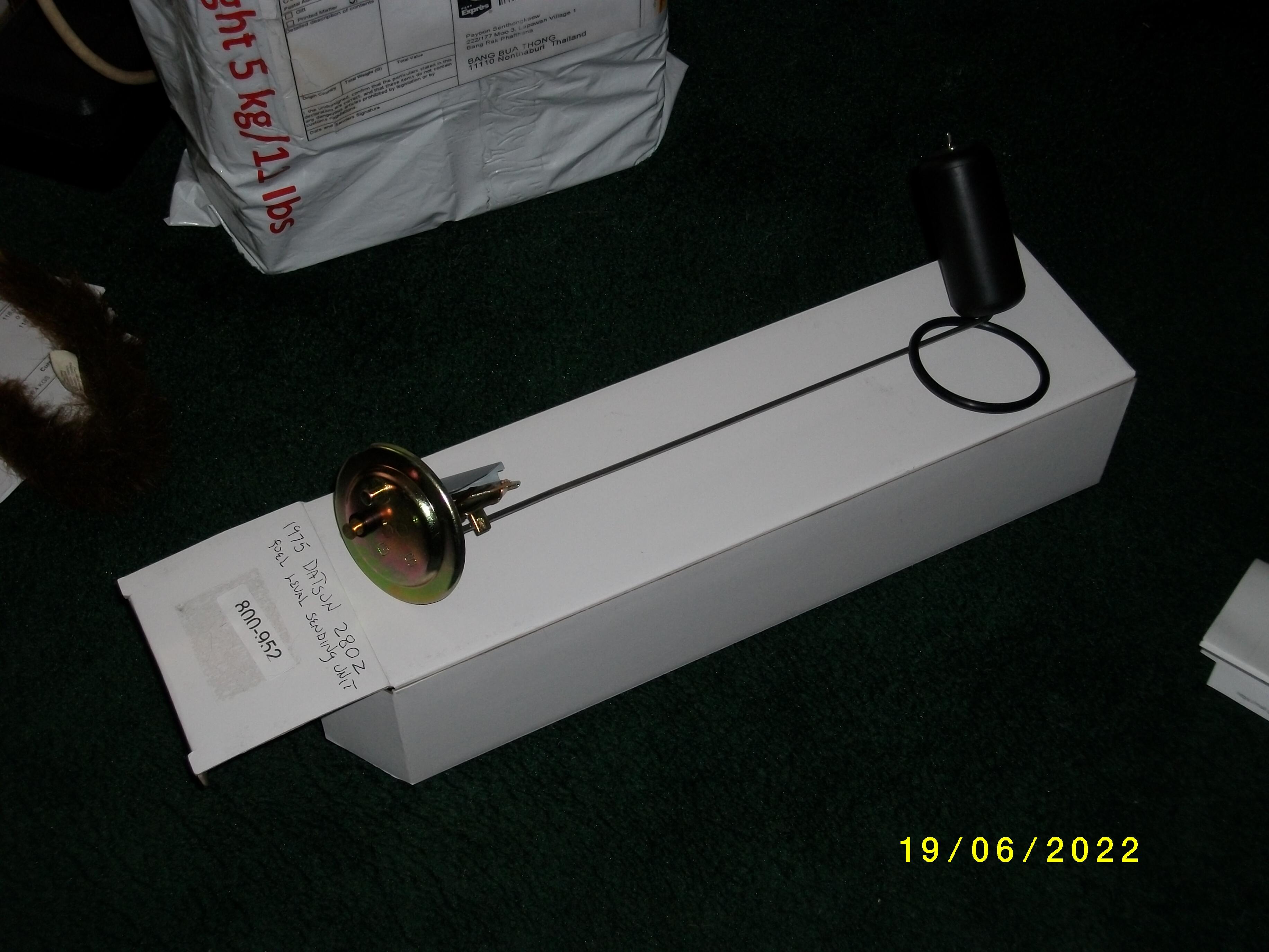

Well I posted earlier this month about my gas tank woes, and the shop who put the new fuel pump in said that my fears of having a bunch of dirt and water in the bottom of the tank, might not be so, Howie said if the car was parked, for whatever amount of time, Had real gasoline in the tank when parked it might have not be such a mess after 13 years ? but I also asked for them to see if the drain plug on the bottom of the tank to see if it would break loose, ( it did ) which makes me think that water hadn't been at the bottom of the tank ( I was thinking if the drain plug had a lot of rust, it might be frozen in place ) But it broke loose so maybe that a good sign ? But I need to change the dash gauge sending unit, and of course, they too are in short supply so I have one from Zcardepot and it is a little different and needs some of the connections changed to make it work. My question is do I need to drop the tank to change the sending unit ? BTW : the new Carter Fuel pump fit in the original mount and is really silent now, so I guess the old pump was very noisy must of meant it was getting ready to die ?

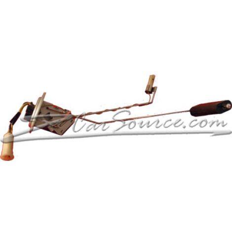

75 Datsun 280Z fuel tank hose routing.gifWell I have looked through the manual, the factory service manual, it doesn't say you need to remove the tank, but it also says the fuel gauge sending unit is on the front of the tank, and the sending unit I got from Zcardepot will work, but you only need to use the yellow and black wires which I assume means you don't use the fuel waring unit ? a picture of my sending unit is here : and the one that was or went in from the factory is here: and a layout of the tank. But never the less, I need to empty the tank.
