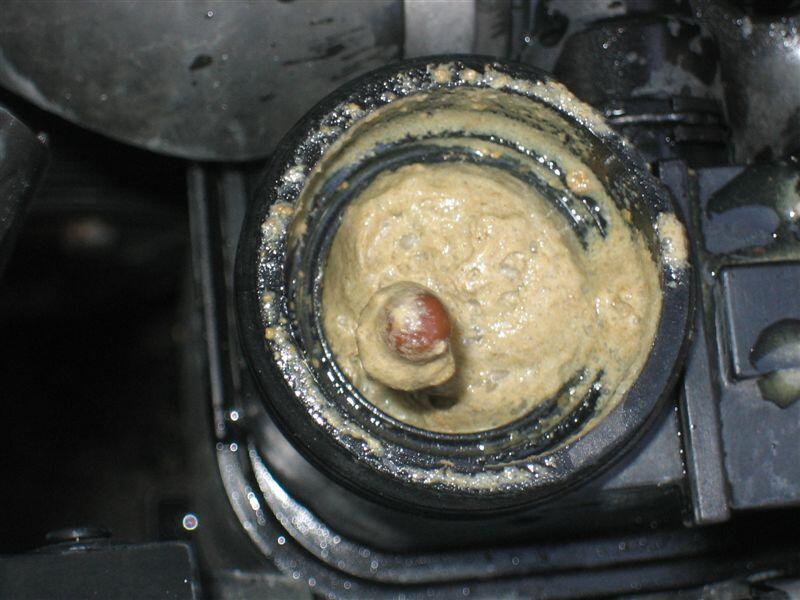

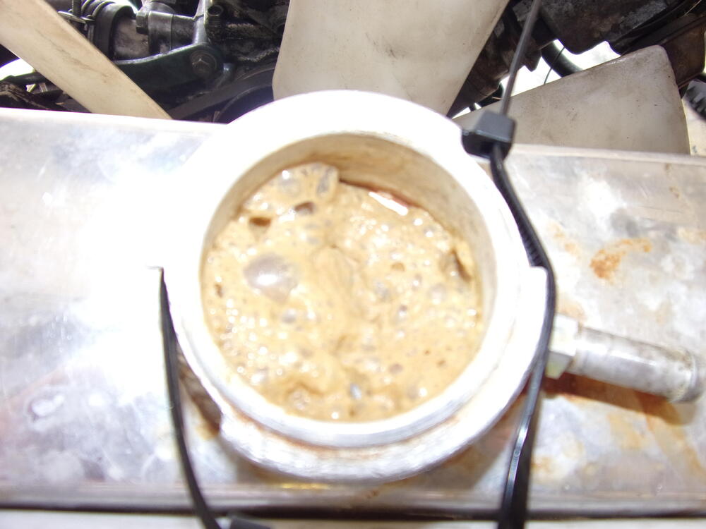

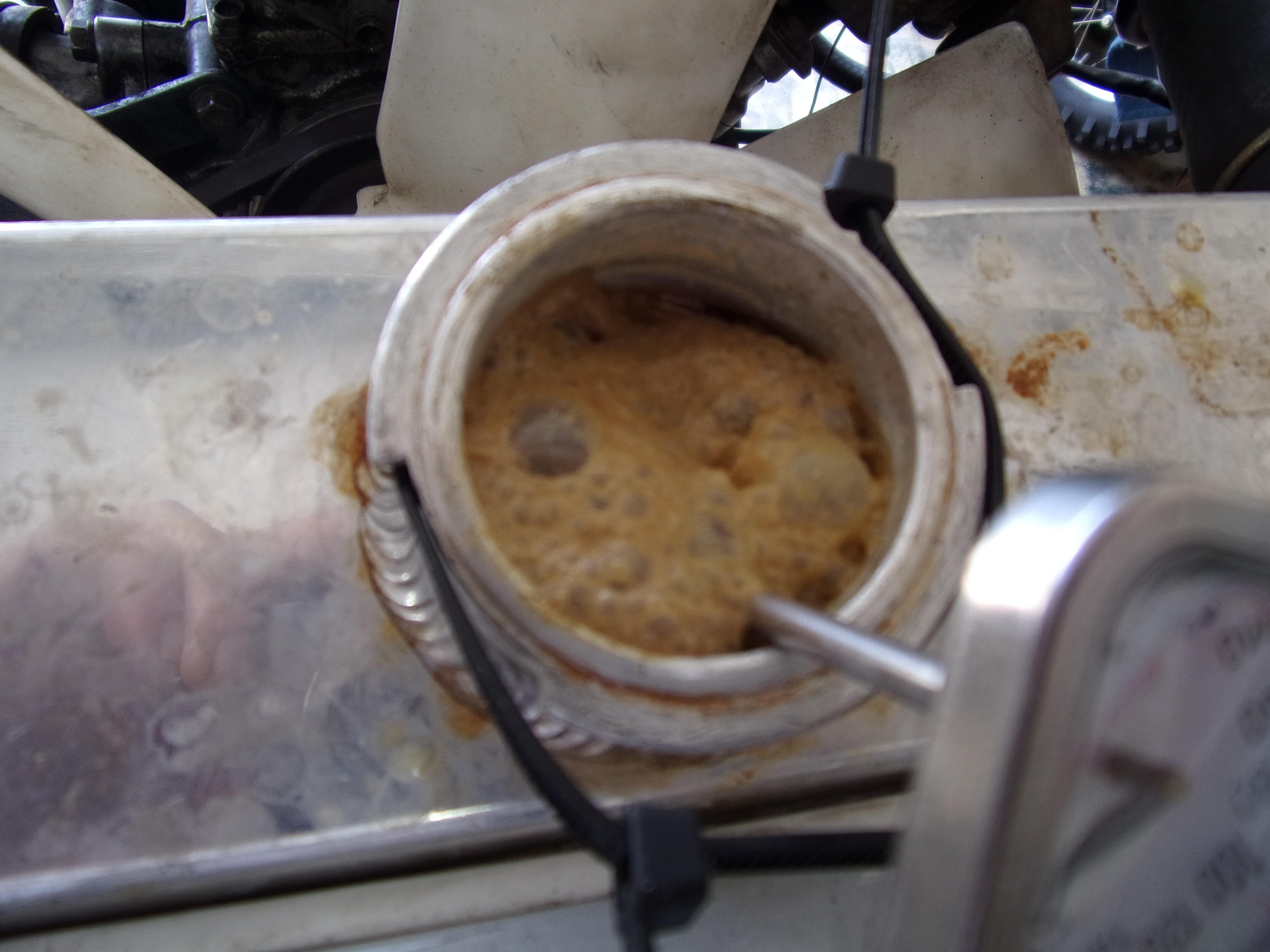

ok got it started on the test stand today. Bad news I get a lot of oily brown foam coming out of the rad (I left the cap off so I could monitor the coolant level).  Pretty sure the oil level in the crankcase dropped as well. had some but not a lot of exhaust gas in the rad as well after testing with the blue turn yellow test kit (it was just a slight green actually). I retested the compression all were right at 150 psi, and did well on the leak down test (most were 90% one was about 85%).
temps went up not crazy high but def higher than should be, on the other test engine it was rock solid at middle of th e gauge this one was more like 2/3 towards high.
Oil pressure seemed lower on this engine as well. I was thinking it was just the higher temps thinning out the oil.
so based on the brown oily foam, apparent loss of oil in crankcase, and elevated temps I am HOPING its a blown head gasket. the Compression test don't really show that, but i would much rather have a head gasket problem over a block or head problem. I will get some video of it tomorrow to share, perhaps someone else will recognize if I show vid

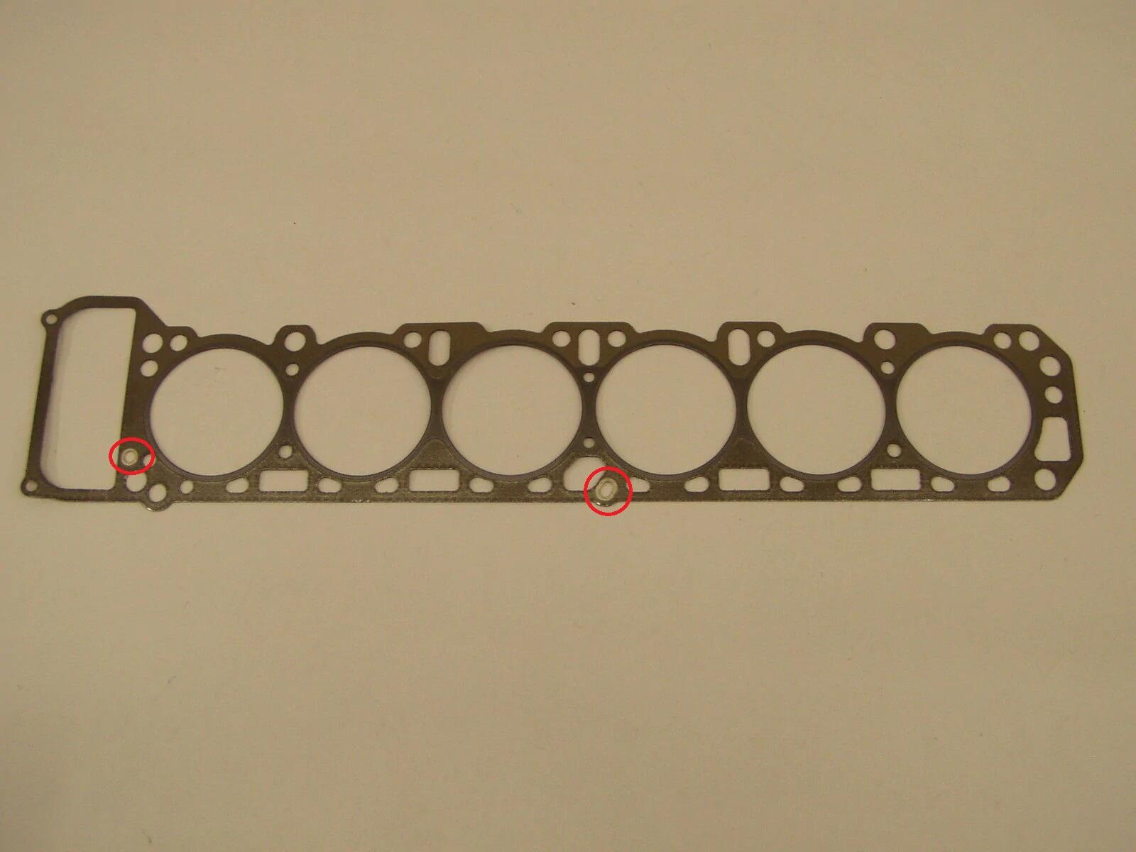

this is not the pic of mine but what it looked like
here are some pics of the foam, video of the run coming soon
Engine running on test stand, focused on rad issue.
