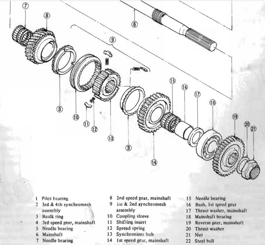

Or, maybe the needle bearings around 1 and 2.  1 and 2 also share the same coupling sleeve.  The guys that have rebuilt theirs would know more about that possibility.

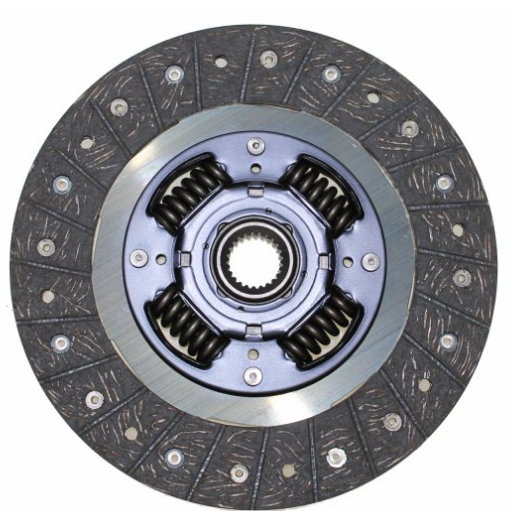

One part that might buzz is the spring(s) in the disc.  What did you buy?  Maybe it's some sort of weird resonance that only happens in 1st and 2nd.  Are you sure you can't make it happen in 3rd, 4th, or R?
Edit - also, the disc could be rattling on the main shaft as the pressure plate spins against it. That might give a spinny buzzy noise. Loose splines.

The problem didn’t start until after installing the new clutch disk so maybe I need to contact M-Pact (https://www.rockauto.com/en/moreinfo.php?pk=6084348&pt=10605&jsn=4) and ask if this problem could be related to a resonance matching the springs.

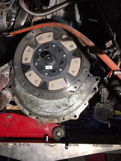

One last thought… Did I install the clutch disk backwards? Please look at the attached photo.
