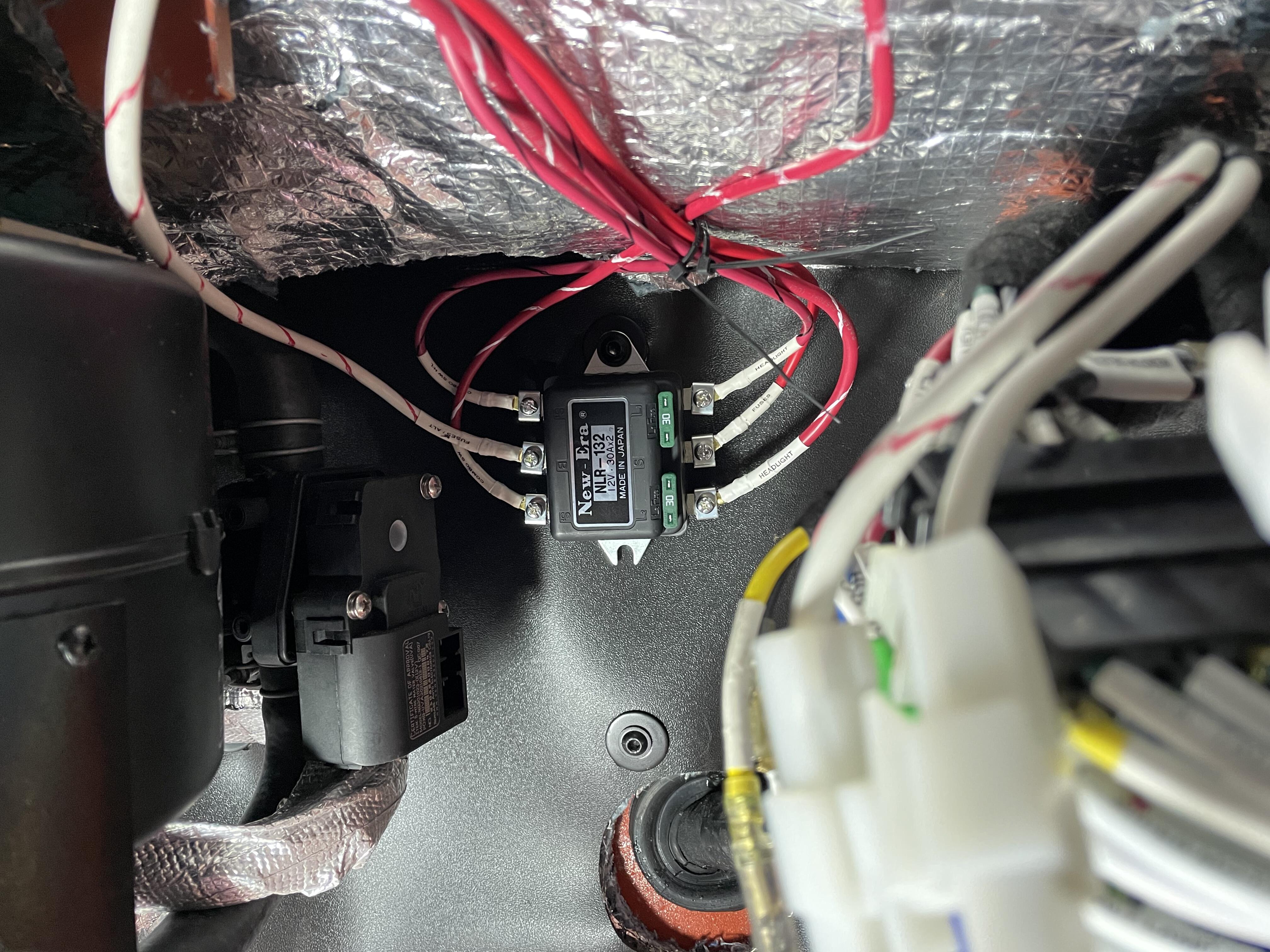

The headlight relay is all wired up.
Once I finished this I started testing. I got nothing when set to OFF (good), nothing when set to LOW (bad), and the relay clicked when set to HIGH (good).
I pulled out the meter and checked continuity on the relay with the wires on. s1 to B, s2 to B, s1 to s2 all connect as they should. S to L1, S to L2, and L1 to L2 all connect as they should.
My continuity from s1 and s2 to the two dash harness wires at the combo switch is good for both R/b and R/w.
But now I’m getting no continuity between any of the three wires coming out of the combo switch in ANY position (Off, Low, or High). That doesn’t make sense because High was tripping the relay before.

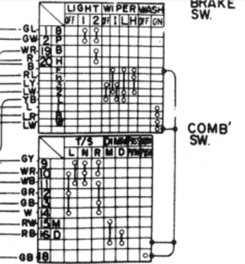

By the way, here's the truth table for the 73 combo switch:
So the red wire should have voltage to ground when the headlight switch is on.
Have you verified you are using a good ground point when measuring voltage?
I thought my grounds were solid but maybe not. I can’t work on it tonight but tomorrow I’ll go around and check. Im confident about everything in the engine bay. Inside the cabin might be less solid.
Well, apparently there was nothing wrong. User error? I just tested everything and the only relay not clicking is the intermittent relay.
I can hear the rear fuel pump running (that may need some sound proofing), the headlight relay is switching for both low and high beams. The horn relay is clicking, and the accessory relay is clicking.
I have another intermittent relay, so if I’m not getting any voltage at the wiper motor plug I’m going to swap them to see if that makes a difference.
I still need to check the two flashers, the choke/heater relay, and the buzzer, but I don’t have enough of the components assembled to do that yet. Otherwise it’s on to the next step of checking voltage at all of the light connectors. After that I’ll see if it starts from the key.

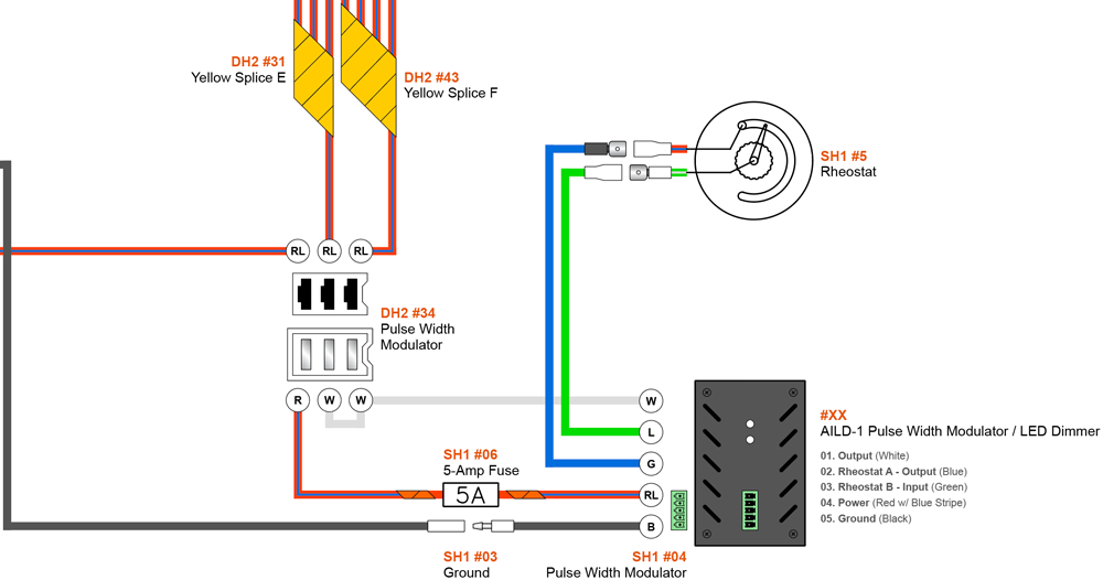

I did a quick sketch of the wiring for the AILD-1 PWM. I'm waiting for a fuse holder in the mail and then I'll make a sub-harness for it.
Edited by Matthew Abate
