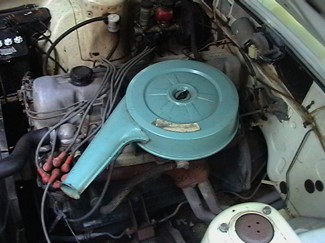

As an owner of a single carb "Skyline" I can tell you that that air filter case isn't from my car (see attached picture).
Now I'm not sure if they changed the design of the air filter at any stage during the C110's life, but I wouldn't have thought so. Like Alan said, it could be from a Gloria or a Cedric or something. In my opinion it wasn't from a C110 Skyline.
