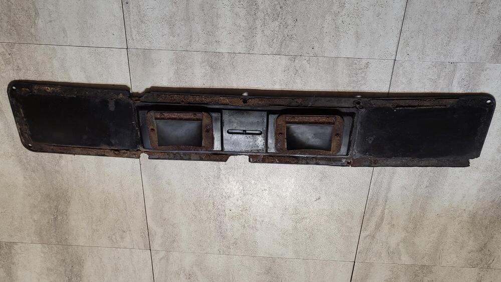

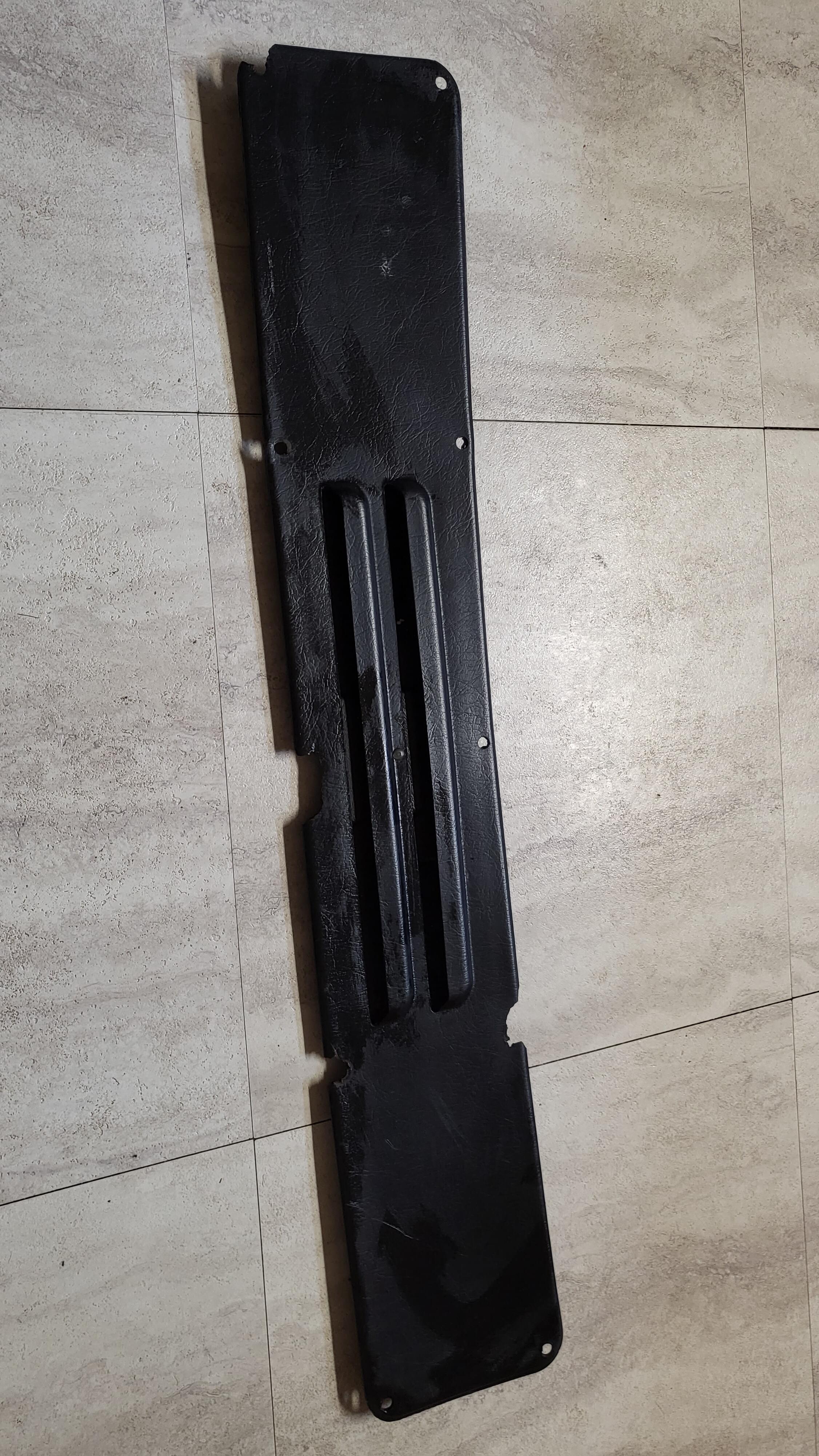

Posted May 4, 20223 yr comment_640016 Trying to refurb the interior plastics of a series 1 hatch interior. Thinking of super glue plus a layer of something really thin on the backside. Concerned that a thick repair will impact ability to attach. Would love to hear from someone who's been there and done that. Thanks. Link to comment https://www.classiczcars.com/forums/topic/67453-reconnect-broken-off-corners-interior-plastic-panels/ Share on other sites More sharing options...
May 4, 20223 yr comment_640017 I'm not following. what exactly are you trying to reattach? Link to comment https://www.classiczcars.com/forums/topic/67453-reconnect-broken-off-corners-interior-plastic-panels/#findComment-640017 Share on other sites More sharing options...
May 4, 20223 yr Author comment_640018 See the corners where the holes are and where the corner has been broken off? Those busted off corners are what I'm trying to reattach. Link to comment https://www.classiczcars.com/forums/topic/67453-reconnect-broken-off-corners-interior-plastic-panels/#findComment-640018 Share on other sites More sharing options...

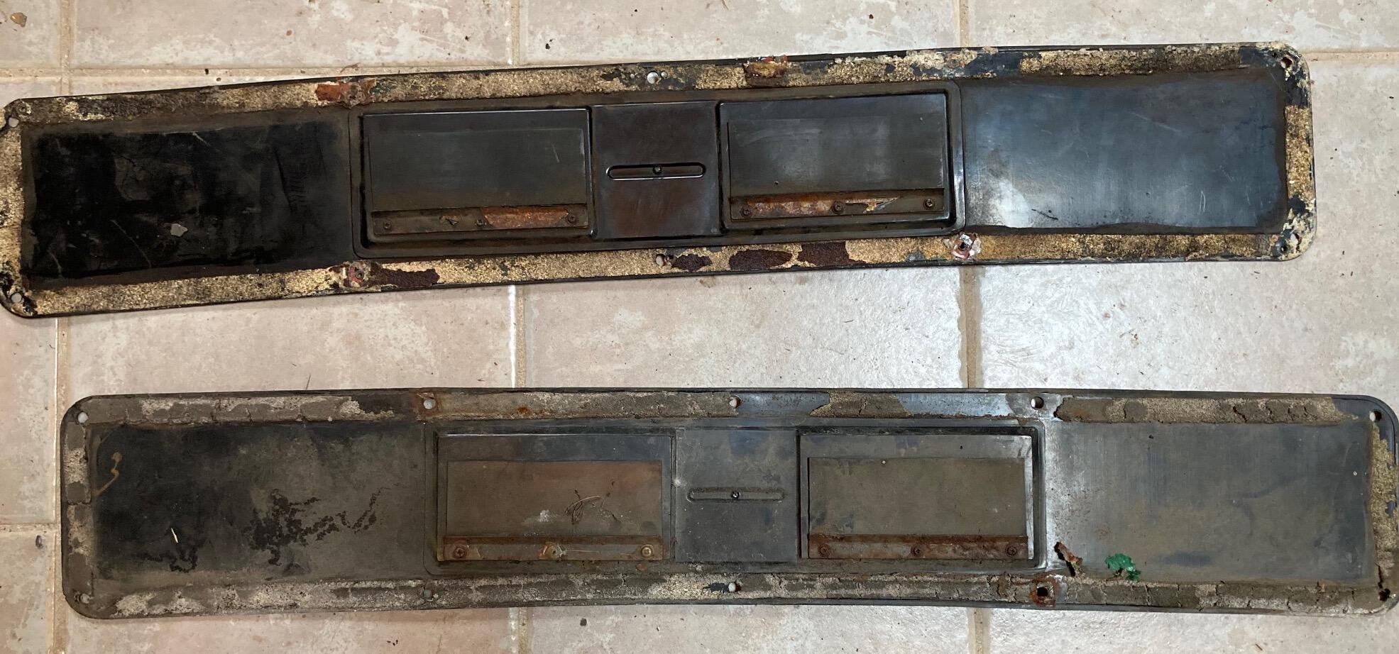

May 5, 20223 yr comment_640033 Ha-ha once again I am late to the party. If Jim^^ S30Driver does not have what you need I believe I have a better one than you show in the pic. Although I like the plastic weld idea, I might have to give that a try on some other plastics I have. Link to comment https://www.classiczcars.com/forums/topic/67453-reconnect-broken-off-corners-interior-plastic-panels/#findComment-640033 Share on other sites More sharing options...
May 5, 20223 yr comment_640048 Looks like the panel I have had a rough life ... Maybe Terrapin had a more serviceable one ... @Terrapin Z Link to comment https://www.classiczcars.com/forums/topic/67453-reconnect-broken-off-corners-interior-plastic-panels/#findComment-640048 Share on other sites More sharing options...
May 5, 20223 yr Author comment_640060 4 hours ago, S30Driver said: Looks like the panel I have had a rough life ... Maybe Terrapin had a more serviceable one ... @Terrapin Z Those 3 missing chunks around the edges would be a step backwards for me. Thanks for dragging it out for inspection! Link to comment https://www.classiczcars.com/forums/topic/67453-reconnect-broken-off-corners-interior-plastic-panels/#findComment-640060 Share on other sites More sharing options...

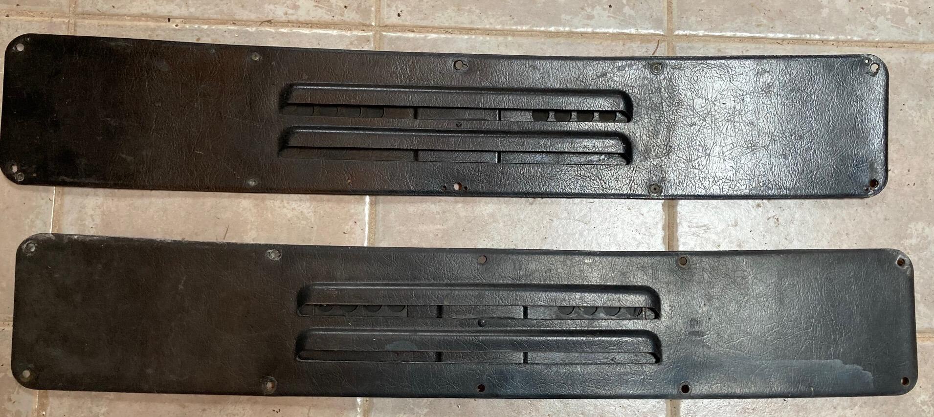

May 5, 20223 yr Author comment_640061 10 hours ago, Terrapin Z said: Ha-ha once again I am late to the party. If Jim^^ S30Driver does not have what you need I believe I have a better one than you show in the pic. Although I like the plastic weld idea, I might have to give that a try on some other plastics I have. Please show me what you've got available. Thanks! Link to comment https://www.classiczcars.com/forums/topic/67453-reconnect-broken-off-corners-interior-plastic-panels/#findComment-640061 Share on other sites More sharing options...
May 5, 20223 yr comment_640063 I have two, one has extra holes in the middle and corners, for PO's extra screw downs?? The other has a stain but is more intact. Both have crusty gaskets and some dirt/rust. the flaps look ok, but rusty screws. I don't usually clean stuff up, unless I am going to use it or put it up for sale. I have way to many parts to clean them all. I just bought another parts car last night. 5/72 Link to comment https://www.classiczcars.com/forums/topic/67453-reconnect-broken-off-corners-interior-plastic-panels/#findComment-640063 Share on other sites More sharing options...
