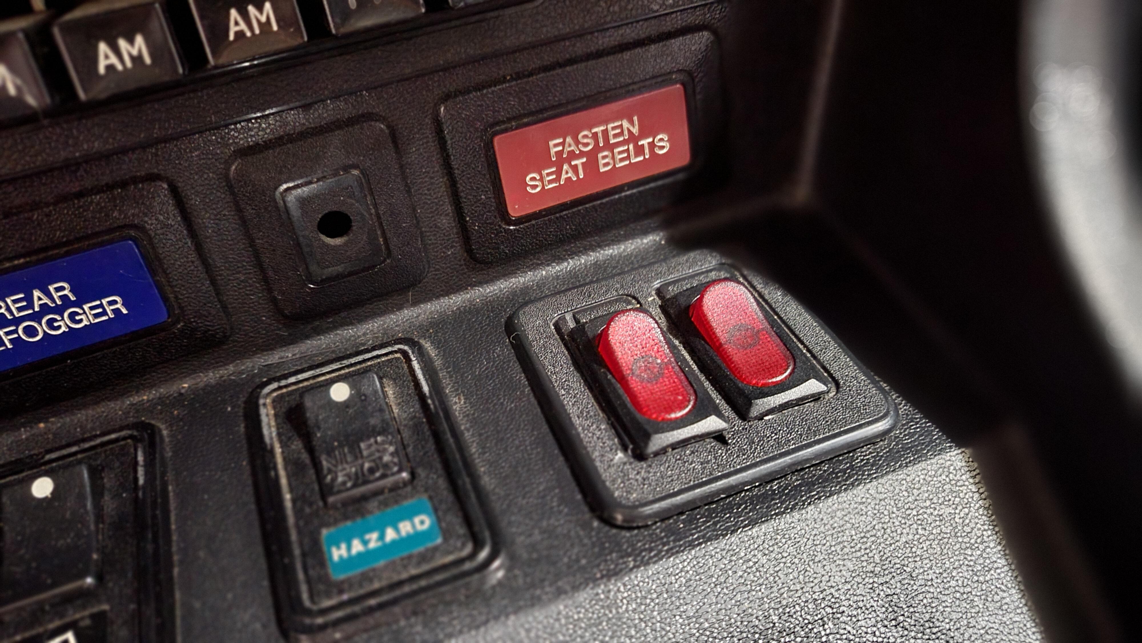

Posted May 2, 20222 yr comment_639913 does anybody know where to pick up a rocker switch for the console? I am looking to install the fog lights and would like to install the rocker switch in the spare location next to the hazard switch to control the fog lights. I am not sure if a regular rocker switch will fit?thanks Link to comment https://www.classiczcars.com/forums/topic/67449-rocker-switch-needed/ Share on other sites More sharing options...

May 2, 20222 yr comment_639926 If the 260 console has the same switch blank as the 280z, you can carefully cut out the knock out area, and install a rocker switch such as the ones I sourced from Orielly's for my fog & spots. I tried to get a amber switch for the fogs, but no luck. Here is one at NAPA https://www.napaonline.com/en/p/GRO821901?cid=paidsearch_shopping_dcoe_google&campaign=GSC-Catch-All&campaign_id=6478877959&adgroup_id=79272987338&adtype=pla&gclid=CjwKCAjwgr6TBhAGEiwA3aVuISU9xlR3zFptoGzFAx9hy0P08xM8zturaLAAMwC7XAh7ET0dJpvDYRoCG8wQAvD_BwE&gclsrc=aw.ds& Edited May 2, 20222 yr by S30Driver added link Link to comment https://www.classiczcars.com/forums/topic/67449-rocker-switch-needed/#findComment-639926 Share on other sites More sharing options...

May 2, 20222 yr comment_639928 I think Jim is right. I looked on Z Car Source to see what they had for switches. They do have a defroster switch, but it's obviously too small to fit in the hole on the right. I did look for Niles brand switches to help preserve the look. The search took me to ebay, where I saw this Nissan hazard switch: https://www.ebay.com/itm/115356499313?epid=20040619831&hash=item1adbc87d71:g:ovYAAOSw5BJiY1z6 On Amazon, I saw rocker switches like this: https://www.amazon.com/Position-Rocker-Toggle(Quality-Assurance-Years)KCD3-101/dp/B07MV56LKS The listing has lighted and non-lighted switches. Link to comment https://www.classiczcars.com/forums/topic/67449-rocker-switch-needed/#findComment-639928 Share on other sites More sharing options...

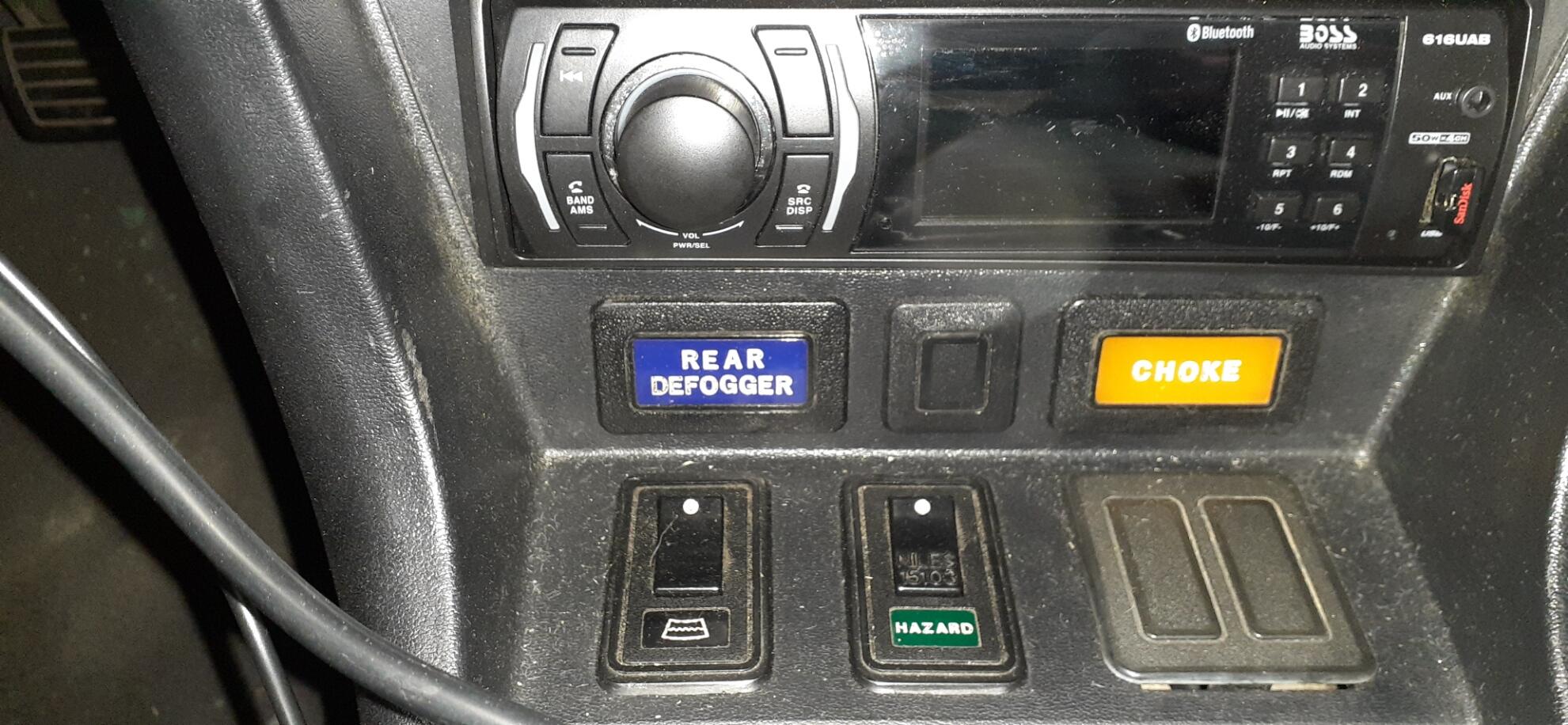

May 3, 20222 yr comment_639940 3 hours ago, kully 560 said: I found a 1974 260z rear defogger switch for sale but I am not sure and even the seller was not helpful if it will work for the fog lights. I do not know if it is just a switch or if it has maybe a built in resistor? The defogger switch is just a normal SPST switch, so that part of it is no problem. No resistors or anything else unusual. Just a switch. The only thing that would concern me is how much current can that defog switch deal with? I don't think I would want fog light current going directly through that switch. I'd want to use a relay between the switch and the lights. Link to comment https://www.classiczcars.com/forums/topic/67449-rocker-switch-needed/#findComment-639940 Share on other sites More sharing options...
May 3, 20222 yr Author comment_639946 thanks for the answer, it will be controlling a relay so there will be no load on the switch. I was also thinking the switch will fit the length and I will just have to cut the width on the blank plastic plate. it will be about as original as I can get. Link to comment https://www.classiczcars.com/forums/topic/67449-rocker-switch-needed/#findComment-639946 Share on other sites More sharing options...
May 3, 20222 yr comment_639951 Cool. If you're already just controlling a relay, then a 260/280 stock defog switch will work fine. As for where to put it.... I've been messing with the same thing in recent weeks and I've tried several different configurations. I recently made an adapter plate to put one of those switches in that rightmost larger hole. But the simplest thing would be to put it horizontal in one of the two positions right below the radio. If you've got a 260, then your right side is the "CHOKE" light, and the left side is your "REAR REFOGGER" location. Maybe you could live without a defogger iindicator lamp there and use that location for your fog light switch? You still need CHOKE, but maybe you could do without the DEFOG indicator. And when I get a chance I'll take some pics of some of the other stuff I've been messing with. One of my "and after a completely unprofitable amount of hours later, I have this" kind of things. Link to comment https://www.classiczcars.com/forums/topic/67449-rocker-switch-needed/#findComment-639951 Share on other sites More sharing options...
