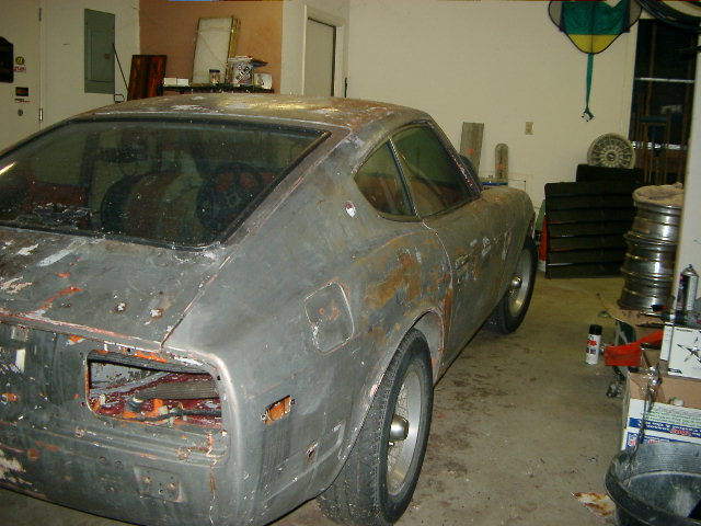

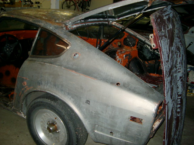

Not an entirely unselfish poll...look what I have been playing with in my garage this week..... NO! That is NOT a silver Z!
steve77
There was (from the top down):
Burgundy
grey primer
Burgundy (Yes, it had been painted the same colour twice)
grey primer
factory orange
factory primer
Oh, and did I mention practically the entire car was skimmed in Bondo? Some of it OVER the other paint jobs. Learned a couple things about these cars:
I alway thought there was only one leaded joint in the car. Didn't know the lower windshield area was leaded too.
Always wondered why the cowl rusted. Seemed like a weird place--out in the middle of nowhere--to rust. IT'S THOSE TWO PIECES OF FOAM GLUED TO THE UNDERSIDE!!! What a stupid idea! Is that for soundproofing? Total rust trap.
