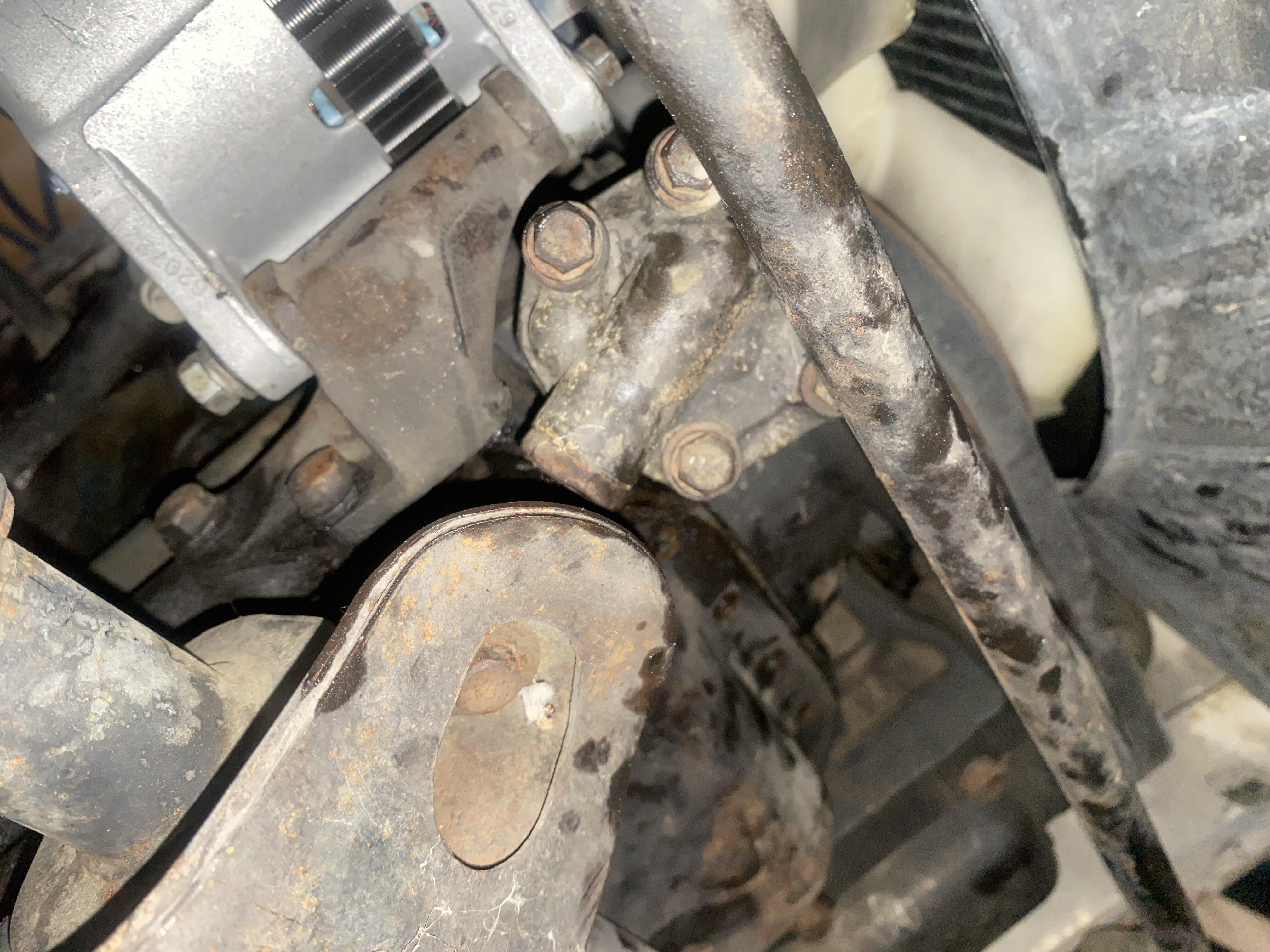

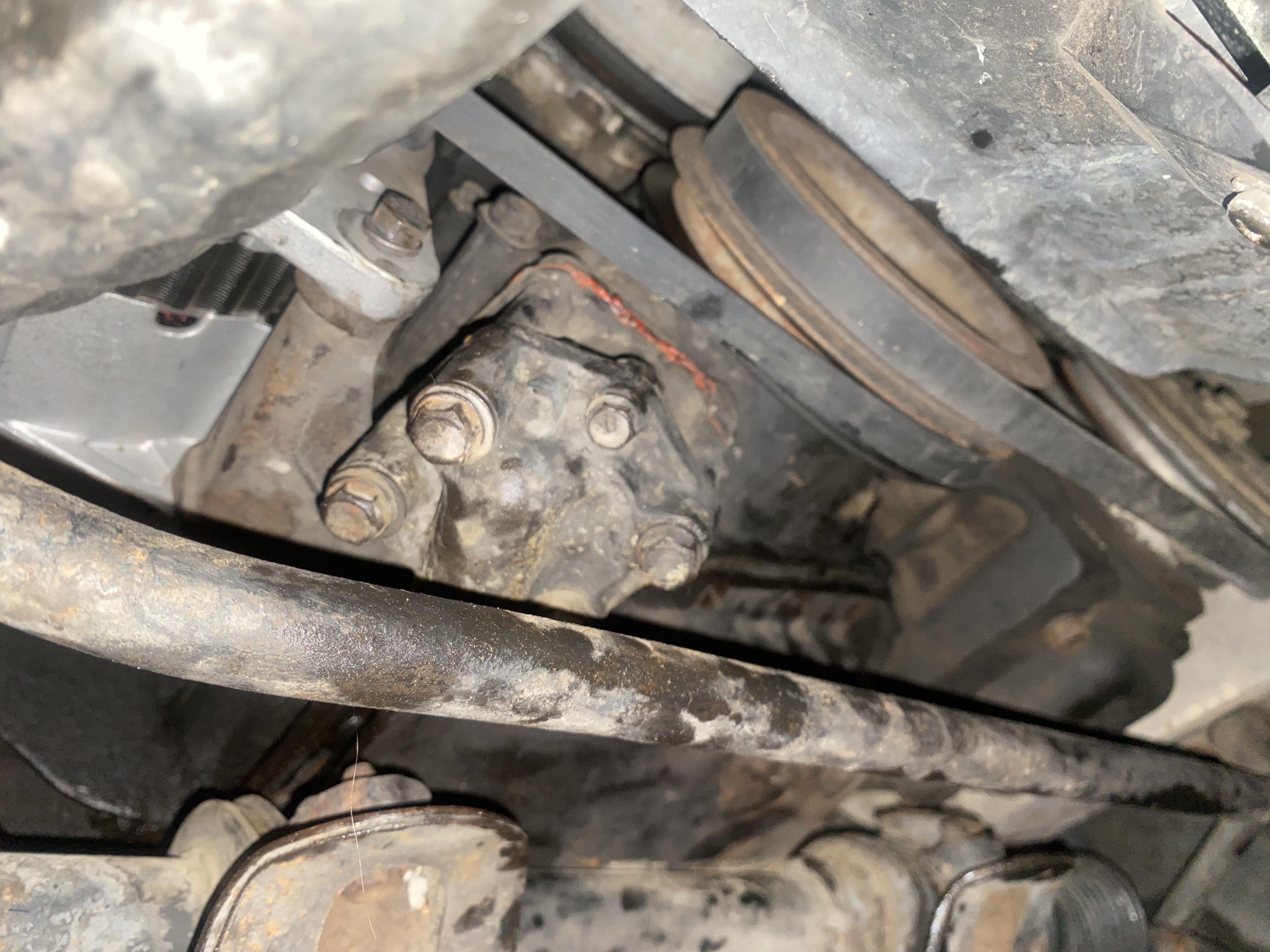

I’m trying to drop my oil pan and this is in the way I think. Is it a coolant drain? How would I go about taking it off? Thanks!BBC5B4F0-F0CC-4F06-AD3C-4CF0729821E0.jpeg29B4F0B0-E4E0-48CD-958C-2387E77D54C9.jpeg
That is the oil pump.

  4. Don't even think about removing the oil pump before you have the engine at TDC. (Otherwise, you'll probably mess up the timing on the engine, especially if the oil pump gets turned while it is out.)
On the other hand, why is the oil pump in the way? I'm pretty sure the cross member is more of an interference than the oil pump. By the way, from the amount of RTV on the oil pump, it looks like someone removed it in the past. I don't believe RTV is needed if you do it right.

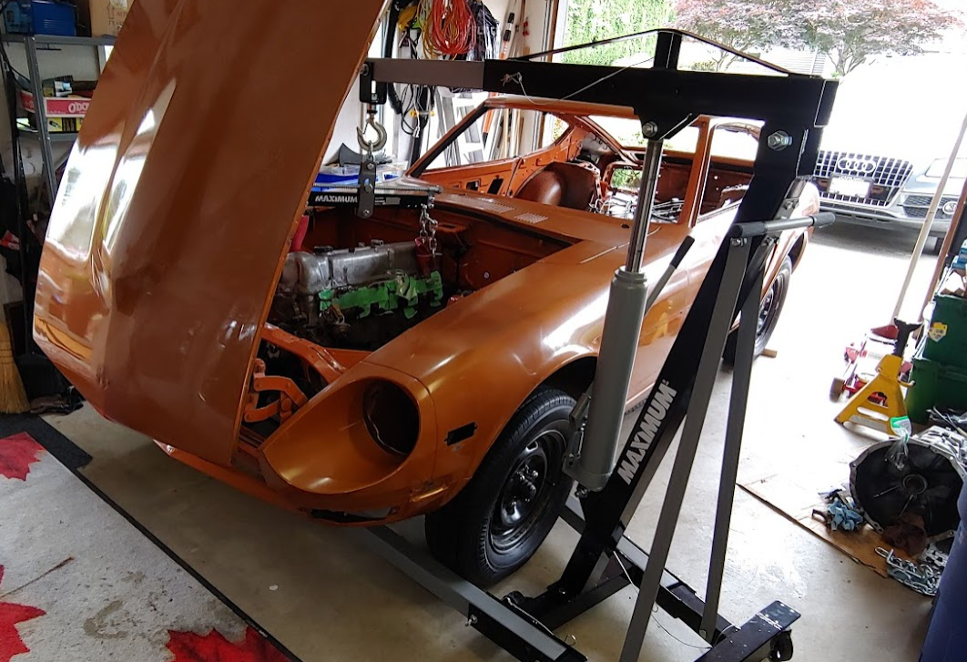

The biggest advantage of using a 2 ton, is the extra boom length, usually about a foot more. And at full extension the de-rated tonnage is double. For example my 2 ton has a 57" extended boom length and is still rated for a half ton lift. Also using a leveler is a must if you are pulling the engine and transmission together. Here is a picture of mine at full extension pulling engine only, it was useful having a leveler even for engine only removal.
