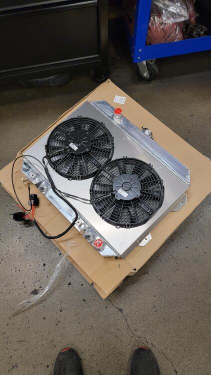

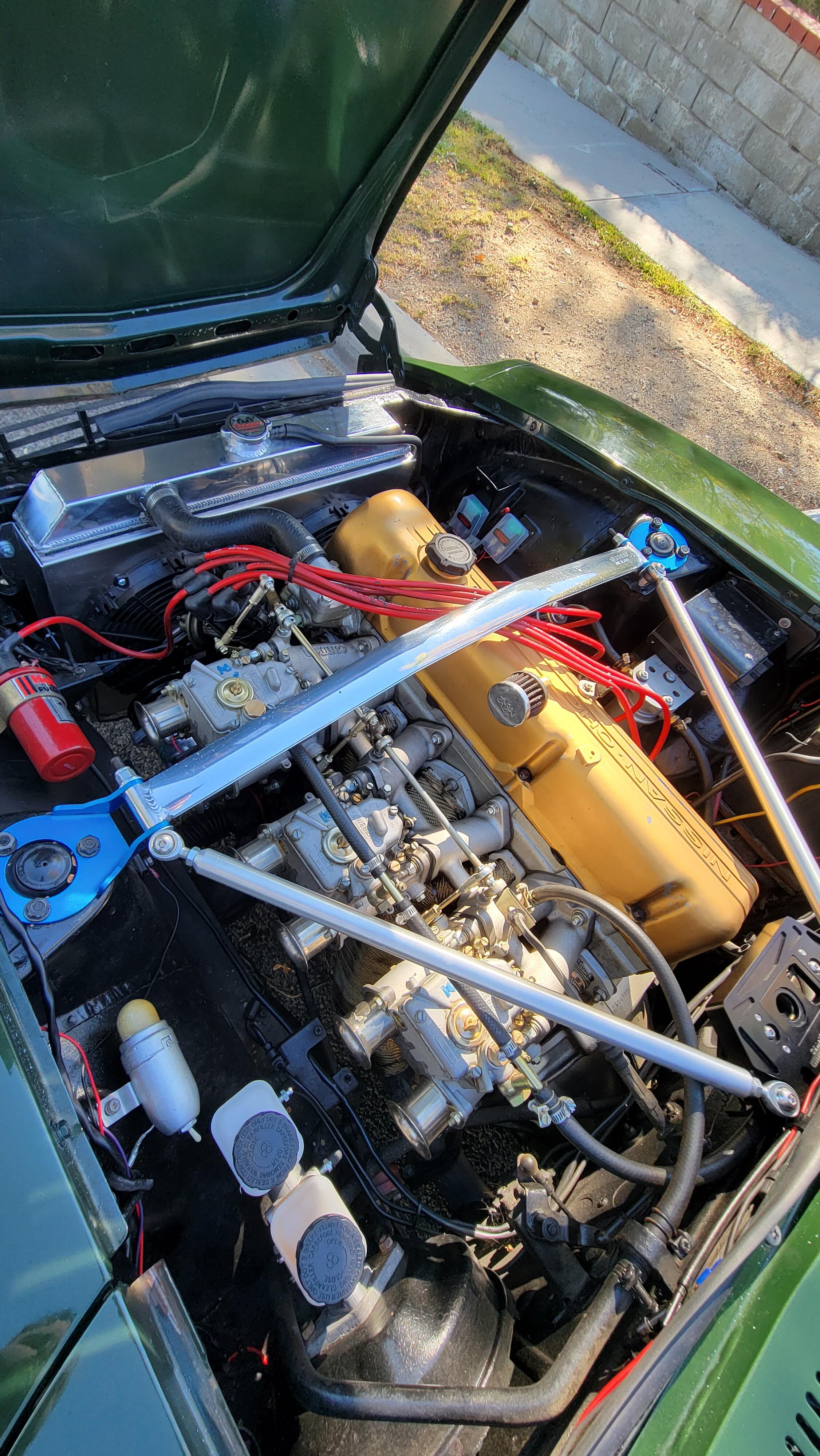

I have a 1978 Datsun 280z with a triple weber setup. I currently have installed a Champion Radiator with a dual Spal electric fan setup. As of right now the fans are wired up with relays and the fans turn on with the ignition. The car takes too long to warm up like this and surprisingly the car never goes above ~150-160 degrees F (Which I am not sure if that is too cold). I want to setup the fans to turn on with a thermostat switch that will turn the fans on at 180 degrees F. What would be the best way to install one?
I would like to use any of the unused threads on my Thermostat housing (Aside the one used for the temp gauge). If anyone can link one that will work with those threads would be great as I am not sure what size those threads are. Any other ideas are also greatly appreciated.

The radiator doesn't have a spot for a sensor, at least I don't see any. That was the goal to use the relays to activate with a sensor.
I knew the possible issues from going clutch to electric. I prefer electric, looks nicer but thats just me. Currently I only have one fan running because my car doesn't even get above 160 degrees F, had this setup for the last couple months, have not had any power/electrical issues yet. I do have an upgraded alternator.

I like the idea of using an unused port in the thermostat housing but finding the right device to mount there might be an issue. I believe the threading is BSPT but 1/2" NPT can be made to work

Without the fans yes it'll get above 180, have not tested if it'll overheat I turned the car off the second It got past 180 which means in my mind the fans are working too good because sometimes the temp doesn't even get to 160, before this setup even with a 160 thermostat the car would run too hot which is why I replaced the radiator and fans (I had another aluminum radiator and smaller electric fan before this). The rad came with a shroud so yes. The main thing is getting the fans to turn on when the coolant gets to a certain temp so my car can warm up faster on cold starts. They sell sensors for that, the problem is installing it since it'll be aftermarket, I wanted to use the thermostat housing but not sure what the thread sizes are for the 3 front ports I'm not using or the 1 port on the side.

Yes I prefer the look of the electric fan setup looks cleaner and more impressive imo. My car takes way too long to warm up even if I drive off. I have not seen anything on the radiator that would allow me to hook one up. I did look on summit racing. The main thing was just knowing what the threads were for the thermostat housing, I don't exactly wanna drill and rethread the thermostat housing either
