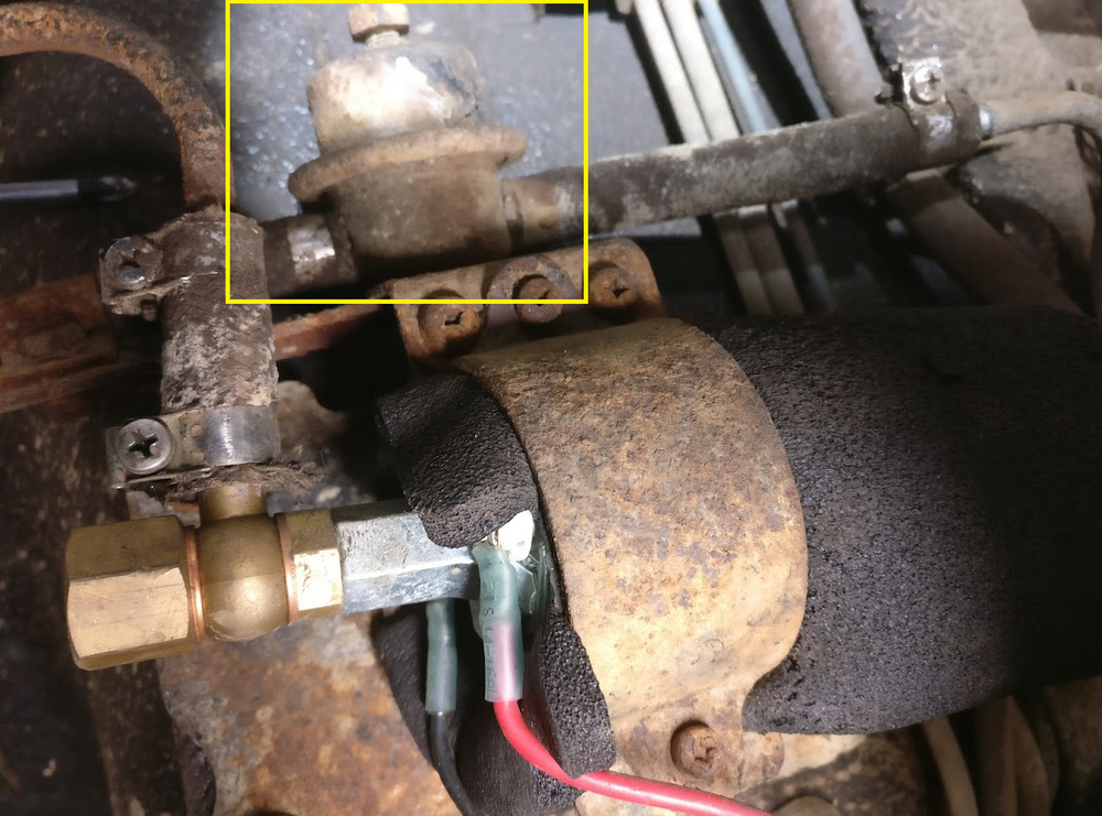

77 280z. Apologies for the crusty picture. Is the circled object at the top of the screen a damper or a regulator? And if its a damper, is it adjustable?
Struggling with fuel pressure. I have an in-line gauge installed after the fuel filter. When the car is running, fuel is only at ~25PSI (compared to 34-36PSI expected). I took apart this whole section to remove some of the rust and replace the hoses, but I can't remember if I messed with the bolt on the top of the damper (and if it matters).

you should read the FSM fuel section. It explains how the entire fuel injection system works, including the fuel pressure. You should get a vacuum gage to confirm the fuel pressure reading with the engine running. most see about 29-30 psi at idle, you may have more vacuum than typical (16-20 inHg), or you may have a fuel delivery problem 36-38 is more normal engine off pump on.
Thanks Dave! Good to know this is closer to expected pressure. And apologies for the laziness in not reviewing my copy of the FSM. In Chicago, antique license plates only allow you to drive through 10/31 so I was outsourcing the research to you guys to maximize my remaining days of drive time when I am out of work today 😛

I have not seen any controversy over aftermarket pumps on an EFI car, except for people who use a very high volume pump like the Walbro 255.  It's noisy because it's way too much fuel for the system.   Otherwise, they are common, there are many good brands.  The factory pumps are super expensive if a person can even find one.  Not sure how controversy got involved here.
The simple test for the pump is to remove the small wire from the starter solenoid and turn the key to Start.  The pump will run, but the engine won't turn so you'll see the base no-vacuum pressure.  As Dave WM said - it should be around 36.3 psi.  (The FSM says 36.3 psi, which is 2.5 bar).
Thanks Zed. I will give than I try tonight. I am expecting there is a confluence of factors at play here since I think there is also a slow leak somewhere in the system. I did a compression test last night. At the start of the test after sitting idle for about a week or two, the inline gauge was reading at 10PSI but jumped back up to ~35PSI at the conclusion of the test. Just checked in a few minutes ago and its back down to 25psi again.
