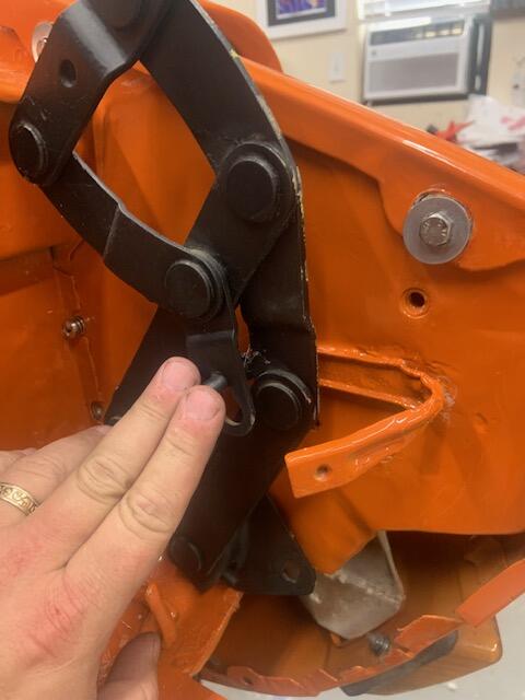

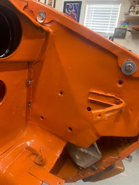

OK not sure what the black spring thing is really called. Anyway, can someone help me understand where it bolts up exactly and how. If anyone has an image that would be appreciated.
I took lots of photos when i disassembled but i must have missed a couple like this one.
thanks

12 minutes ago, SteveJ said:
That is called a hinge. I can take some photos later today.

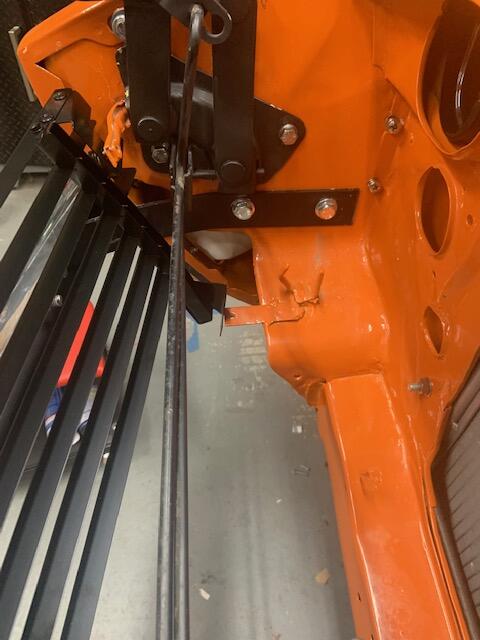

video a big help. got bumper and mounts on. Got the hood hinge/bracket on.

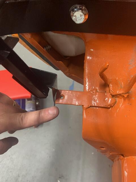

The grille is on. I have the top side bolts on and the bottom middle. However, for the bottom left and right, i am not seeing
what you are seeing. Am i missing something?
Your mount tabs are bent straight out. They need to be at a 90 degree to line up with the hole in the grill. Should be easy enough, but the paint might chip.
