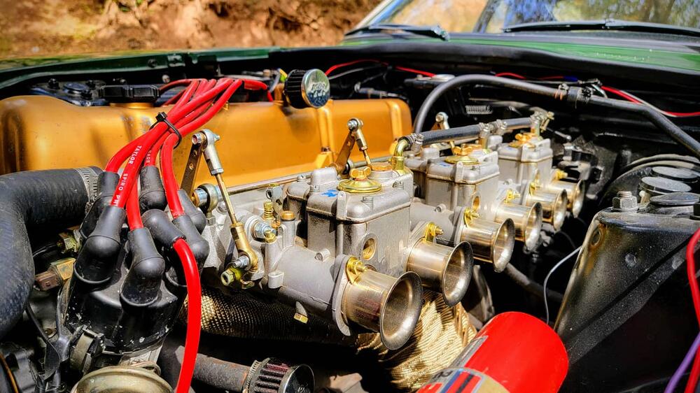

No damage done, the k&n breather I had for the crank case blew off but that's about it, drove the car an hour home after the incident. I have breathers/filters on the valve cover and pcv, I'm pretty sure oil was coming out of them when I was doing hard cornering so I'll have to get an oil catch can. You can see what I mean in the picture.IMG_20210525_121728_956.jpg
Question do you know if I can run one catch can for both of would two separate catch cans be better?
oooooo very shiny. I think you can run just 1 catch can, and have a splitter that joins right before they input into the can. Something like
I've been wanting to run a catch can too, my beef is I don't like how they fit in the engine bay, i kinda want it tucked...
Do you feel you chassis flexing in turns on the track? I notice you're not running any bracing.
2 hours ago, SteveJ said:
You can run 1 catch can for both. It shouldn't be spitting out too much oil. If it is, check your compression.
Sweet, thank you for the input. And compression was fine, I did a test about 3 months ago I remember all cylinders were around 140-160 which I know is low for a Z but shouldn't be extremely bad imo.
Sweet thanks, I'll be ordering one later today then. Personally I like my engine bay to be clean, but if it means avoiding a fire I'll do it. And I actually just ordered TTT bracing, I honestly don't know if my chassis has a lot of flex or not but I definitely have a good amount of body roll
