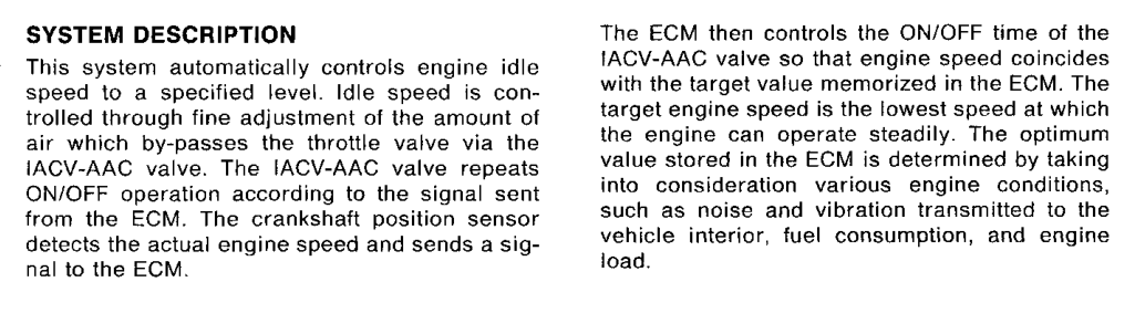

I have the Nissan 91-94 240SX FSM if you want to use.  I'd have to upload it.  Got it from ??? before Nissan shut them down.  Describes the basics of the ECM timing control.  Might be your IACV.
